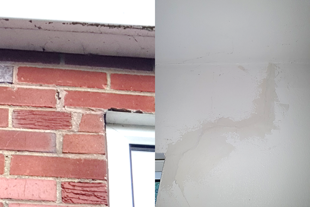

Stepped crack to LH of lintel, again seems like related to thermal movement of the bricks and the close proximity of the bearing to the corner.
Crack below frame, again a typical place for cracking from thermal movement of the wall.
Crack to pier - the wall is not bonded in.
Blown bricks - frost attack to bricks and staining look like they relate to localized saturation of the wall - drips from the roof or a cavity tray or blocked cavity.
Generally, internal cracking is common with age and not a big issue. It's only if you have cracks in the same place on the inner and external wall, and they are of the type that indicate foundation movement, but those do not.
The surveyor should have commented on the external cracks, so you may want him to clarify those, and then you should be able to rely on the report.
But as a sale report, you could be asking for a reduction in the price to cover the making good if you wanted to get into some negotiation.

Having spoken to the surveying company I'm now more confused than ever. I couldn't contact the actual surveyor but raised some concerns I had with the survey with the company owner (also a surveyor). After looking at the photos he has now stated that the property is subject to movement (moderate to severe) with a recommendation to get monitoring by a structural engineer in the medium to long term, a drain survey, remove any bushes and install retaining walls to prevent heave. I know from reading around that this is fairly generic advice so entirely unhelpful (I wouldn't have minded the same conclusion delivered with confidence from the actual surveyor and appreciate they are not structural engineers, but they've been a nightmare).
We did manage to examine the interior prior to the conversation with the surveyor and have an image of what I think is a more worrying crack that seems to affect both the interior and exterior walls:
I think this is probably the point where I bow out from this purchase but would nevertheless be interested in opinion on the crack.
