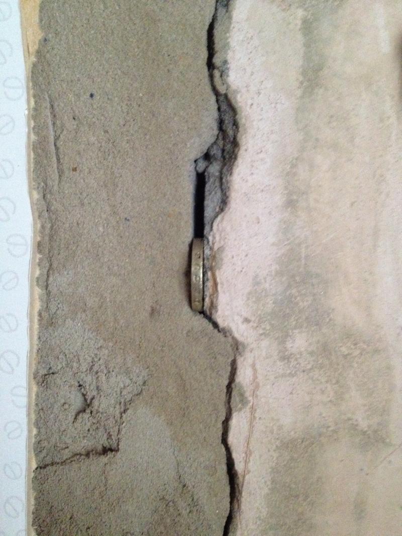

can someone please tell me whether this crack is serious? we bought this 4 bed room semi a few months ago. originally, it was a 3 bedroom semi, the previous owner (before the vendor we bought from) added a kitchen extension and a double bedroom above garage. I firstly spotted a crack in the kitchen wall (I think it is the joint between the main house and kitchen extension). A structural engineering said it is nothing to worry about, a plaster facial repair will be enough. later on, I noticed the crack in the same area but below the cupboard, which seems the same crack from the top but hidden by the cupboard. In order to have a better view, I cut the back cover open to expose the crack in the below picture. the crack seems extended below the kitchen work top around 10-15cm.
the engineering only looked at the top crack above the kitchen cupboard. as he and i both haven't spotted crack below the cupboard and behind too.
When he checked the top crack till the top edge of the cupboard, he said it is nothing to be worried.

It's one crack and the engineer would know that it would go down to the floor. It is common

Maybe just normal shrinkage of the extension away from the house, particularly if it has an inner skin of lightweight block.

the structural engineer gave the repair instruction - 1.0m long 4.0m diameter helibars bye helifix at 225mm vertical centres
