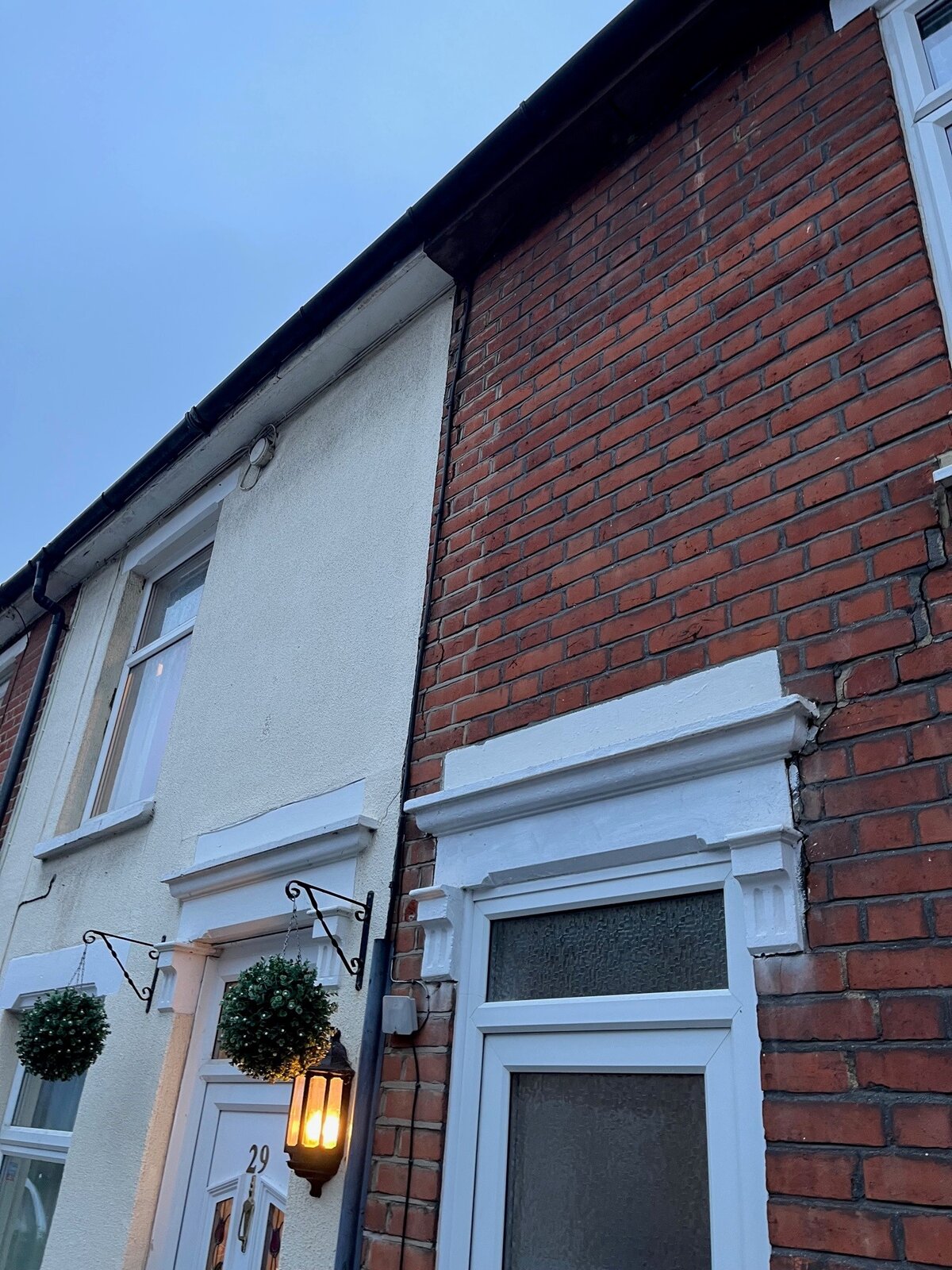

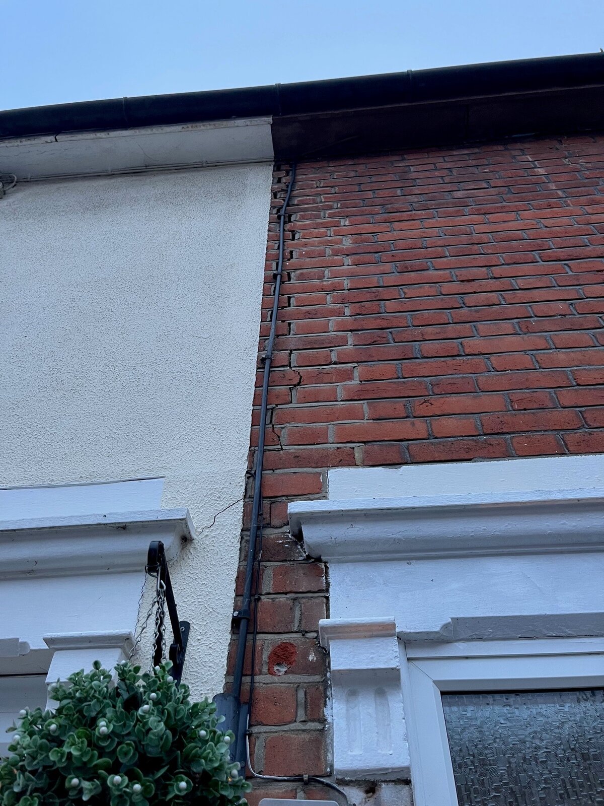

I am looking at a Victorian end terrace, there is however a vertical crack down the left hand side. It does look like there has been some dodgy repointing, with cement instead of lime mortar too, not sure if this could be the cause or merely making a symptom of a problem worse. It doesn't look fresh. Does look like there was another crack between the top right hand side of the door and the window which may indicate subsidence.
All of the other terraces have no visible cracks, rooflines look fine etc.
There are no internal cracks/no dampness and the gable end of the terrace as well as the back of the house is fine.
Can anyone offer any advice?

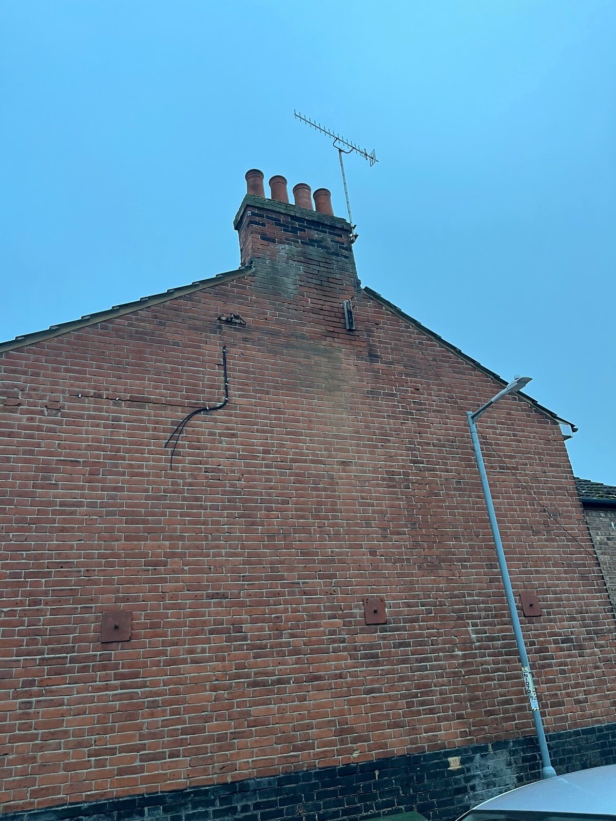

Here is the gable end too - no issues on there or on the back wall of the property

What you show on the front elevation is an historic crack & attempts at remedial pointing.
The remedial pointing is loose & failing, and gaps have appeared in the beds & perps.
You have another crack on the RH side of your doorway headwork.
Between the doorways, a brick has been spelched out and a mortar blob can be seen?
Your neighbour has a crack on the RH side of their doorway headwork.
Render is sometimes applied to cover cracks or damage?
Your gable photo shows three Lateral Restraint Tie Bar plates - the presence of Remedial tie bars suggests that historic movement has taken place in the property.
Do the ties end in your property or do the ties extend through the party wall?
Have any walls been removed inside the property?
Your gable photo also shows a chimney stack in need of Remedial work (the stack has been previously partly re-built) chemicals from dirty flues have leached out to present on the upper gable - have the interior chimney breasts been retained all the way up to the stack?

To me, that looks like quite a serious crack, and I'd be suspicious if no internal cracking is visible. I also don't subscribe to this being a 'historical' crack that has settled down. It has clearly been repaired previously and has now opened again.

In regards to the lateral tie bars, unfortunately I do not know if they extend into the party wall or not at this moment, I need to find out. I was under the understanding that alot of Victorian terraces usually have lateral tie bars and that it often makes them more structurally sound than a modern house?

Tie bars are remedial measures, & afaik they were never used except as remedial measures.
Chimney breasts esp. on a gable are important structural features.

The crack appears wider a the top than at the bottom. This, combined with the diagonal crack just at the edge of the photo, suggests there is rotation away from the row of terraces.
Combined with the pattress plates on the end wall, I would suggest that the end wall and chimney stack have sunk a bit.
Unfortunately, the only way to know whether this property is not going to be a heap of problems is to install crack monitoring for at least 6 months, ideally 12 months. If this monitoring shows movement has stopped, then you could crack stitch. (Crack stitching when movement is carrying on will just result in more cracking somewhere else - possible in the neighbours house! Bad bad bad.)
If the monitoring shows that the movement is continuing in the direction of the end wall, then you'd need to look at grouting or traditional underpinning to secure the end wall.
I don't think I'd be willing to buy. At a minimum get a structural engineer's report but - if my diagnosis is correct (albeit from three photos online), they'd say something similar to me.
