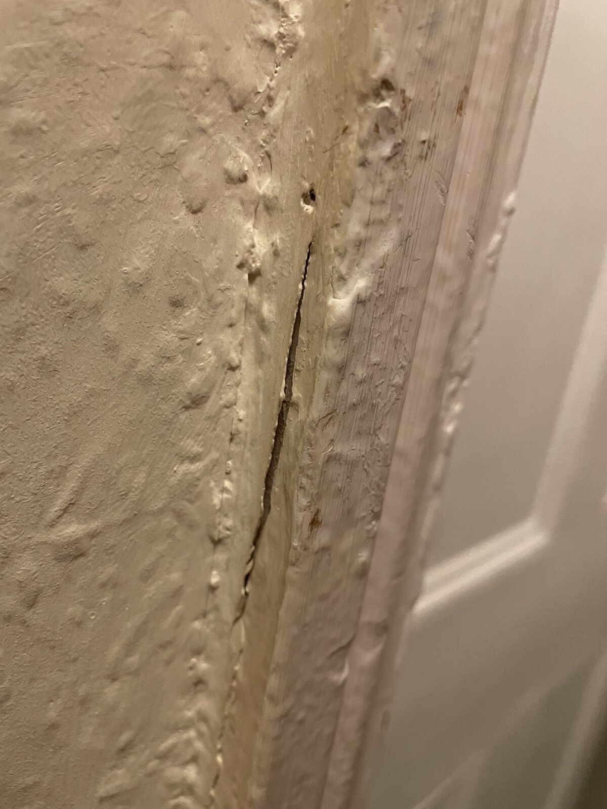

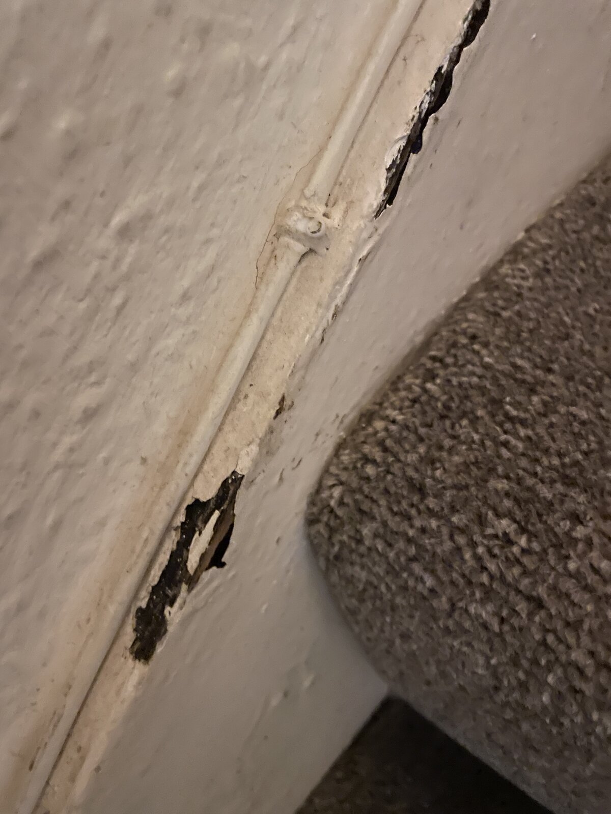

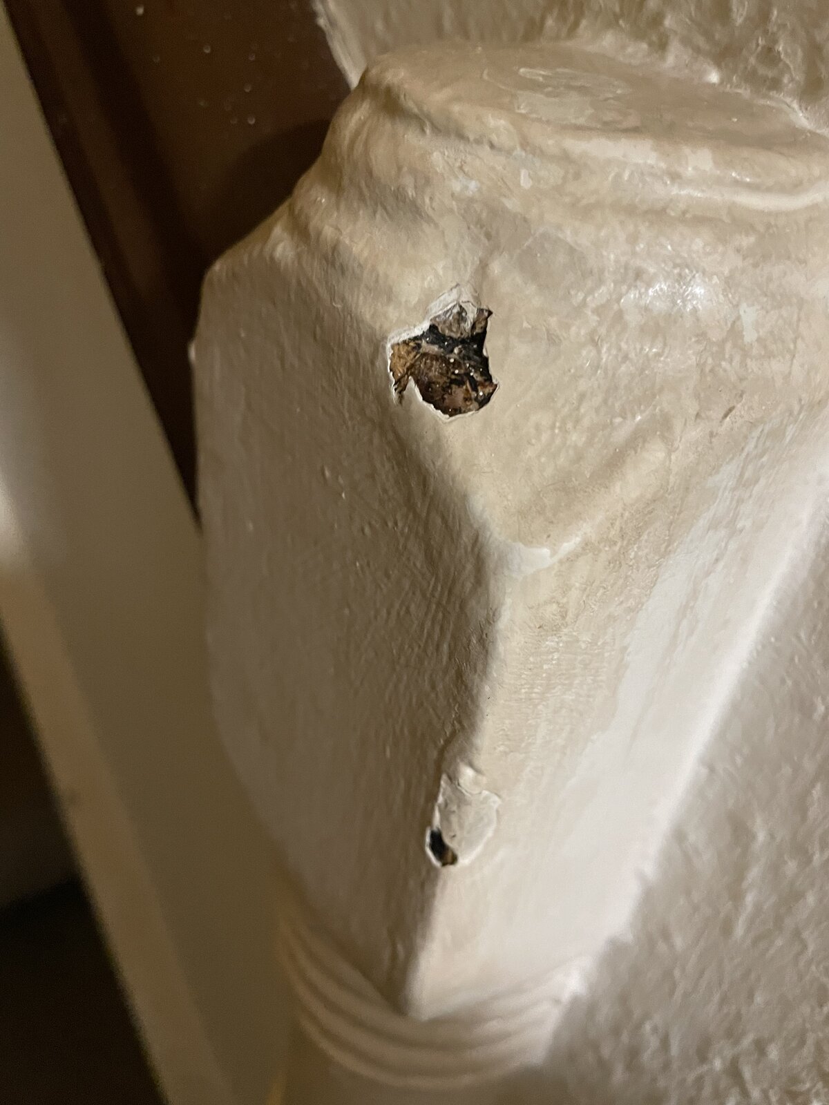

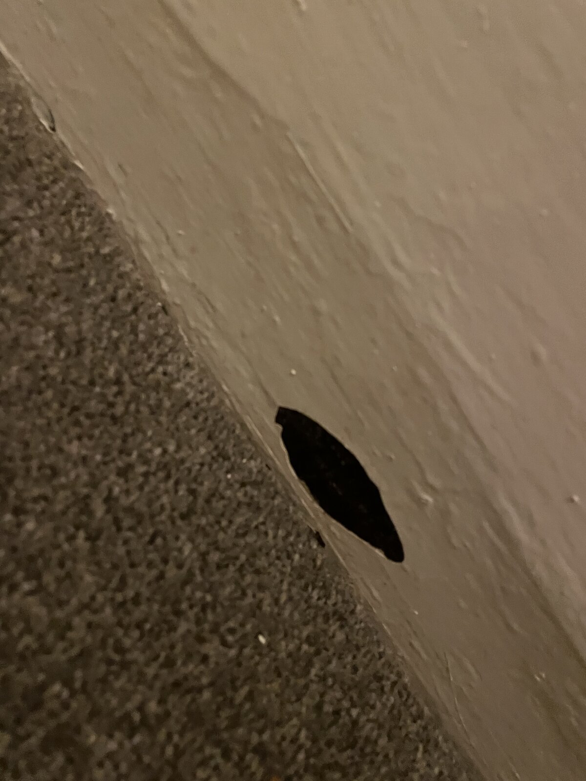

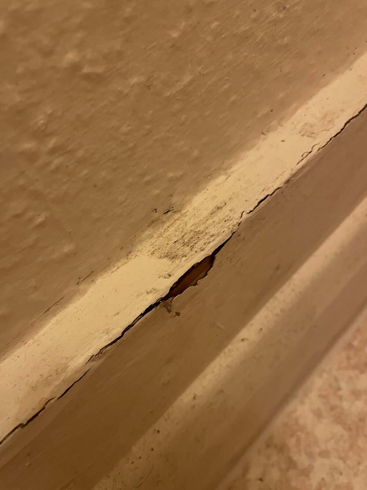

Thank you! Unfortunately not likely our landlord would let us replace the wood - would us just painting over the wood help, even though it’s in bad condition? Thank you
Need picture.
Maybe peelstop or coverstain to prepare.
Thank you - here’s a few photos of some of the cracks
Scrape off loose.
Undercoat
Mix up some toupret powder real thick. Fill and shape. Sand with 120 grade.
Undercoat and paint.
I'd not make a big job of that as Its too rough and knocked about.
Think Id use bradite one can or zinsser all coat paint.
Original coat of paint has ome away.
Decorators caulk is handy for gaps and cracks - and once you have smoothed it out with a wet finger, you don't need to (or more accurately, can't) sand where you've filled.
I would like to think the existing coat of paint wouldn't be old enough to contain lead... And that any lead paint would be below that.
But what do I know?
But what do I know?
The paint work is so rough that smearing in caulk is probably the path of least of resistance. Granted it will shrink back but it will look better than seeing the old "varnish" on the woodwork.
