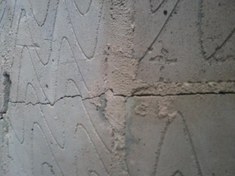

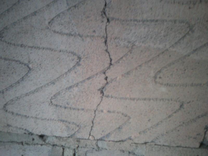

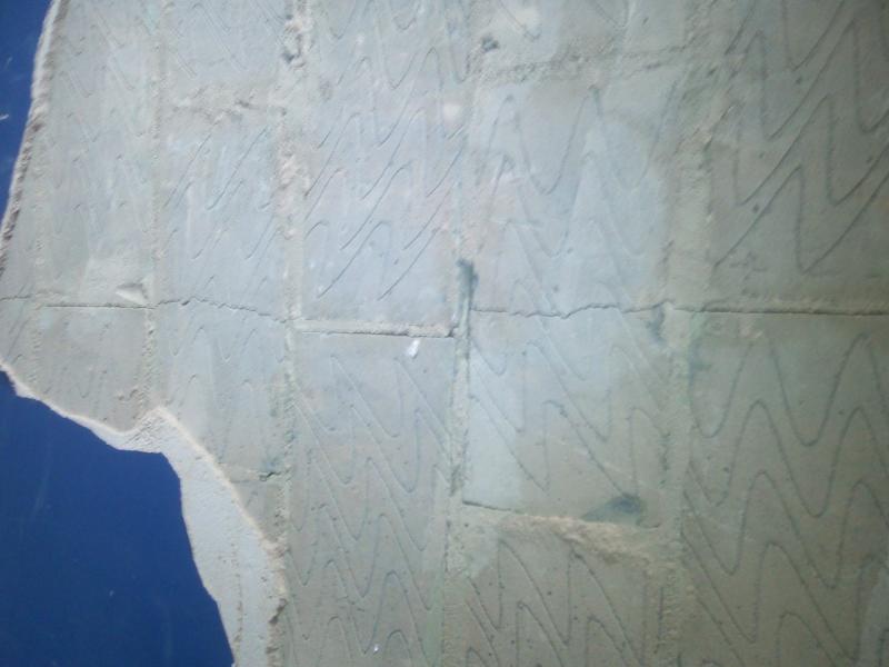

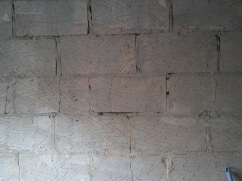

here are some pics, they are all vertical cracks though.
Pic 1 is the longest crack on the wall
pic 2 close up of crack 1
pic 3 another crack...
pic 4 patchy bonding, only this small area.
cracks on pic 1/3 are the worst on the wall, all the others are a lot less 'thick'

oh blockwork as opposed to brickwork! less scary then.
i'd still want to know why this has happened, maybe richardc can give us some clues as to its cause? please.
repairing should be no more than re-ponting the bad area of mortar then plastering unless there is something in the cause that needs addressing?
This to me looks like bad footings, if the wall has cracked like that (inside and out) then it has moved. It may be weak mix of concrete in the footings or the footings were not deep enough when extension was built. Also looks like a "suspect" mix on the block-work.. May be worth getting a structral engineer to have a look at it. Have you got a "Habitation Certificate" that would have been issued by the building inspector when the extention was finished? Thats if it went thru the right building application's.....I may be a bit over the top with my opinion but better to be safe eh?

You don’t say when the property was built; during the 60’s & 70’s building booms, there were even more dodgy builders around than there are now! Building Regs. as we know them had only just been introduced & I suspect enforcement was far more lax than it is now; with some of the pointless, PITA regulations we now have to comply with I sometimes wonder if that may have been a good thing! Dodgy materials & mixes + the depth of many footings would be considered marginal by today’s standards so older properties tend to move around more but it doesn’t mean they are going to fall down. Cracking in the external render is one thing but if you have any corresponding cracks in the external brickwork then it would be wise to investigate further & get a professional opinion; I would consider this more significant than cracks on just the internal blocks which are very brittle.
Apart from the odd extension, practically all of the work I do is renovations of one sort or another. As I said earlier, a lot of this work involves repairs to cracked internal block work very similar to those in your picture which are usually (but not always) vertical. I find they are very common & yours look minor in comparison to some I find. I’m confident either of the solutions I’ve suggested above will work & in most cases will provide permanent repair but you need the steel lath reinforcing to bind it together or it will definitely crack again; at the end of the day, it’s your call! ;)
