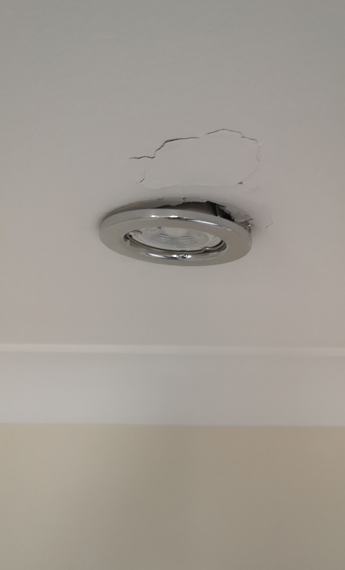

We have a loft ladder that unfortunately sits over the top of a recessed GU10 spotlight, so when we had our insulation topped up, the combined weight/pressure pushed down on the top of the light fitting so that it protruded slightly from the ceiling.
I'm not sure the light was fitted particularly well in the first place, looking at how rough/uneven the hole is and how little grip the light has to keep it in position. It also seemed a fire hazard, with a hot halogen bulb with (already discoloured) insulation right over the top, although we tend not to keep the light on for long. It is now an LED lamp so much cooler, and with a jar over the top for protection (because I was short of suitable plant pots!), but that just adds to the weight above it.
Anyway, not only is the light fitting prone to being pushed out each time we put the ladder back, but there is now also a circular(ish) patch of plaster alongside that has cracked and looks a bit of a mess. It has been annoying me for long enough, and now we're probably moving before long so have an extra incentive to get it sorted. However given our outgoings already stacking up I'm reluctant to call in a plasterer if there's something I could do to tidy it up myself.
So, any DIY tips to resolve both issues (photo attached), or do we just have to call in the experts?
T.I.A.

I very much doubt it, but is that the only downlight?
If it were, I would cover the whole area with a lamp like:
https://www.tlc-direct.co.uk/Main_I...ownlights_Index/Circular_LED_Panel/index.html
A jar maybe better than no protection, but a proper downlight protector would be preferable!
And something to support the loft ladder in its stowed position would help.
The patch of damage next to the downlight looks like an area of skim plaster has been knocked off the plasterboard.
This may happen if an impact has struck the plasterboard from above. This could knock a couple of the plasterboard screws out of the rafters; when the board rebounds, these protruding screws will knock off the patch of skim.
So to fix, remove that patch of skim, tighten up the screw underneath (if that is the cause!), Put some scrim tape over the screw heads and fill the patch with filler.
This might be a bit of a bodge, but should work! :)
I hope that makes sense.

...and I couldn't possibly suggest a proper bodge, but 'No more nails' would hold the downlighter in perfectly (just support the lamp until it dries) and possibly even glue the patch of plaster back on with minimal filling!
Only a thought ;)
