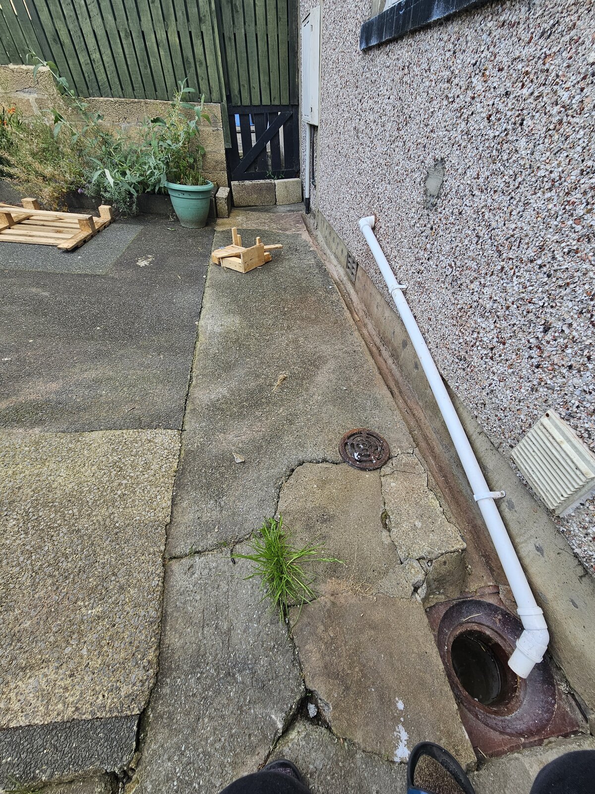

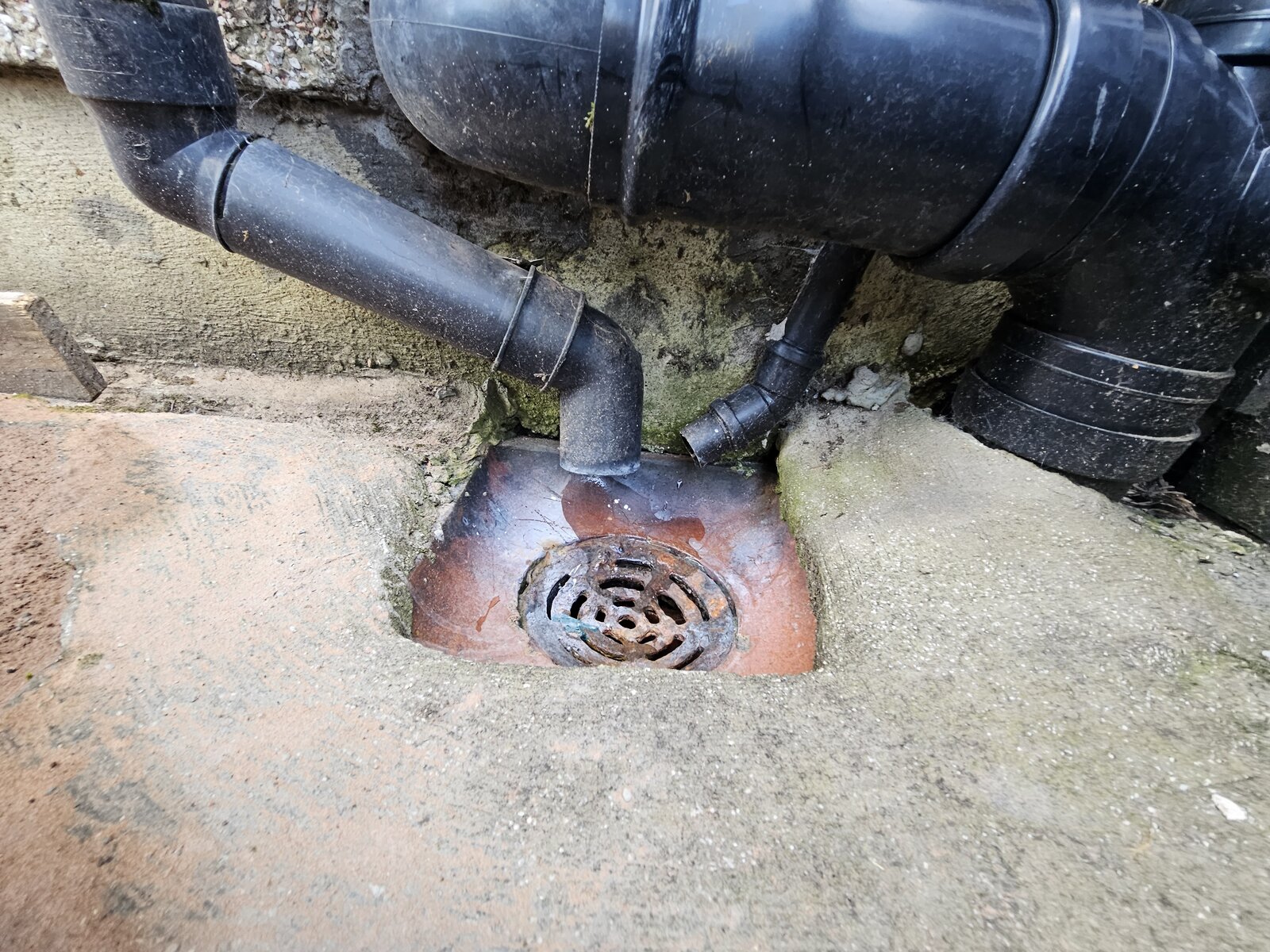

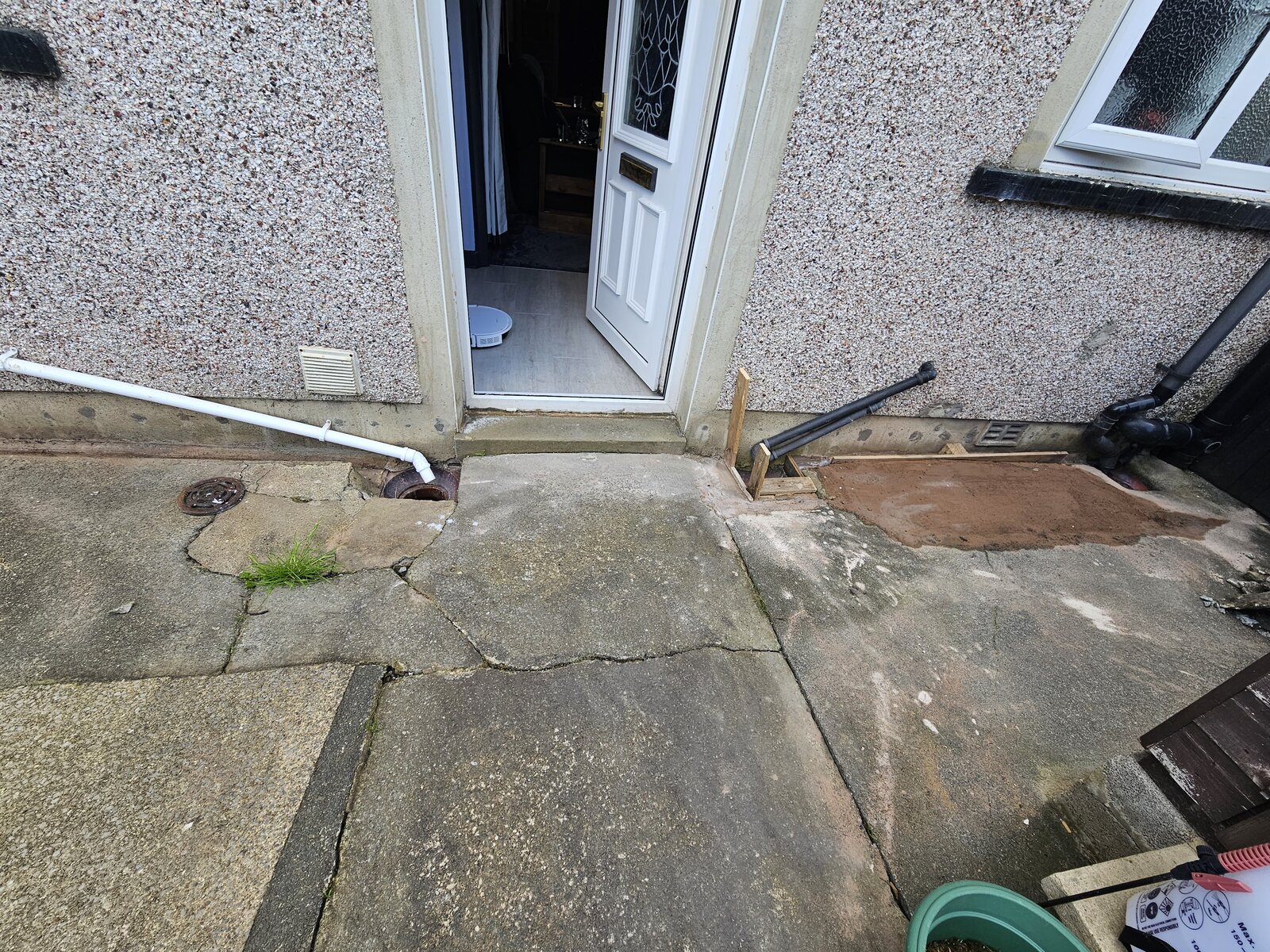

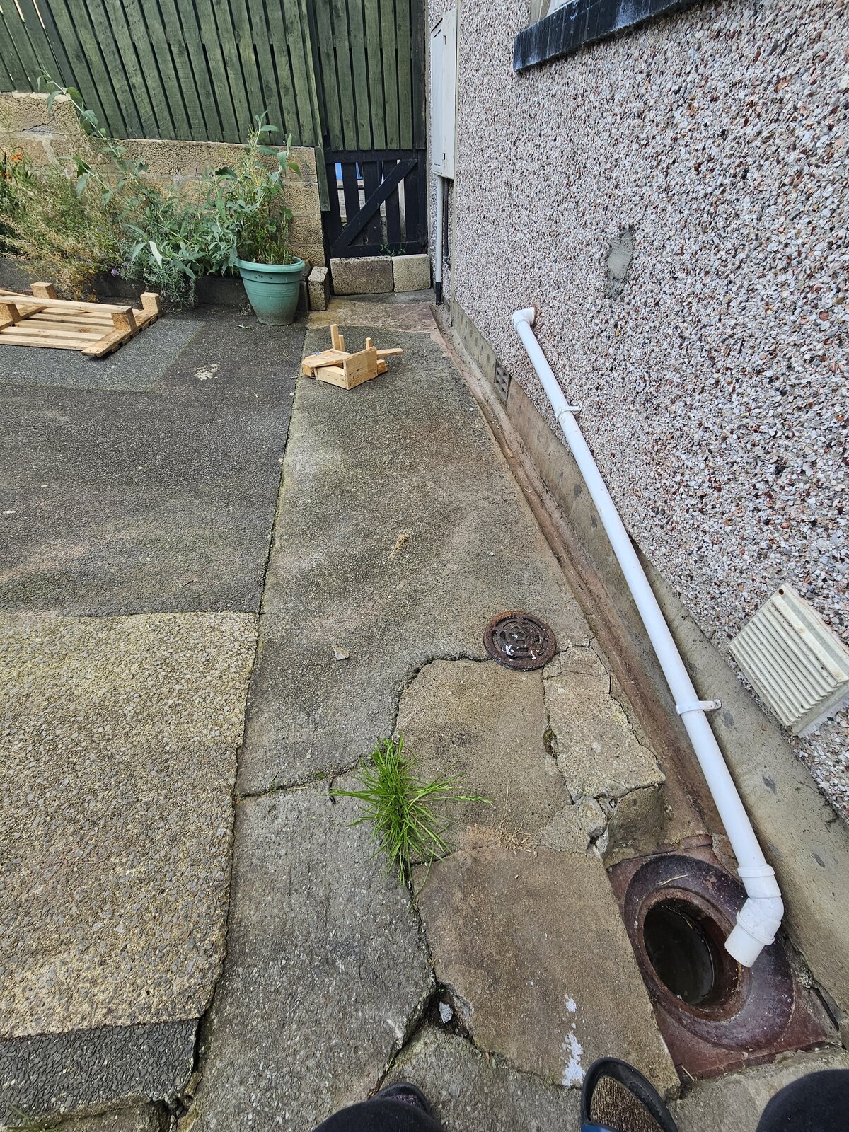

Hi

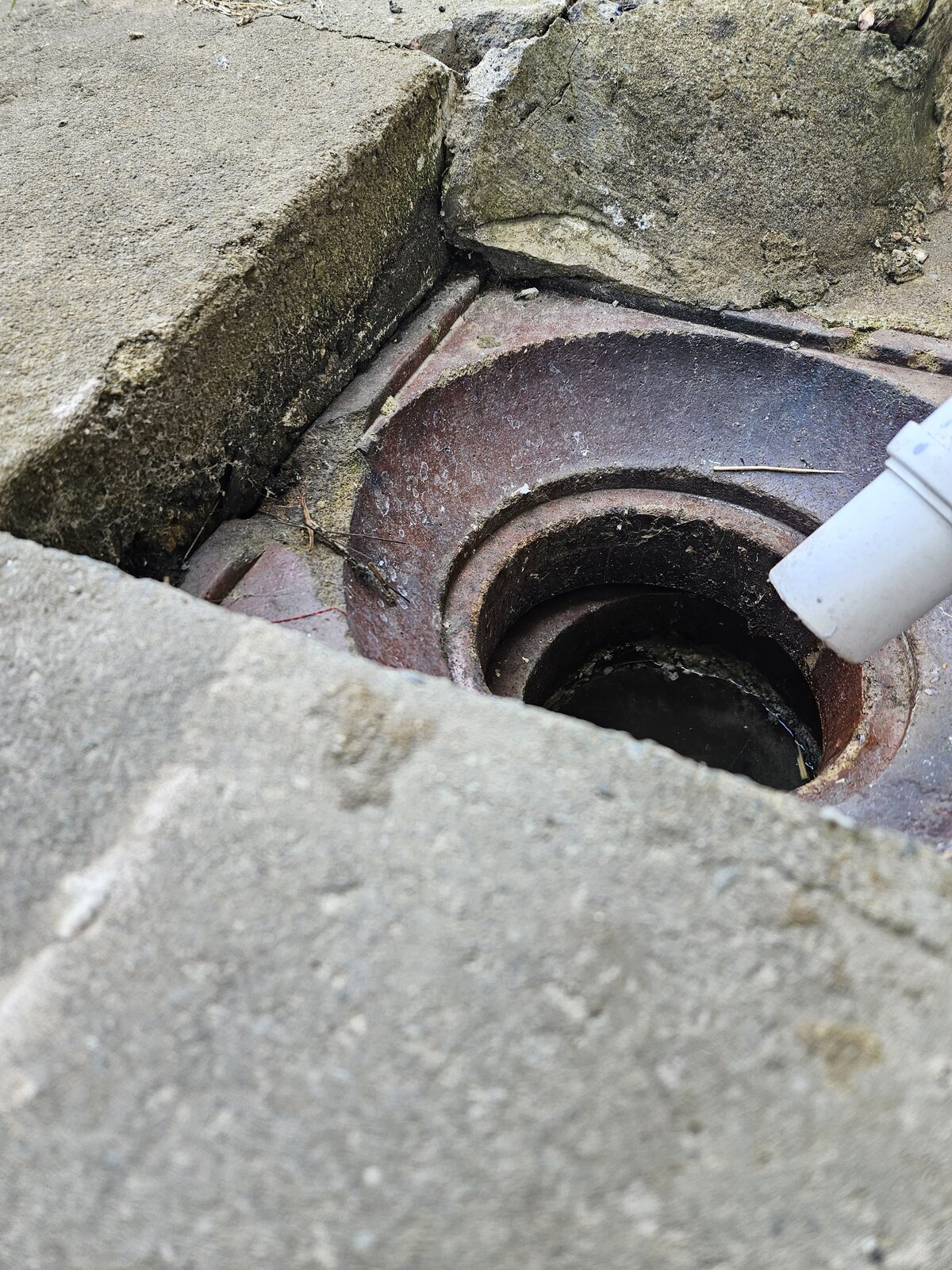

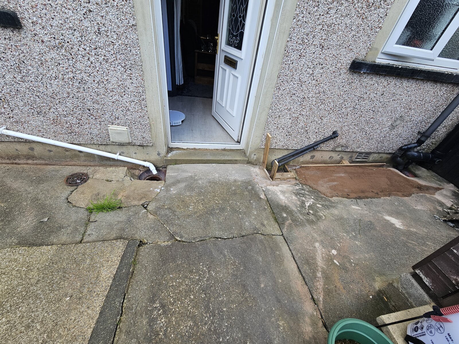

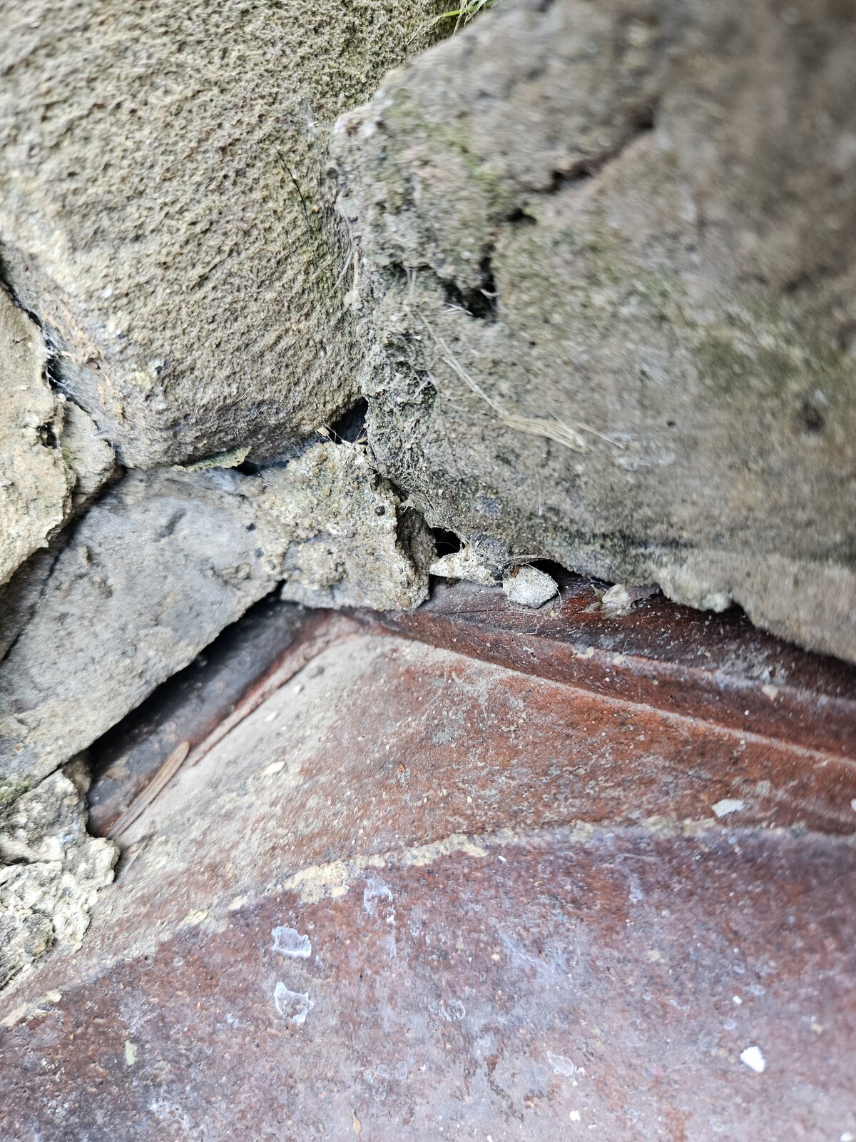

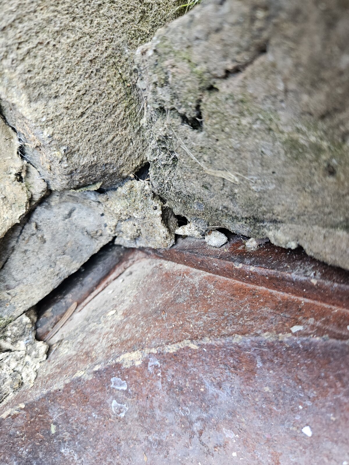

In my back yard, the concrete is heavily cracked and it slopes towards the house - in particular it seems that around the drains etc there is enough damage to get thorugh to the void space & who knows where else - which I think is getting damp (need to confirm)
Internally, I know there is a hole to the cavity space (currently hidden behind the waching machine) - and it looks generally pretty filthy inside, I don't think there's any damp proof coursing anywhere either - but you can definatley feel the breeze on a windy day from inside.

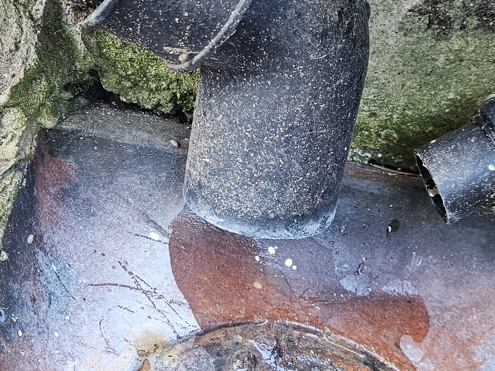

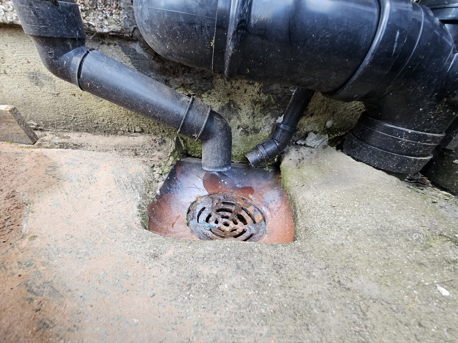

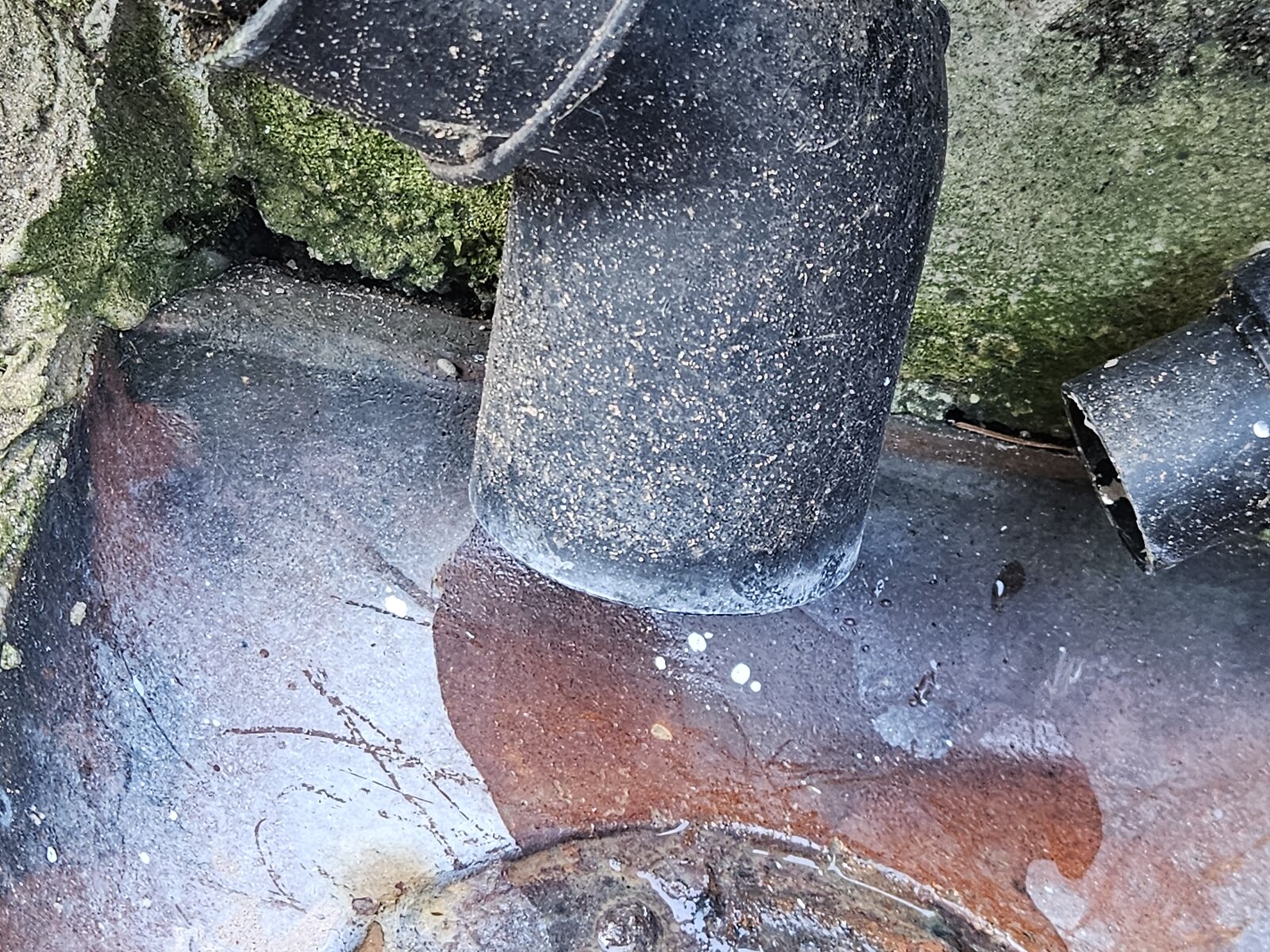

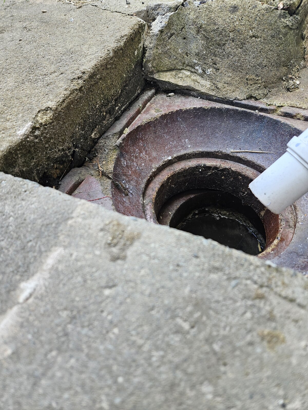

I know that there is a lot of historic patching up that is now falling apart, and many of the drain/water/waste pipes coiming out I'm suspicious of (I have unfortunatley discovered that most of the DIY the previous owners did is fairly shambolic and I know from neighbours that it was they who added the additional downstairs toilet, far right hand side of the door as you look at it)
Initially (when I thought it wasn't so bad) I was going to use some Everbuild Jetcem to seal everything up, and to replace the concerete drainage with some sort of proper drain system type thing - I know you can get channels that are meant for garages but thought that sort of thing would do a better job - but think really it might need more.
If anyone could offer any advise on how big a job this may end up being greatly welcomed - as I just do not want to let damp become an issue (or bigger one} - the sooner the better!
Cheers for taking the time
- Matt

Looks like damp heaven to me, especially with all that leaky earthenware drainage and the render down to the ground. I modernised and improved all my drainage and switched from old salt glaze to plastic. All that drainage could be improved and the outlets shortened/straightened, simply by rearranging where gullies and drains are located. Probably get it done for around £1800. Expect any quote to have caveats attached, as its all below ground (not visible) and assumption.
Even if the concrete wasn't cracked, just rain splashing off a hard surface will saturate a wall.
All the concrete needs to come up, lower and slope thebground away to a channel drain and check the existing drainage/renew gullies. Top with a gravel strip.
It'd be thousands but not mega work.
