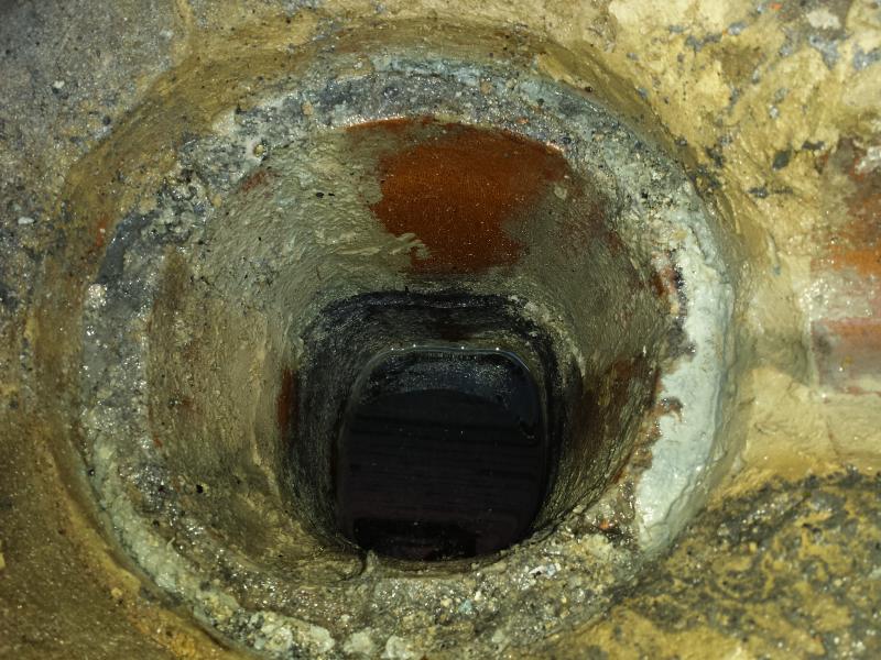

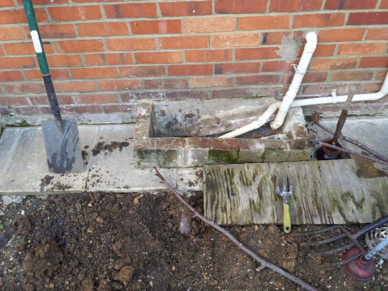

Hi all,
My bathroom appliances - aside from toilet - run to an outside clay drain as pictured. The main downpipe section, which is about 18inches long/deep, is cracked from about half way up, with some of the cracks sitting below the resting water line. I've tried to inspect around the pipe to see if its leaking significantly into the surrounding soil but it's difficult to get much closer without digging the whole thing up.
Second image shows the cracks which are exposed when the drain is plungered and the water line has dropped. It appears to lead into a clay pipe U-bend arrangement the top of which can be seen set back from the main drain where I've dug away the soil.
My question is, do you think it needs fixing? It has been like this for years and there's no obvious seeping of water but it seems unlikely that it's not leaching into the surrounding soil at least a small amount and this side of the house does have some issues with damp.
Note, many of the upper cracks I've patched up with cement - thus all the patches of grey. The main crack of concern is around the level of where the black starts.

I have to say many would ignore it until anything else caused concern.
The correct procedure would be to replace it but that would involve a lot of digging as well as sometimes some tricky jointing between modern plastic and the old s.g. clay pipe.
Tony
I would replace it with a modern hopper head and a riser connected with a Fernco coupling ( see: flexseal.co.uk).

As regards digging - simply remove the bricks, & a few concrete flags, and dig all around the gulley to expose the "black" connection. Half an hours work, if that. Then post a pic back here.
Your lower brick courses show much water staining - where is your DPC?
The 32mm waste can be Tee'd into the 40mm waste with one pipe discharging into the gulley.

That's exactly why those flags have been placed there - I did it myself a couple of months ago. There was a concrete path before but it was so cracked and uneven that it was useless at draining water away and, as you point out, there is some evidence of damp - I've yet to work out where the DPC is and what state it's in. I really should chisel out one of the bricks at some point cause I know the wall cavity has been insulated but have no idea what state it's in down near the ground level.
I had planned to dig out and check the drain before laying the slabs but forgot. Now I'm finally getting round to revisiting it given that the damp hasn't entirely gone away.
My current thinking - if I do anything - is to try and completely dry the drain then create a lining that'll run to below the cracks (there was previously a bottomless kid's bucket attempting to do the job but it wasn't sealed so was useless). Then I'll just shove loads of silicone between the liner and the clay to try and seal it.
When it stops raining that is...
Thoughts?
I had a similar issue.....a vertical cast iron soil pipe was fixed into a salt glazed gulley just below DPC level.
Foul water was appearing around it, but not a huge volume.
With some clot swinging on the soil pipe at some time, the gulley was cracked almost to the bottom. Excavation of this would have been hellish due to the drain from the gulley disappearing under the patio.
So......I carefully removed all of the soil and clay from around the gulley, washed everything clean, packed the broken chunk of salt glaze back into place and then created a concrete sarcophagus around the gulley.
I left it open for a few weeks but thankfully there's no seepage anywhere.
John :)

Your DPC should best be 150mm above ground level - ground meaning either soil, paths or flags. Otherwise the DPC is bridged, and if the cavity is also bridged and has sodden insulation you will continue to get damp issues.
I've already suggested what you could do ref the gulley - your above proposal wont work. Dont waste your time.

Think I will have another dig, see if I can get to the outside of the crack. Then might try a similar solution to John as I really don't want to be just replacing the whole thing - it's a whole other level of work and cost, especially as I'd then want to do the same for the matching kitchen drain 10ft away (cost saving is a significant aspect of this endeavour).
If that doesn't work, well then I'll know what I need to do.
