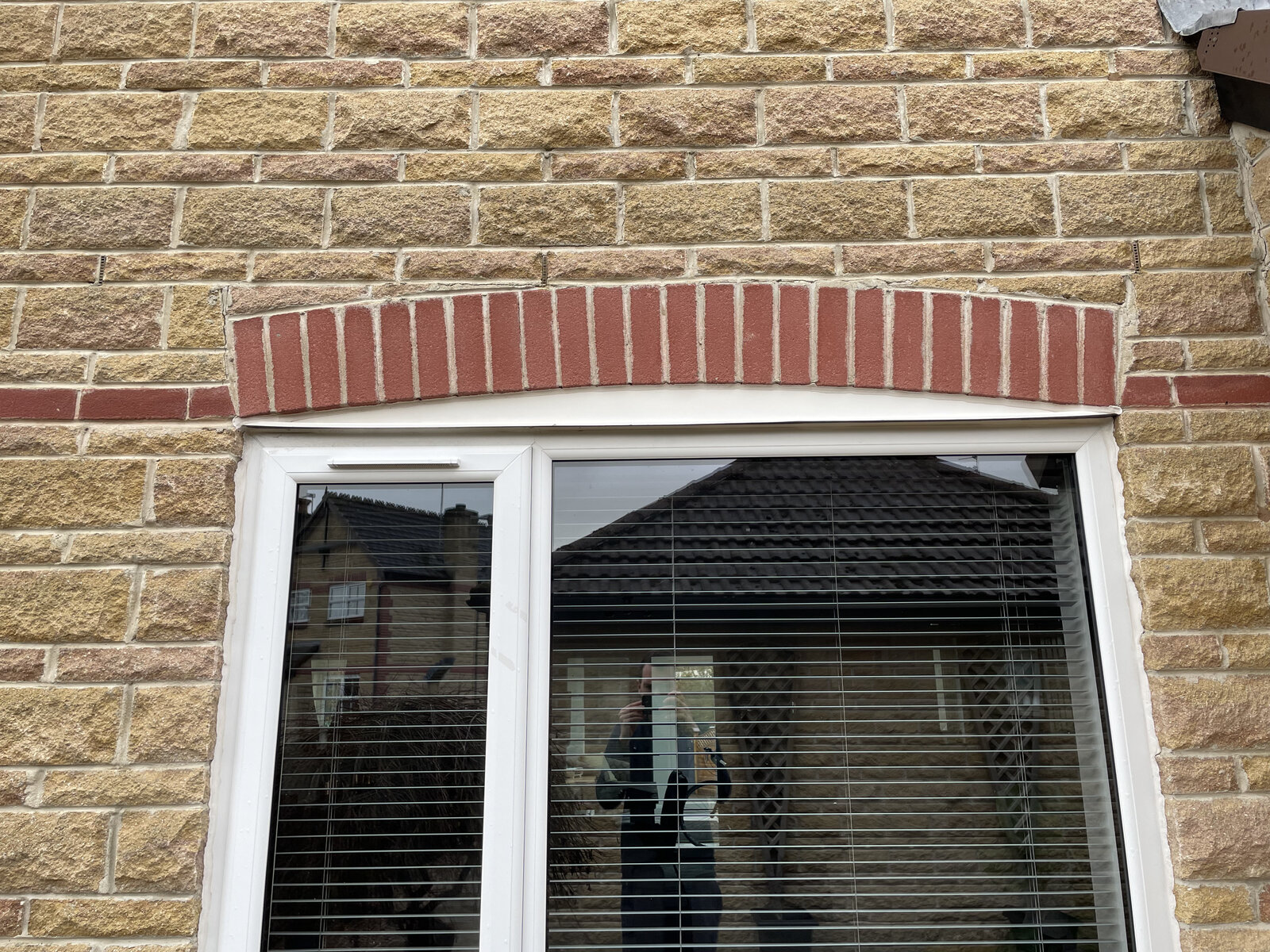

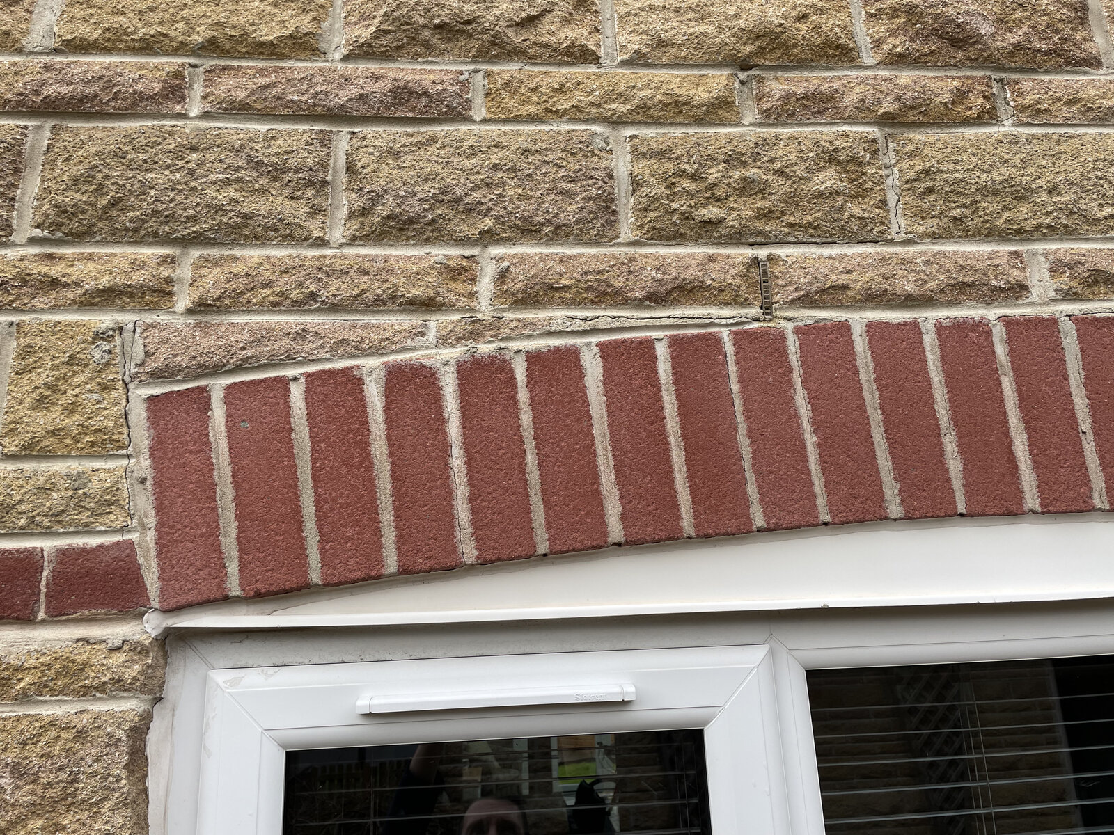

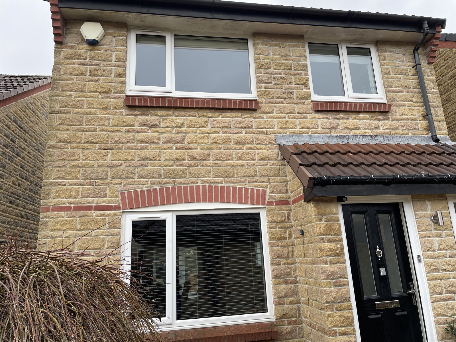

We moved into our first house 2 years ago, and I've only just noticed these cracks in the mortar above our lower-floor window. They might have been there all along, but nothing was flagged on the homebuyers report when buying the property.
I was just wondering if this was a sign of something serious/what the best course of action is. I've been so worried after reading about stepped cracks!
There are no internal cracks and no other signs of subsidence, so thought I would reach out to this great community.
Pictures below:
Looks like a weak spot above the window has allowed a little ex-con movement. Not the best masonry set-up considering the stone façade and the lack of joint bonding.
Good morning, many thanks for taking the time to reply - it's very much appreciated!
Do you think having a word with builders to repoint/rectify the issue would be the best course of action?
Cheers!
Cheers!
It can be countered with brick tor built into the beds, but the best you can hope for is a pointless re-point.
Great - thank you.
And finally... I probably don't need to worry about it being structural then?
