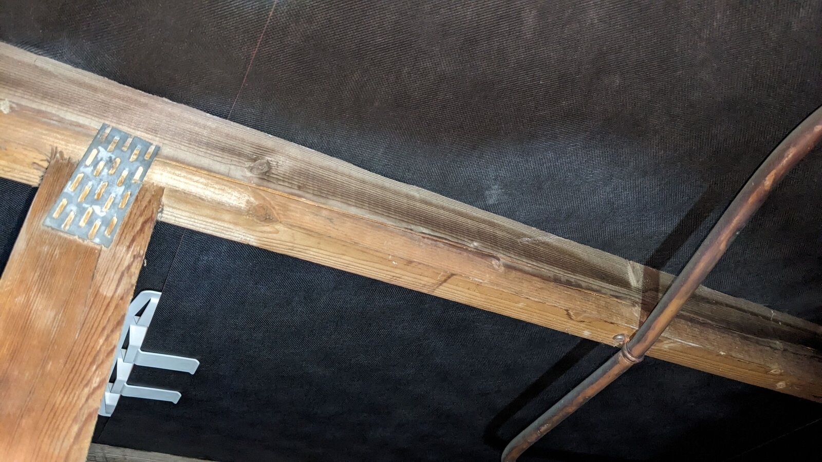

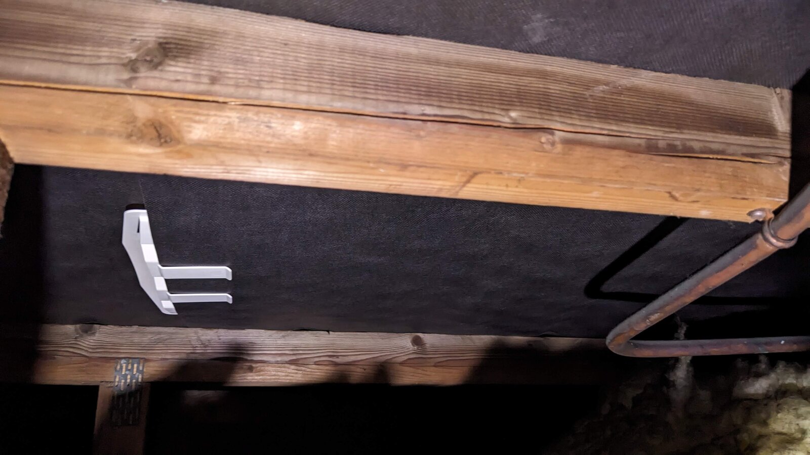

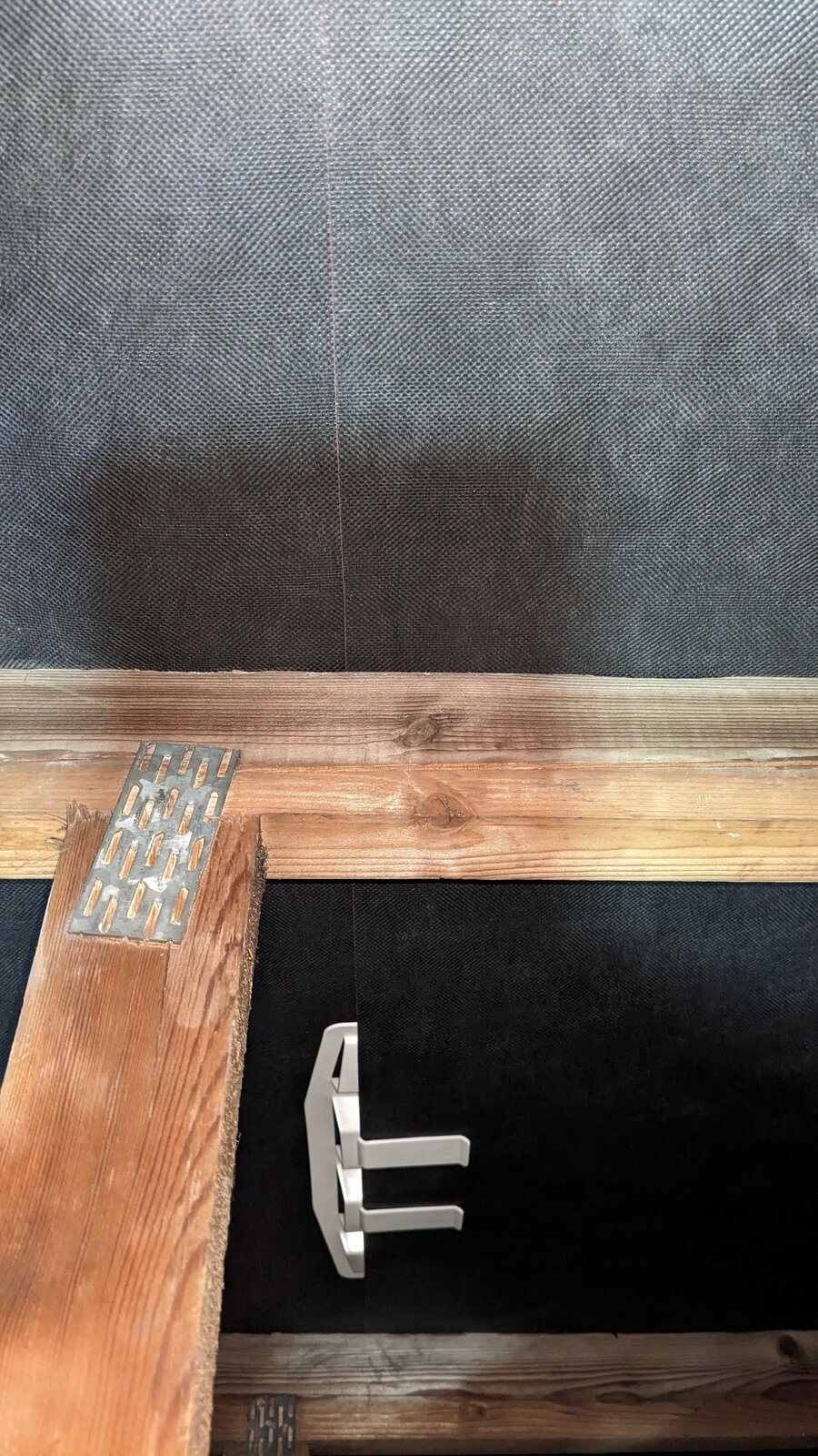

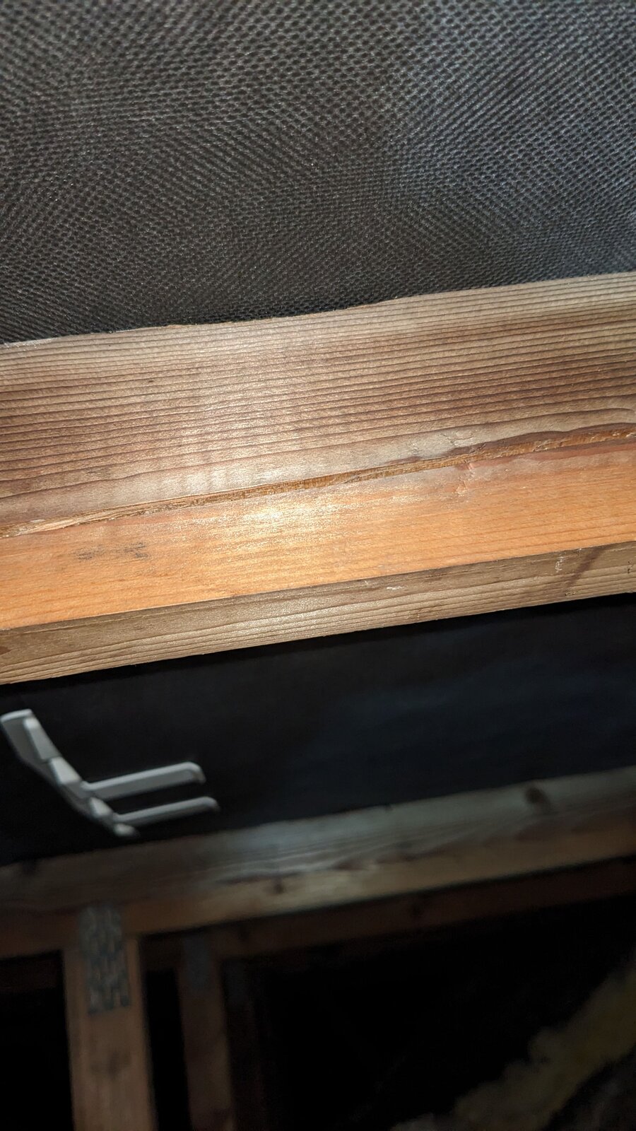

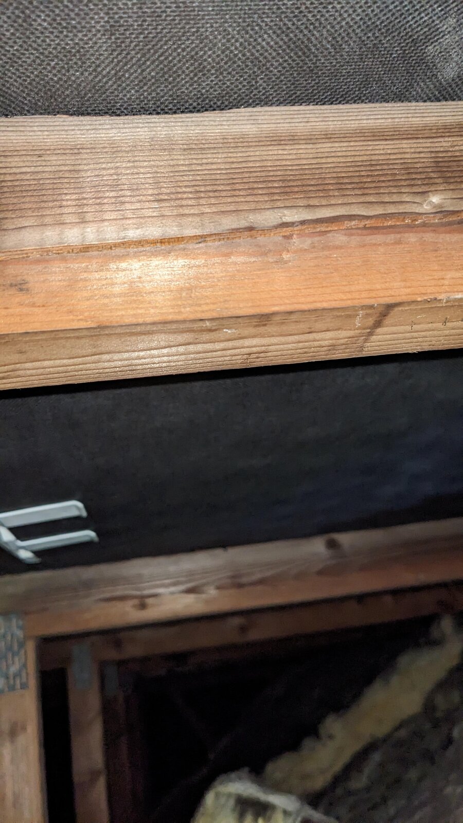

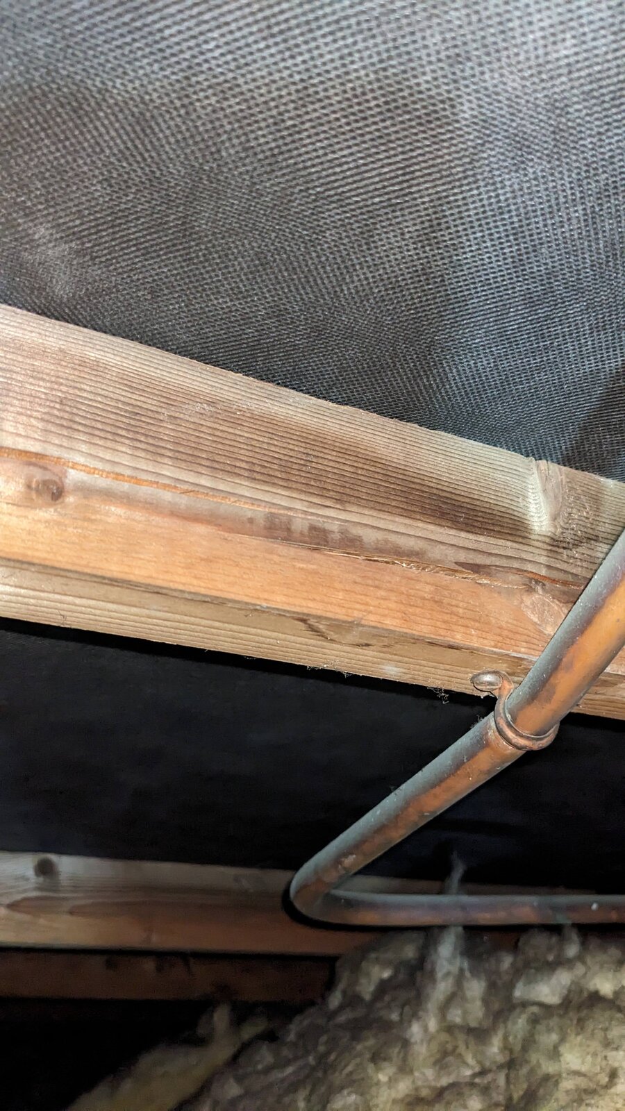

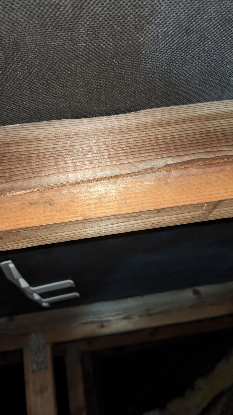

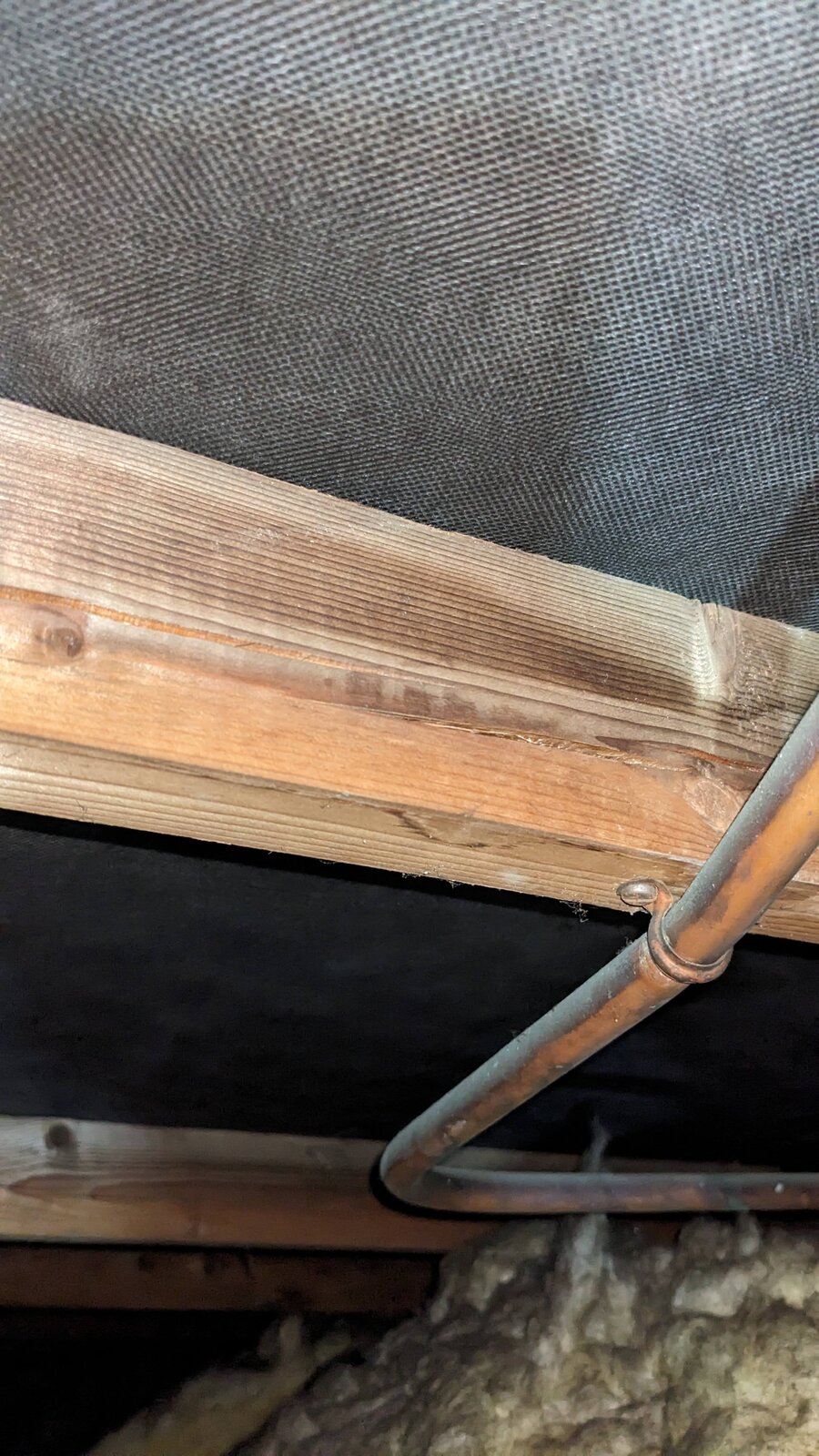

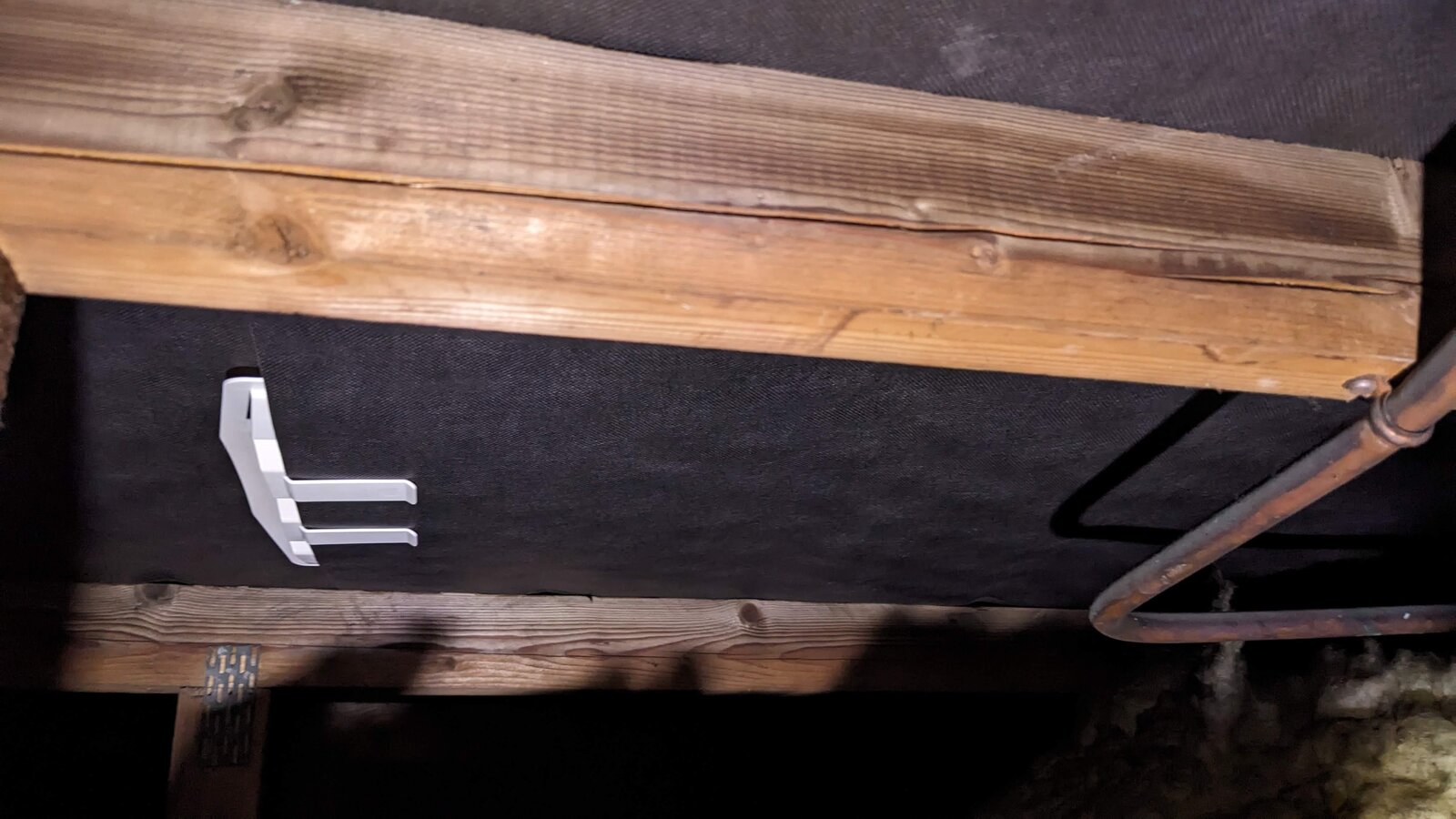

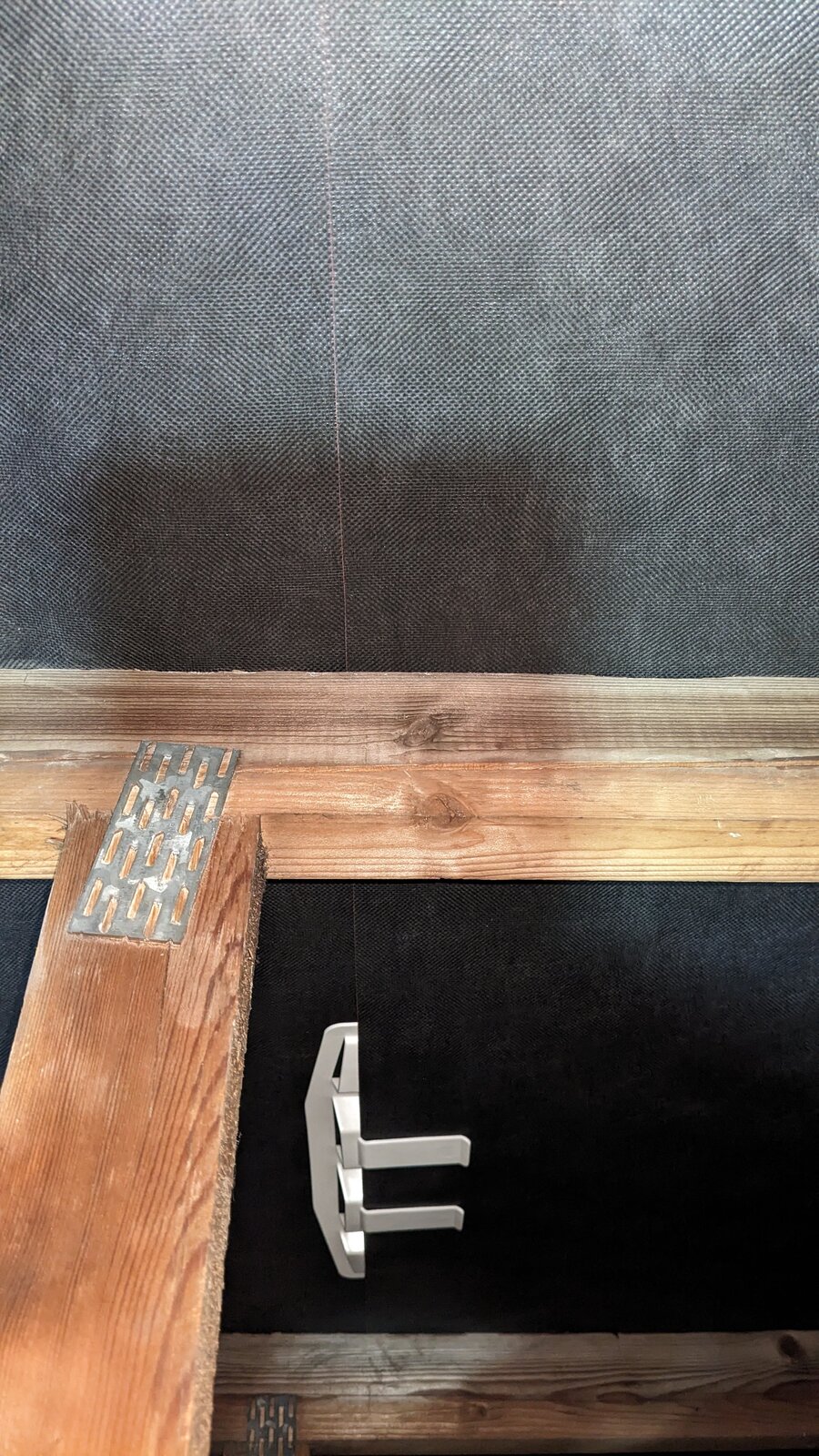

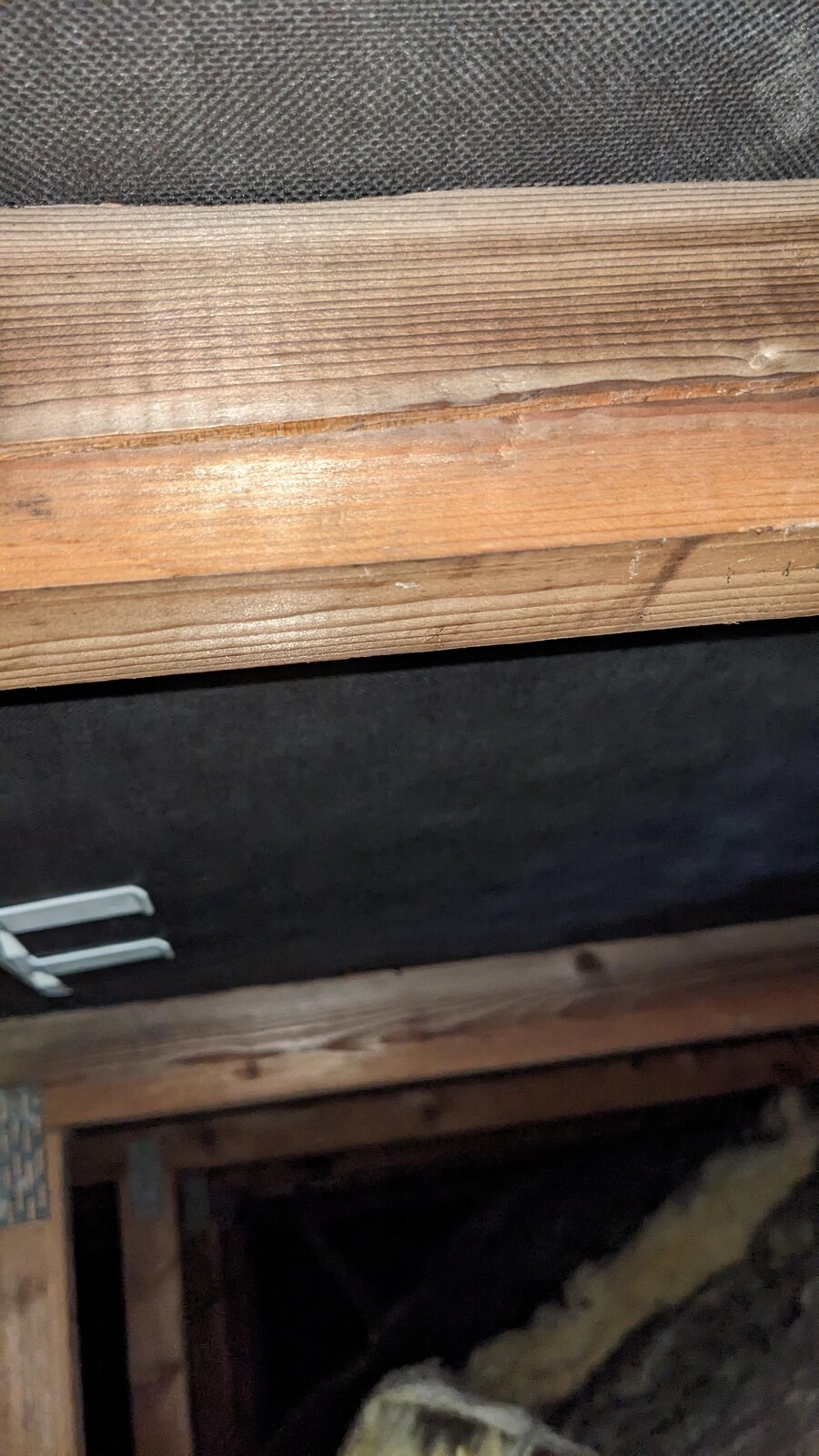

Hi, hoping for your opinions.
Noticed a crack in a roof truss about a year ago after having a re-roof (replaced battons, felt and tiles).
Others around it appear OK.
Had a look recently and appears slightly bigger (not much) looking at the pictures is it anything to be concerned about (ie get a structural engineer to look at) or just monitor it myself?
PXL_20240618_134915146.jpgPXL_20240618_135013909.jpgPXL_20240618_134956172.jpgPXL_20240618_134947891.jpgPXL_20240618_134939256.jpgPXL_20240618_134929273.jpg
Thank you
I don't think its anything to worry about.
If it got worse then easy enough to fix timber to the side but fine as is at the moment.
Often see splits in wood like that. It's probably not deep
