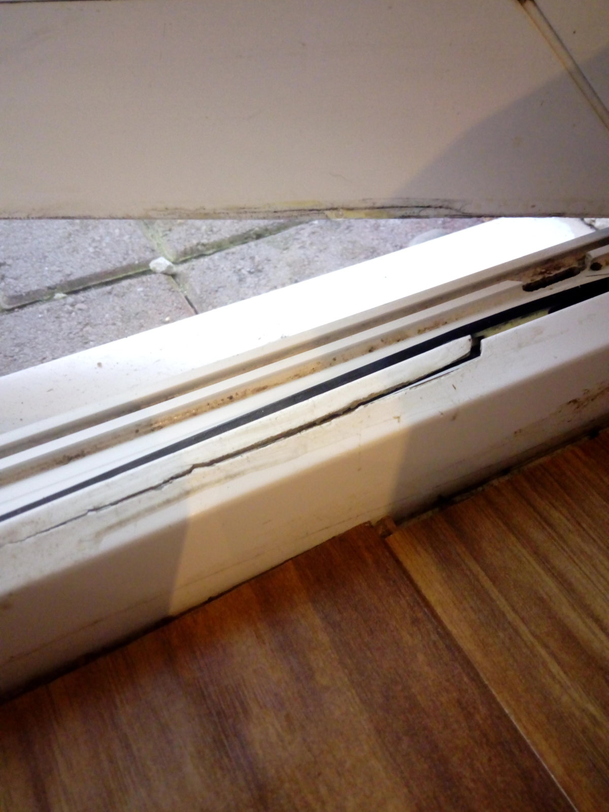

I've a cracked in the bottom of my UPVC door frame, wondering ways to secure it & make good?
You could get a metal kickplate that would cover the damaged threshold. Search the internet for a ' upvc door bottom threshold rail kick strip'. Years ago we used to get them as STD on pvc doors , haven't seen one supplied in years though
