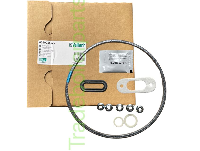

Did they put the grease around the burner threads and mating faces?
It was supplied in a sachet along with the graphite burner seal. unless that changed.
I don't know. I know it was a gasket kit 0020038679 and electrode kit 0020153950 that was fitted. That's all.
He checked the bolts when he came earlier and they were all done up correctly
The noise may be due to the differing expansion rates of the stainless steel front of the heat exchanger and the aluminium burner manifold that bolts to it....the grease alleviates the problem.
