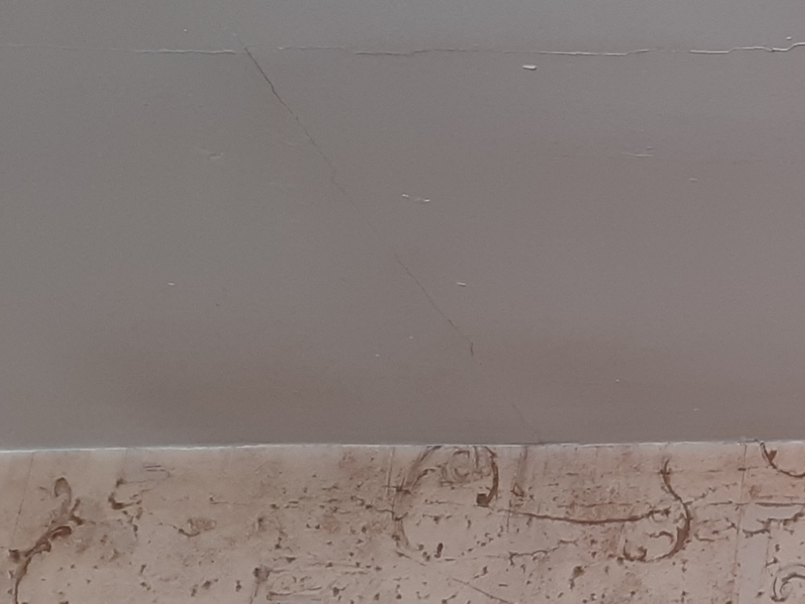

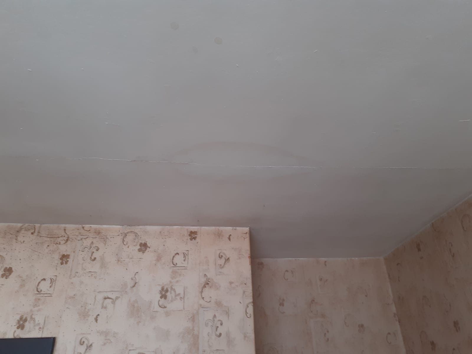

Plaster cracking along board how urgent is this repair and what is required local authority dont think its an emergency until ceiling comes down
It won't come down any time soon, possibly not in your lifetime.
Cracks are only cosmetic.
What about rats in the attic?
That's an emergency, so if you suspect they're there, get on to the council and don't get off the blower until they book an appointment with an exterminator.
the cracks you show appear to be along the joints in sheets of plasterboard. Measure them. Do the cracks follow a rectangular pattern, 4 foot x 8 foot? That sort of crack is of no consequence.
The leak above that poured water onto the ceiling may be the cause.
Have a look from the loft and see if the paper on the top has rotted away.
When was the leak fixed?
is any of the ceiling hanging down?
