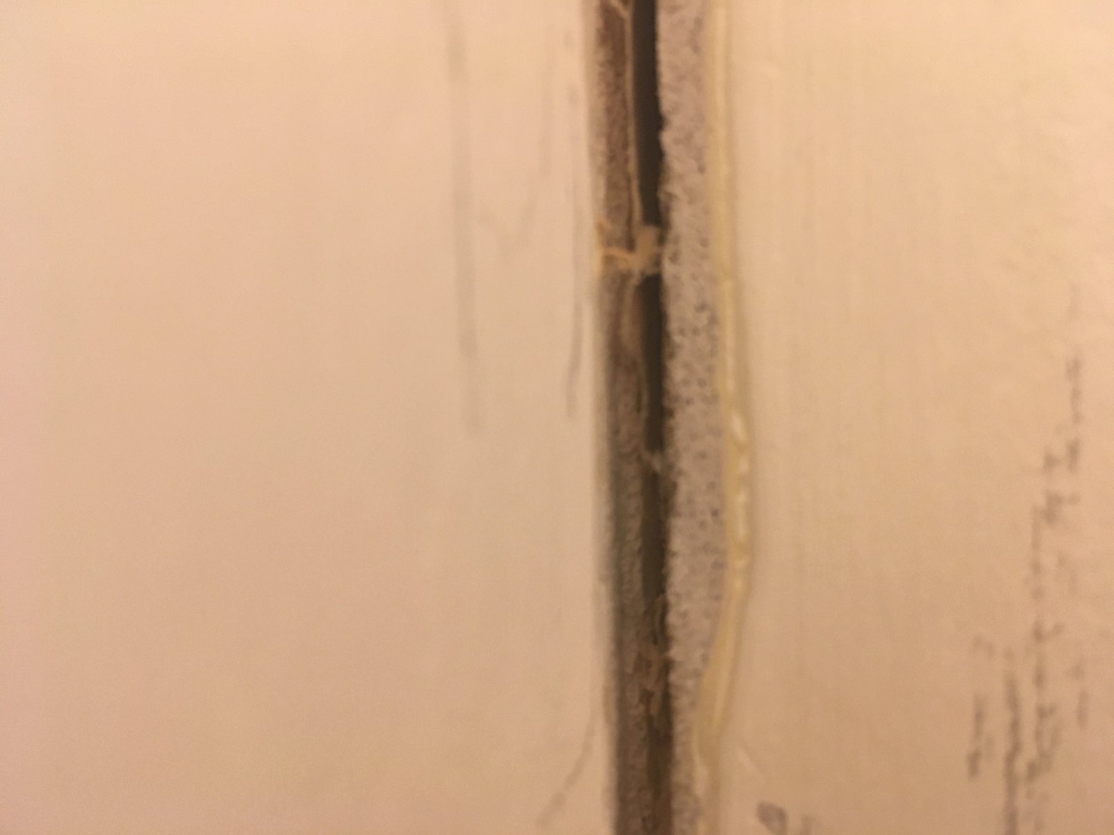

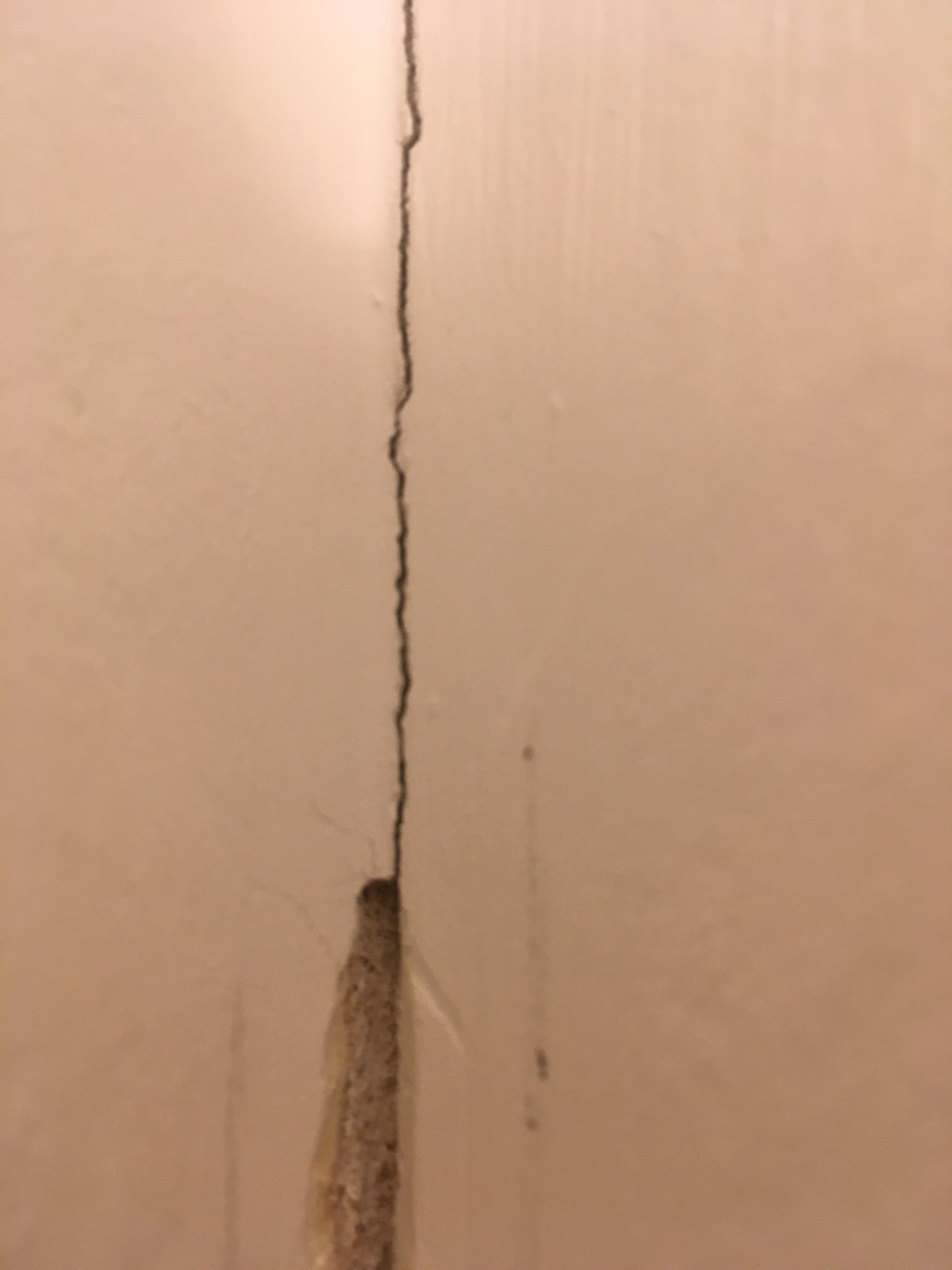

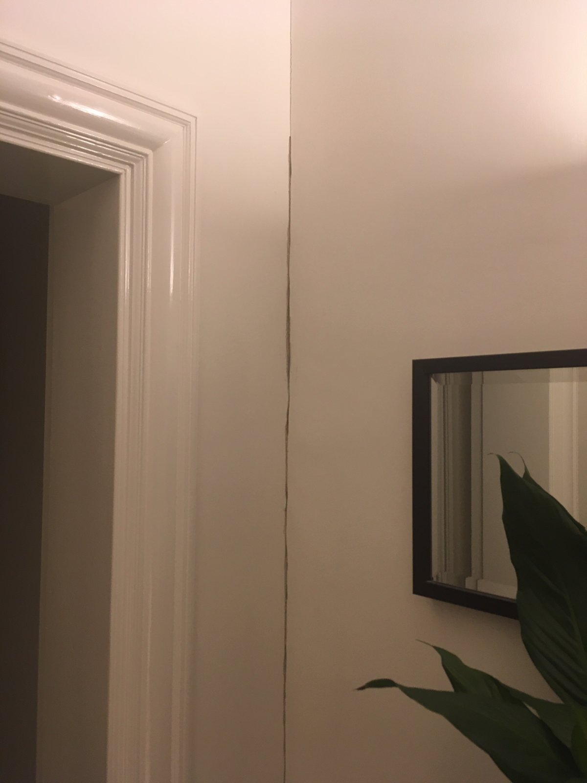

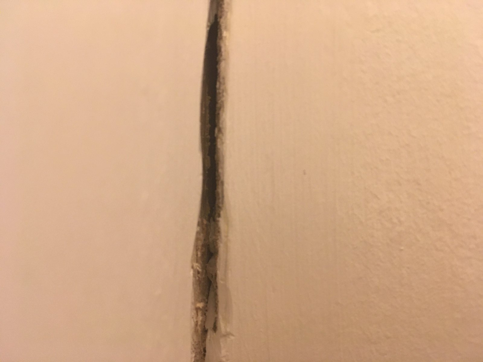

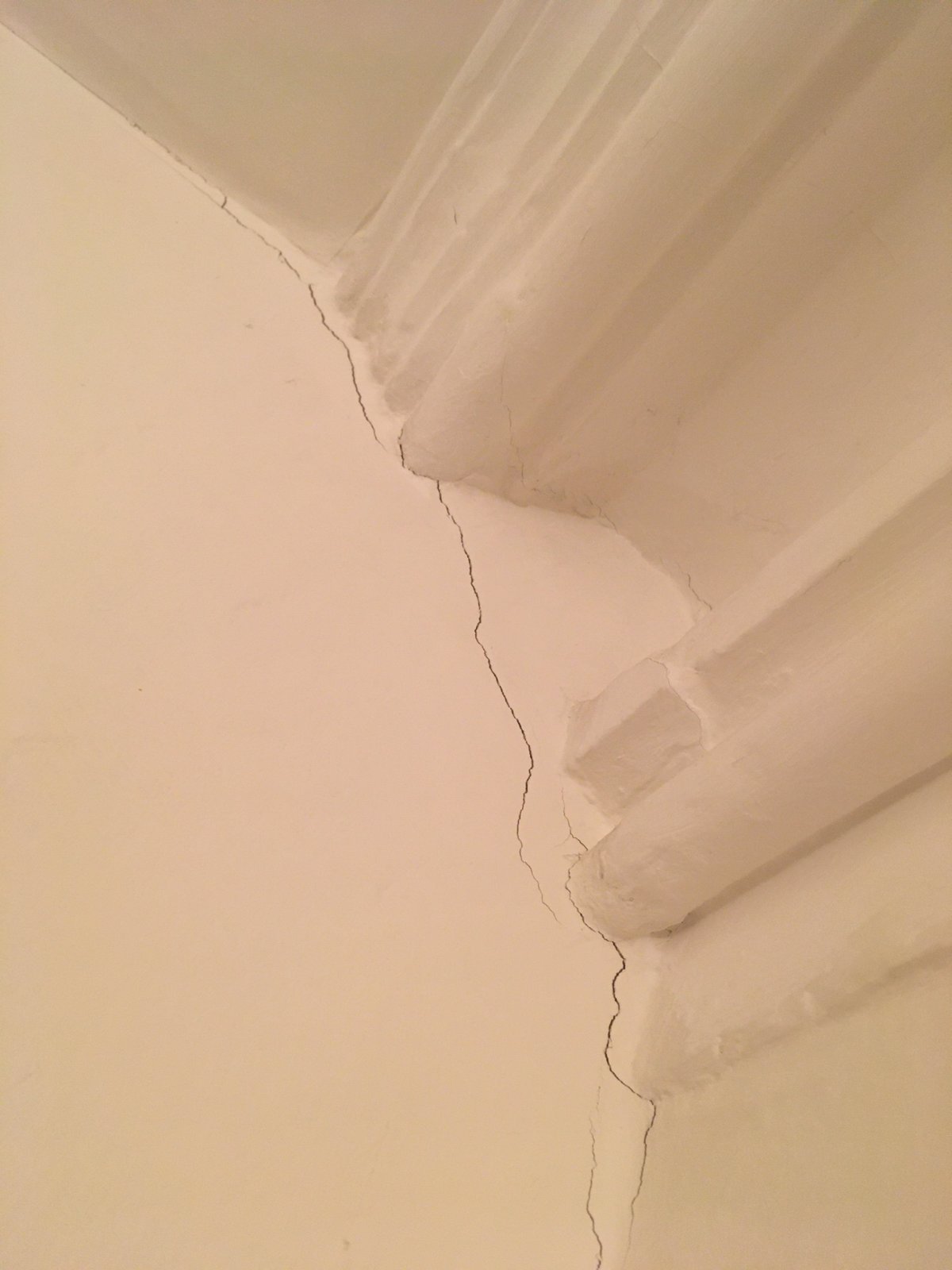

My Victorian flat has developed thin cracks where walls meets walls. I think it's caused by vibrations from the flat upstairs' washing machine. Photos attached.
I've cut out a section at one spot with a stanley knife. It's hard to tell how deep the crack goes. I can see old paint, old lining paper and plaster but I haven't dared open up so much that I can see any brick. I'd like to make this a quick, easy fix that will hopefully last at least 5 years. What I don't want is a complete wall smashing dust fest.

i doubt that the cracks have anything to do with the washing machine.
the plaster coving has historical repairs showing, and its upper floor location showing the crack running up a sloped ceiling/roof soffit implies that the cracks might have more to do with minor structural movement rather than a w/m?
are any of the walls involved external walls?
you could certainly rake out the cracks and then use a filler or you could hack off enough plaster to expose the brickwork behind the cracks, and post pics of whats exposed on here?
given its a flat, these affected internal walls might actually be dividing partitions that have not been tied in properly to their abutting walls?
there are a number of other possibilities, and unknowns that involve lower floor flats and previous structural work to floors or walls.
or it might be due to something pretty simple - cracks often are.
the fly in the ointment is the previous historic repairs?
do you intend to fill or expose?
