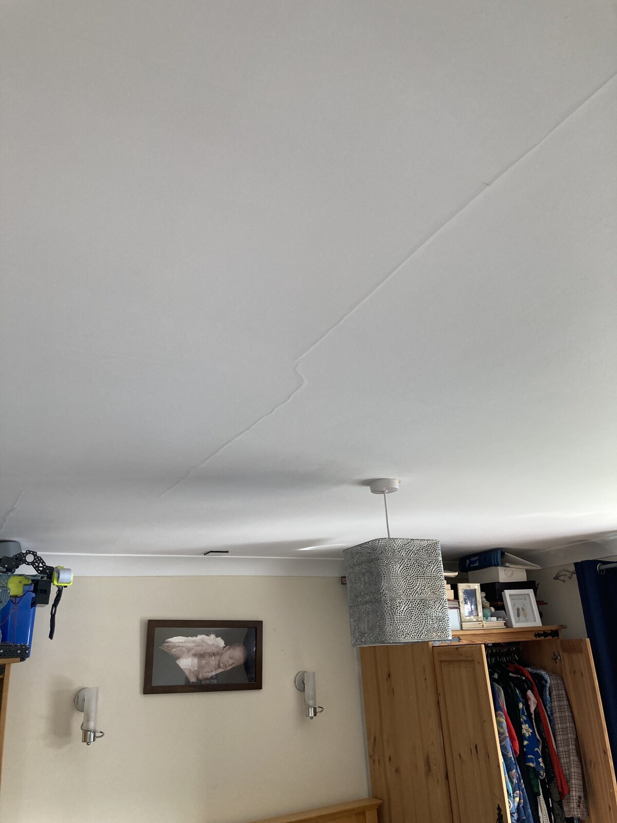

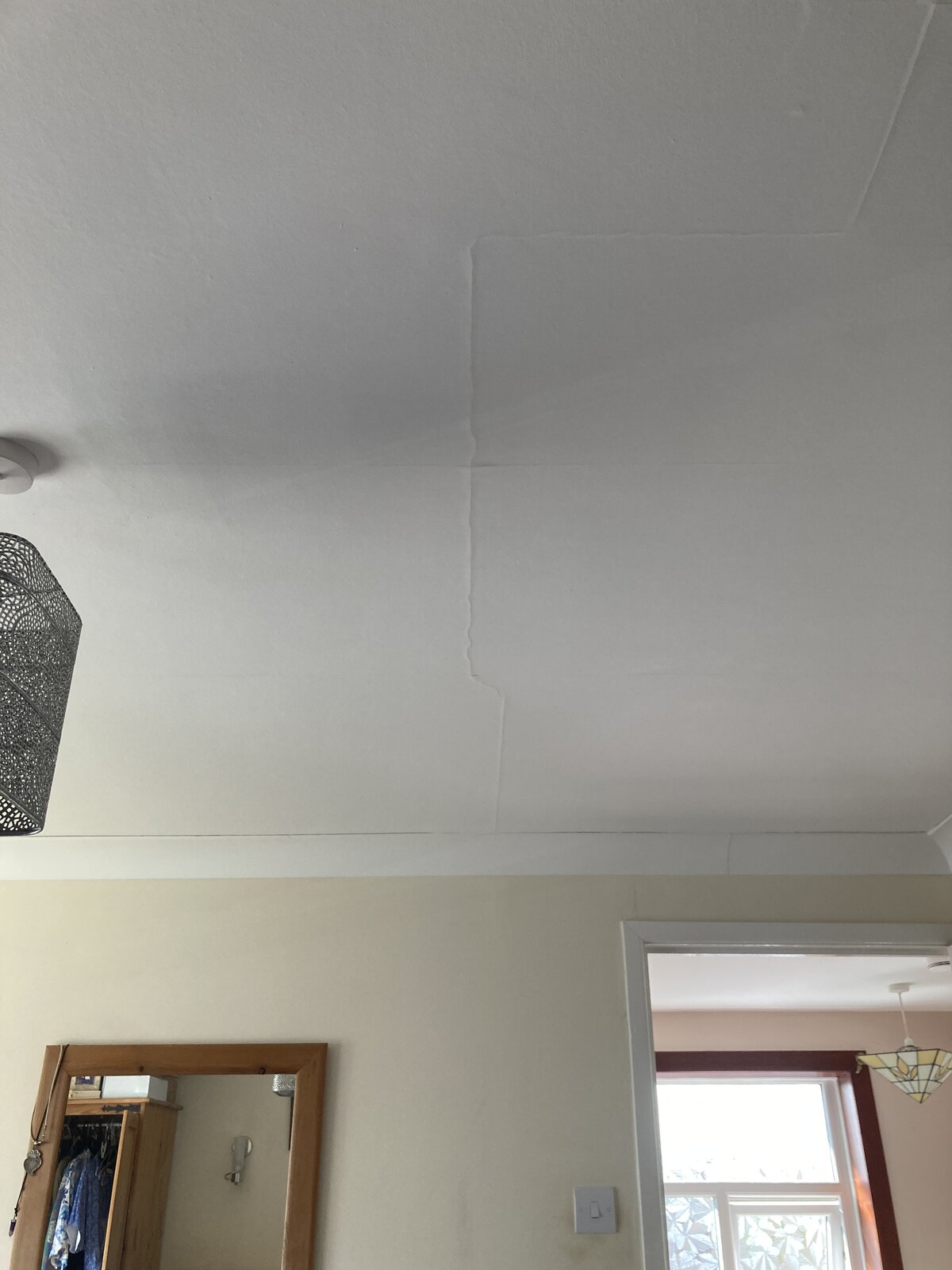

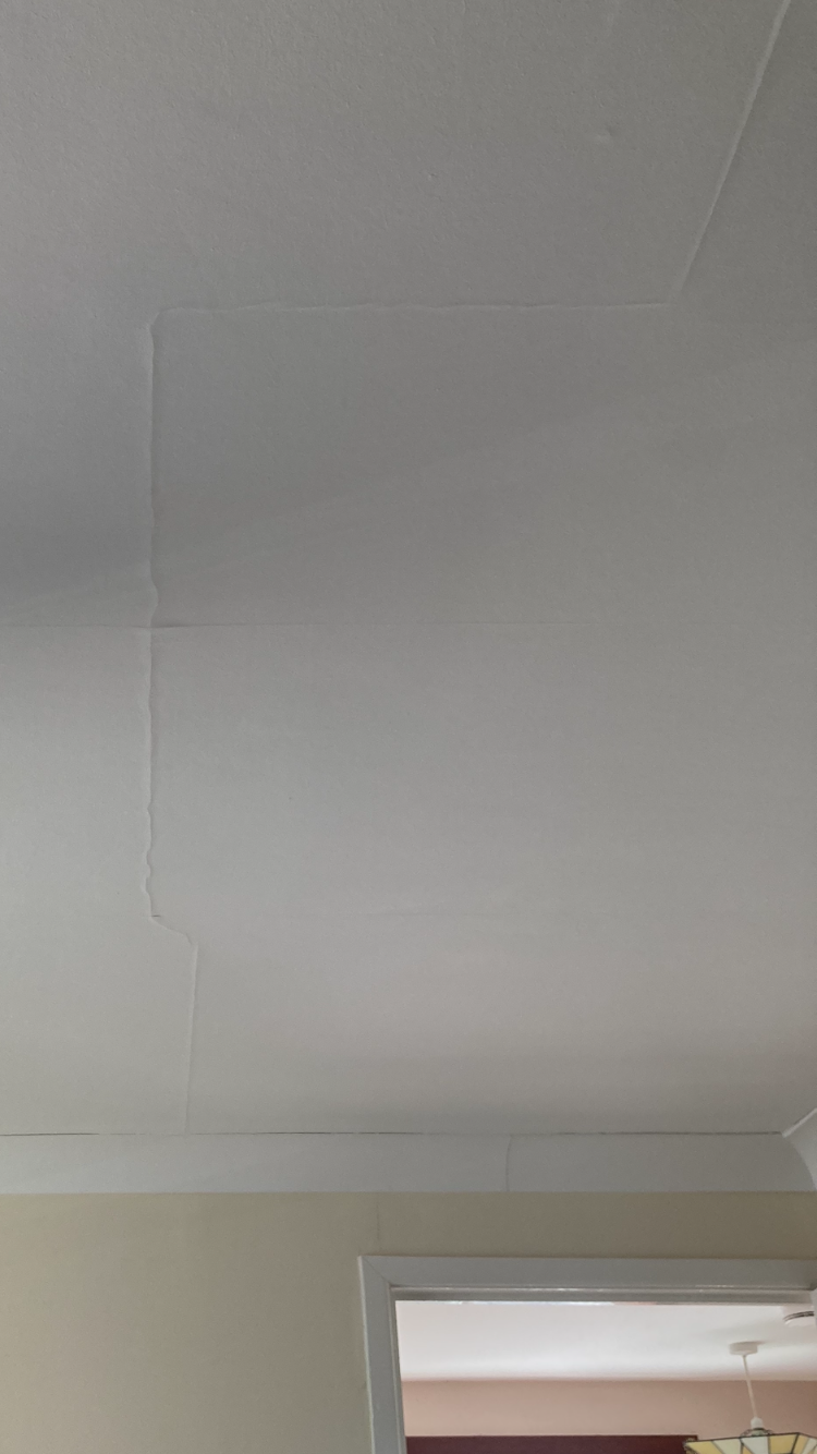

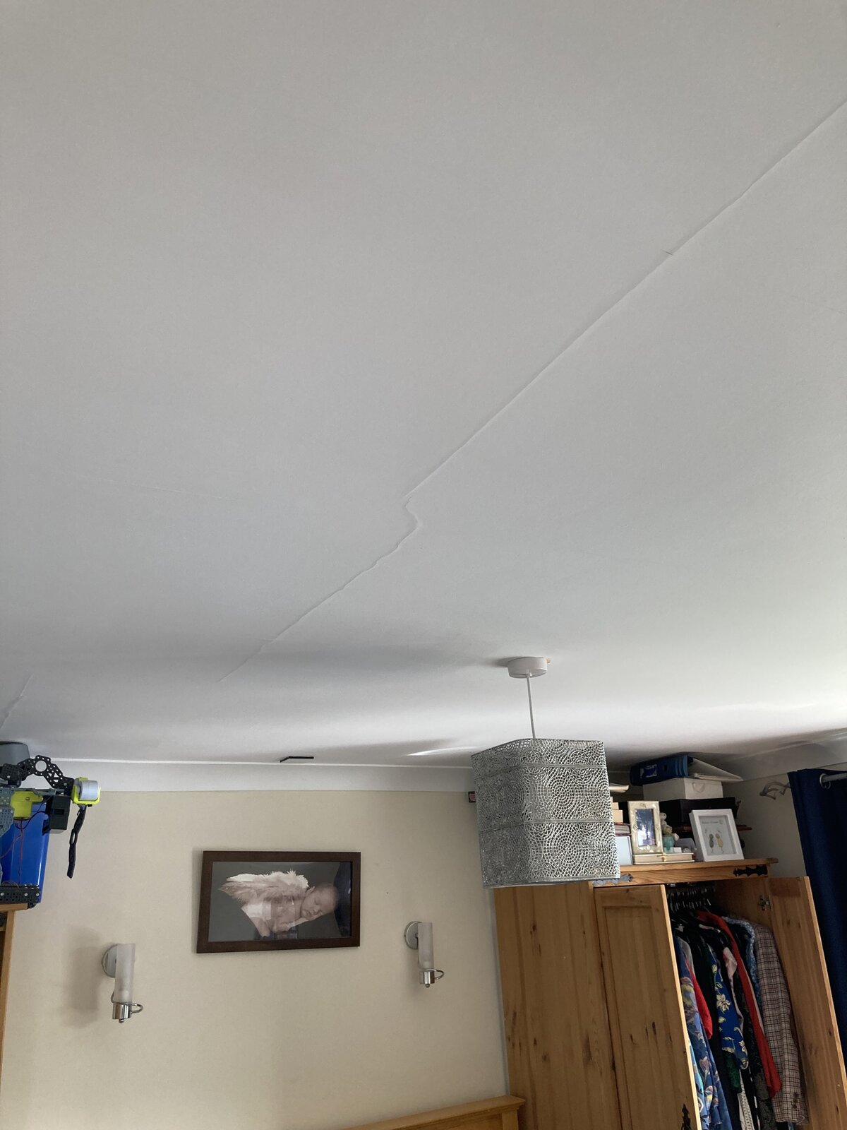

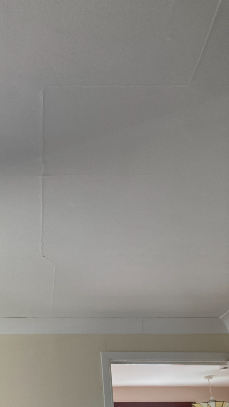

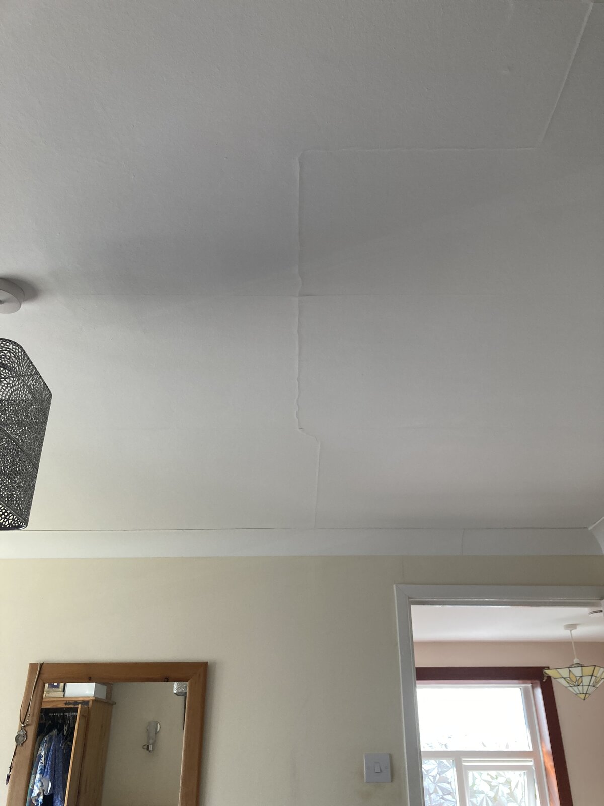

Cracks in bedroom ceiling
21 Jun 2024
5
Any thoughts on what has caused this?
Been ongoing since 2017 but gone full length this year

I'm not saying your situation is the same, but we have had cracks appearing in the house over the 25 years we have been here.
I was paranoid there was movement in the house and had a couple of surveyors look at them over the years. I was told things were OK. However, over the last few years,small cracks have appeared in the side wall, along with a crack in the ceiling of the front bedroom that ripped the wallpaper covering it. We had another surveyor over who diagnosed very slow movement in the roof structure and recommended some additional bracing timbers in the roof to stop it spreading.
Have you got cracking appearing anywhere else in the building?
The shape suggests it is the joints failing between sheets of plasterboard. The sheets are usually about 8ft x 4ft. How big do yours look?
How old is the house?
Take some photos showing the structure of the roof timbers in the loft.
Do people and heavy objects go up there?
Are you using the loft, as extra storage space?
Are you aware of those ceilings having been replaced with plasterboard, at some point in the past?
It was not uncommon in the past to use nails to fix plasterboard and of course nails do allow movement. The blokes doing the job didn't care because they would be long gone before the movement began and cracks occured as a result. I suppose it should not be too difficult to replace the nails with the correct fixings which are of course drywall screws although I have not yet tried it myself. These screws are far less likely to allow movement if at all.
