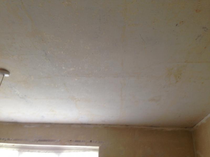

Cracks in ceiling
It looks like it could be a case for some heavily embossed wall paper Kerry - or get a plasterer in to skim it for you.
John :)
Open up the crack a little then fill. Once dry you can then sand it smooth, if it doesn't appear level then use a wide filling knife working the filler along the length of the crack giving you a feathered edge let dry then sand smooth.
It will give the appearance of one level, I would also suggest using easifil for this.
