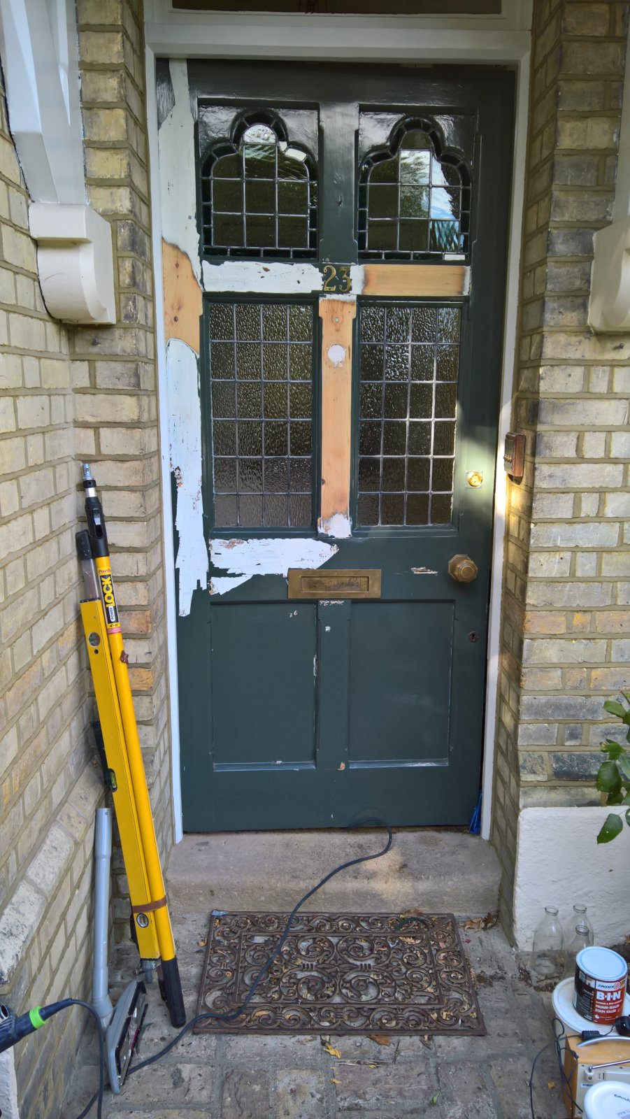

Hi all,
I am currently repainting a client's front door.

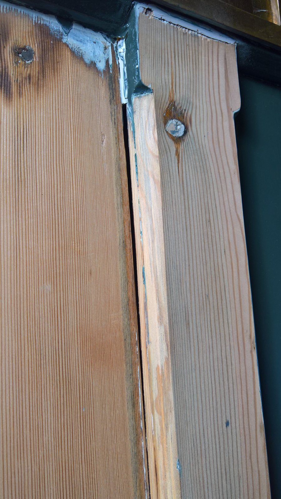

All of the mortise and tenons joins are cracked (hairline). I plan to drill wooden dowels to lock them in place and use polyurethane to glue the dowels. I plan to leave them slightly under the face surface and then back fill them with 2K or epoxy filler.
I then intend to use a multitool to remove the old 2K filler from the gaps and fill with Timbacare 1 hour epoxy.

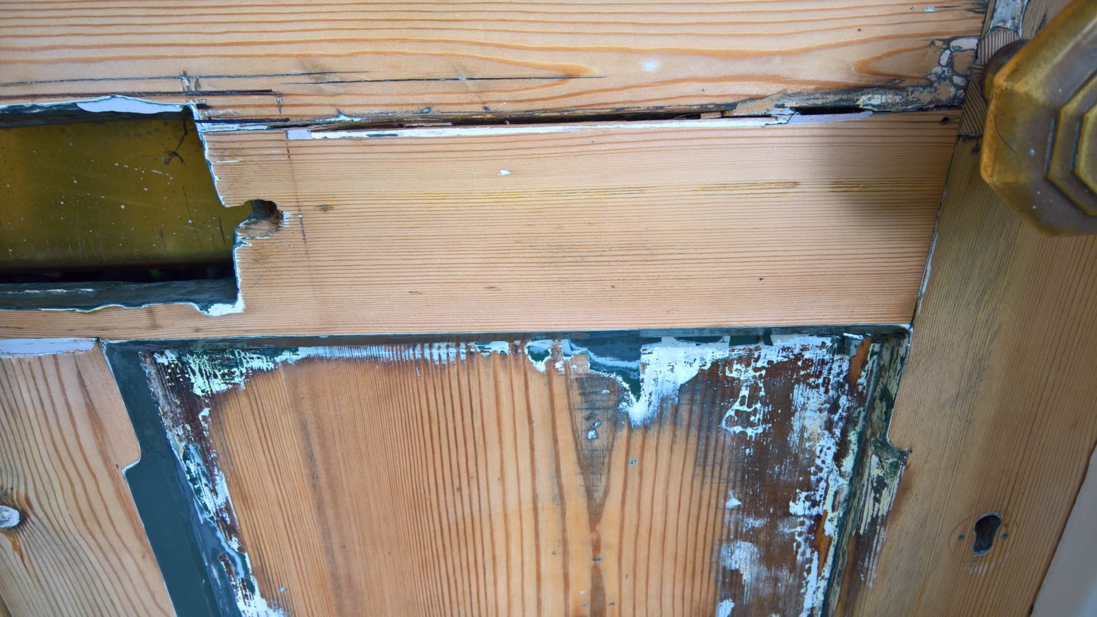

I also have a pretty substantial crack to the side of the the letter box.
It runs down diagonally all the way through the rail. Is there anything I can do other than filling it with 1 hour or even 4 hour Timbacare epoxy? Would dowels drilled perpendicular to the crack help at all?
Finally, I have some large gaps where the recessed panels are.
Not really sure what to do with those. I did quickly paint the door earlier this year but explained to the client that it was only a temporary job. I used CT1 to cover the cracks where the panels meet the rails and styles, the CT1 didn't crack but a hairline crack appeared where it meets the old paint on the panel.
I am guessing that the door is about 140 years old. I don't think it has ever been dipped but I can see that it was stripped with heat gun about three decorations ago.
The door doesn't get very wet unless the wind is quite blustery.
I does get quite a bit of sunlight until the late afternoon, and yes the clients want me to stick with the dark green paint
Any (sensible) advice would be gratefully received.
Cheers.
The joint between stiles and rails will always crack -its caused the the expansion and contraction of the stile across its width -it causes the paint to fracture
Id be tempted to form a V at the joint with a stanley blade and either fill with ms polymer or leave and paint into the V -whcih stops the paint fracturing in the future.
Timber doors and dark paint is not a good combination if the door sees the sun.
the trouble you have is
if the joints have opened up in the past and they have been bodged filler and planed to fit again rather than closed and pegged
if now you do it properly and clean out the shoulder glue and clamp tight before pegging with dowels it may finish a bit undersized
how much filler is in the joints ??
