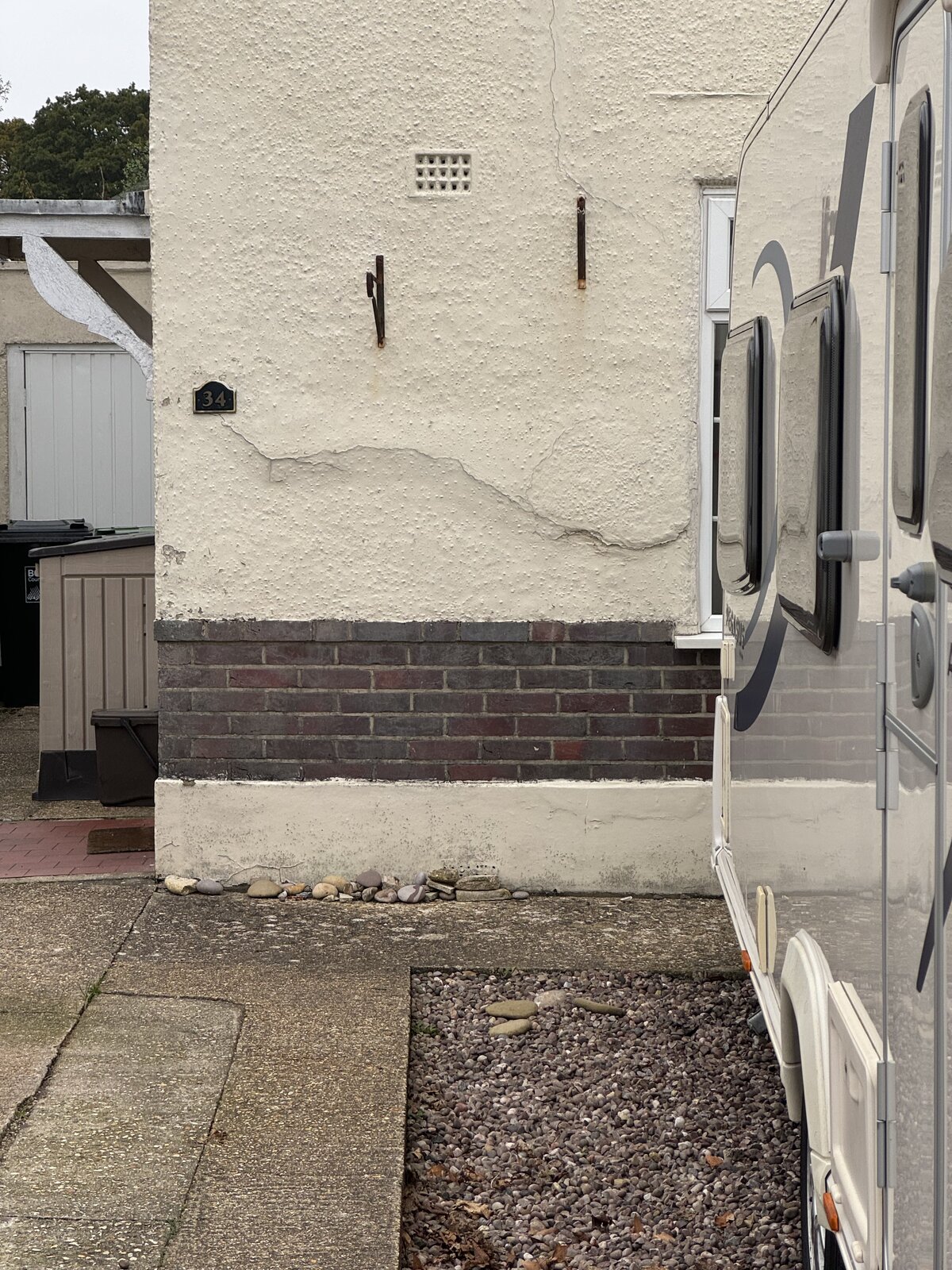

Hi I am looking to buy this house, I wanted your thoughts on this crack in the render and how serious it is, could it be subsidence?
Needs knocking off.
Have a look then. Probably just failing and needs replacing

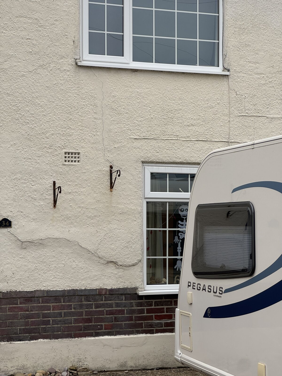

what about the smaller vertical crack on the 2nd pic?
It has been repeatedly patched up.
When you knock it off you will be able to see the brickwork and work out what has happened.
Photos of the inside wall, and if you stand back and take wider pics of the whole house, all round, may give more clues.
Alterations, removed walls, and positions of pipes and drains that may have hidden underground leaks may be relevant.
