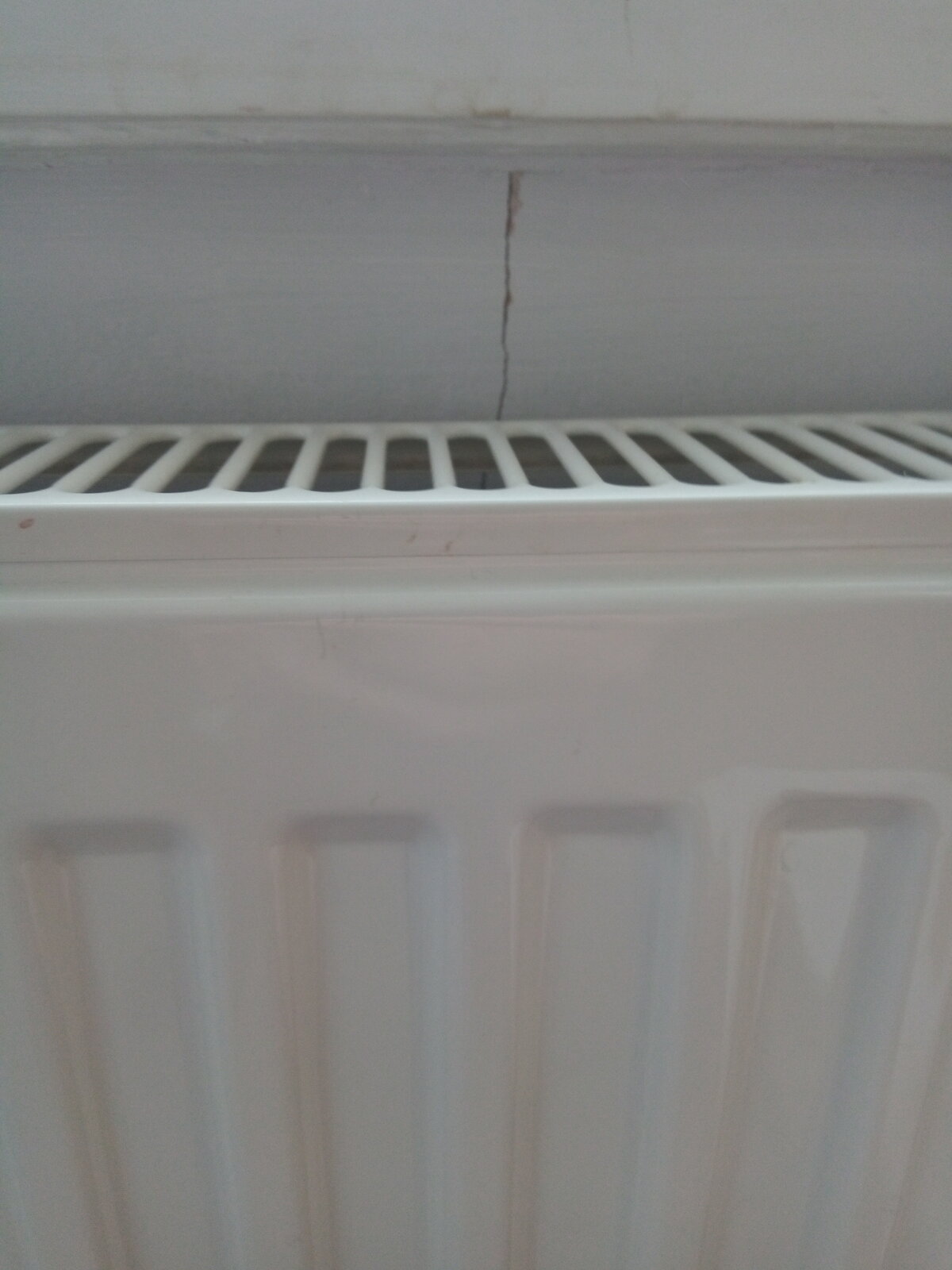

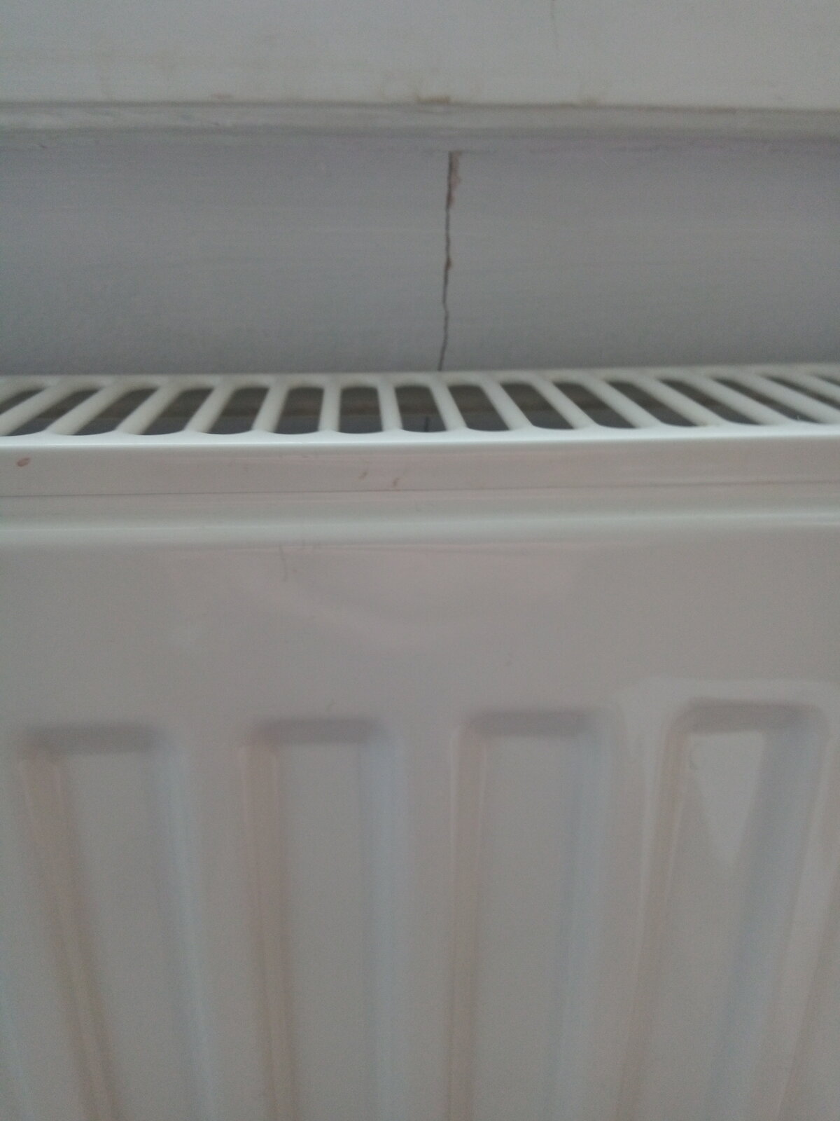

Hi,
First time poster so forgiveness required if posting in wrong section!
How worried should I be about these cracks in the walls? Had a loft done 2 years ago (I know I know, other stuff got in the way) and have seen these cracks appear. One is above bedroom doorframe on both sides (similar place) and the other below window front bedroom wall.
Advice needed before moving on to other work. Arse and elbow not familiar with each other!
Cheers
gooders73, good evening.
If no one else does Welcome to the board!!
A couple of things?
The crack appears "Vertical" indicating it may "simply" be a crack that has formed between two plasterboard sheets??
Any possibility please of more images? of the cracks both close up [as posted] and a wee bit further away??
Ken.

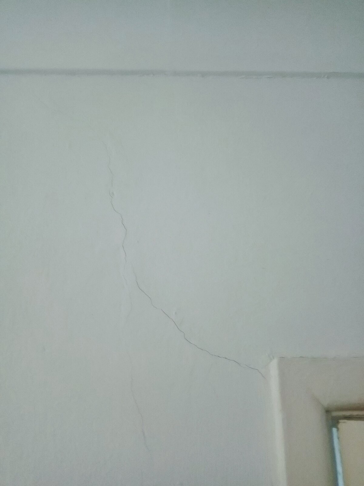

Hi Ken,
Thanks for the welcome. Here's a shot of the other crack. Has a similar but slightly thinner crack running a similar route on the other side of the wall (hard to get a clear image of that one).
Simon

Simon, good evening again.
Personally I would not be concerned by either crack.
The one behind the Rad? when you tap the wall does it sound hollow, indicating plasterboard? not the easiest place to fill, the Rad is simply in the way.
As for the second crack you posted as above, no cause for concern, as a matter of interest? on the second crack, is it appearing on the other side of the wall? As a matter of interest when was the room last decorated? such cracks can / do form if the wall was skimmed ?
Ken.
