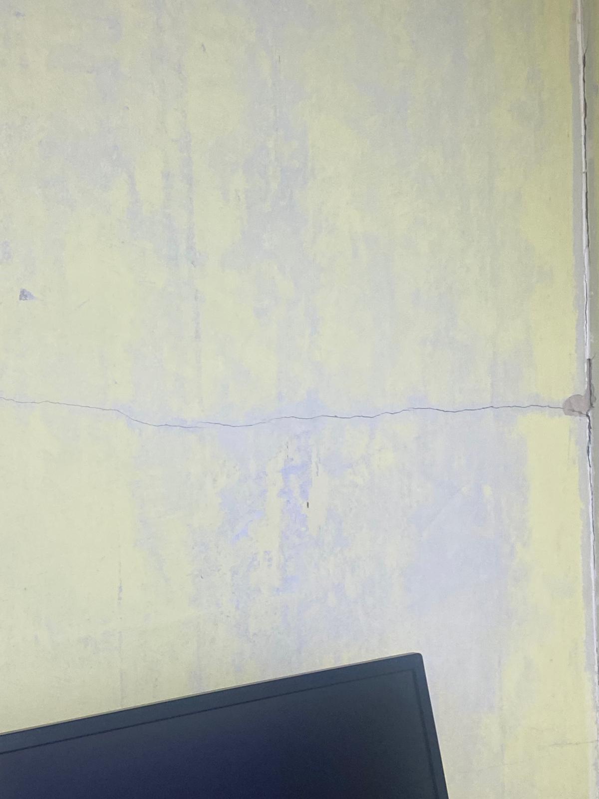

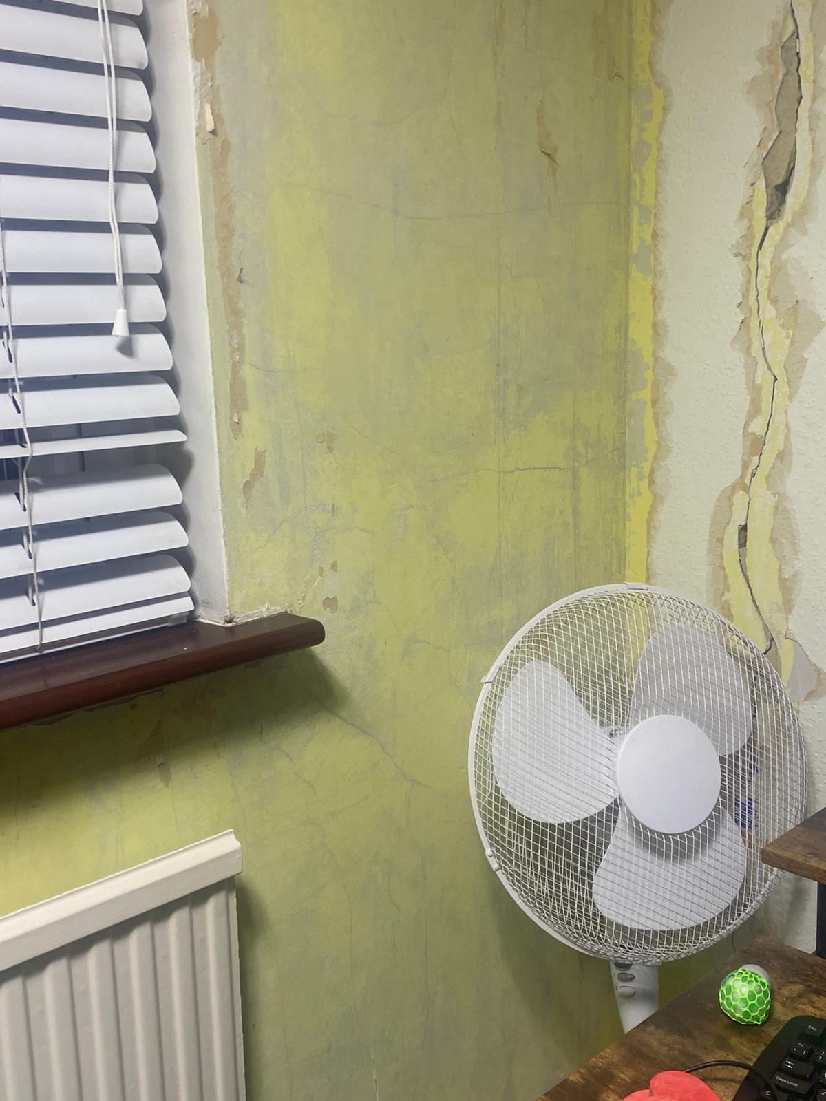

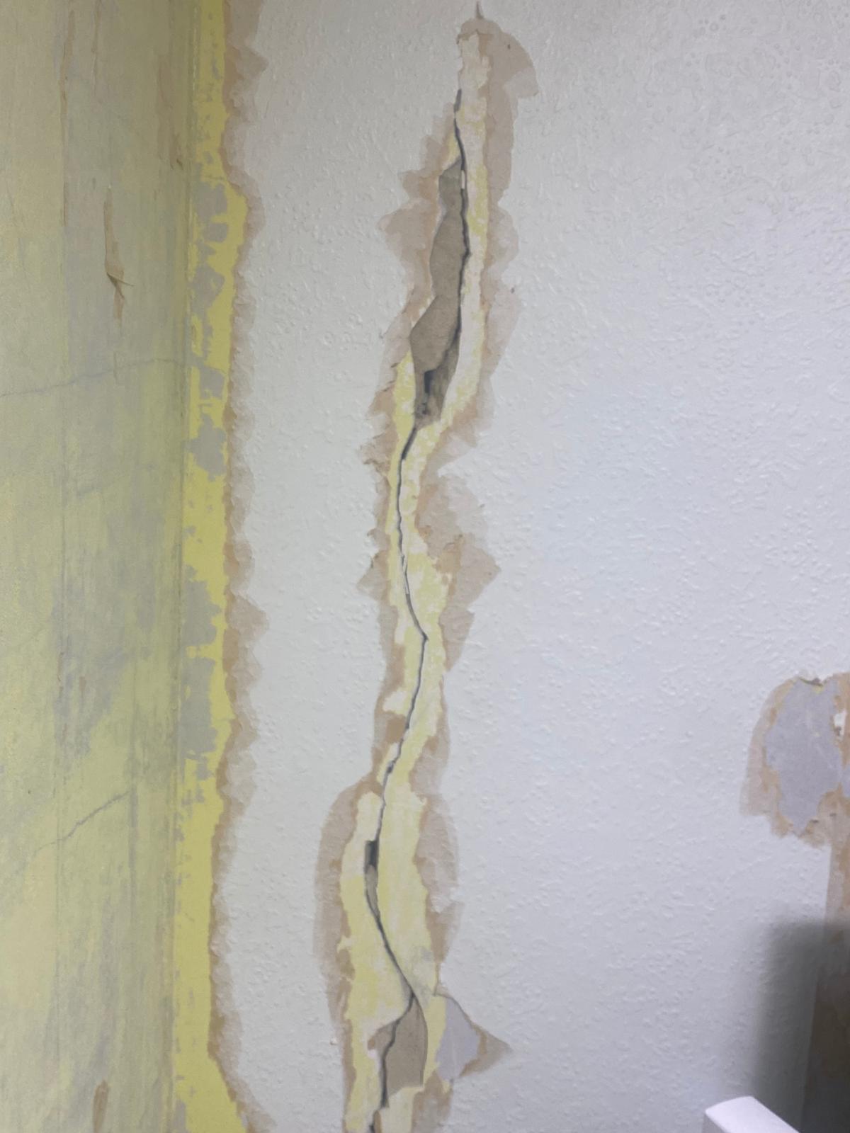

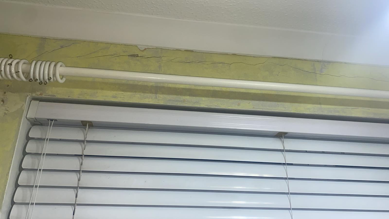

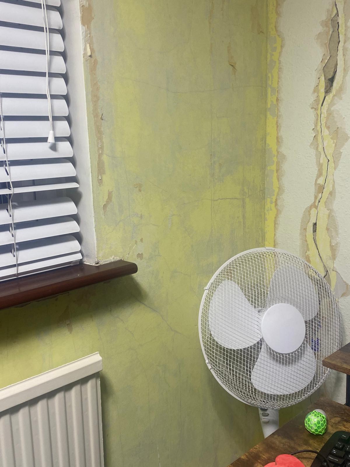

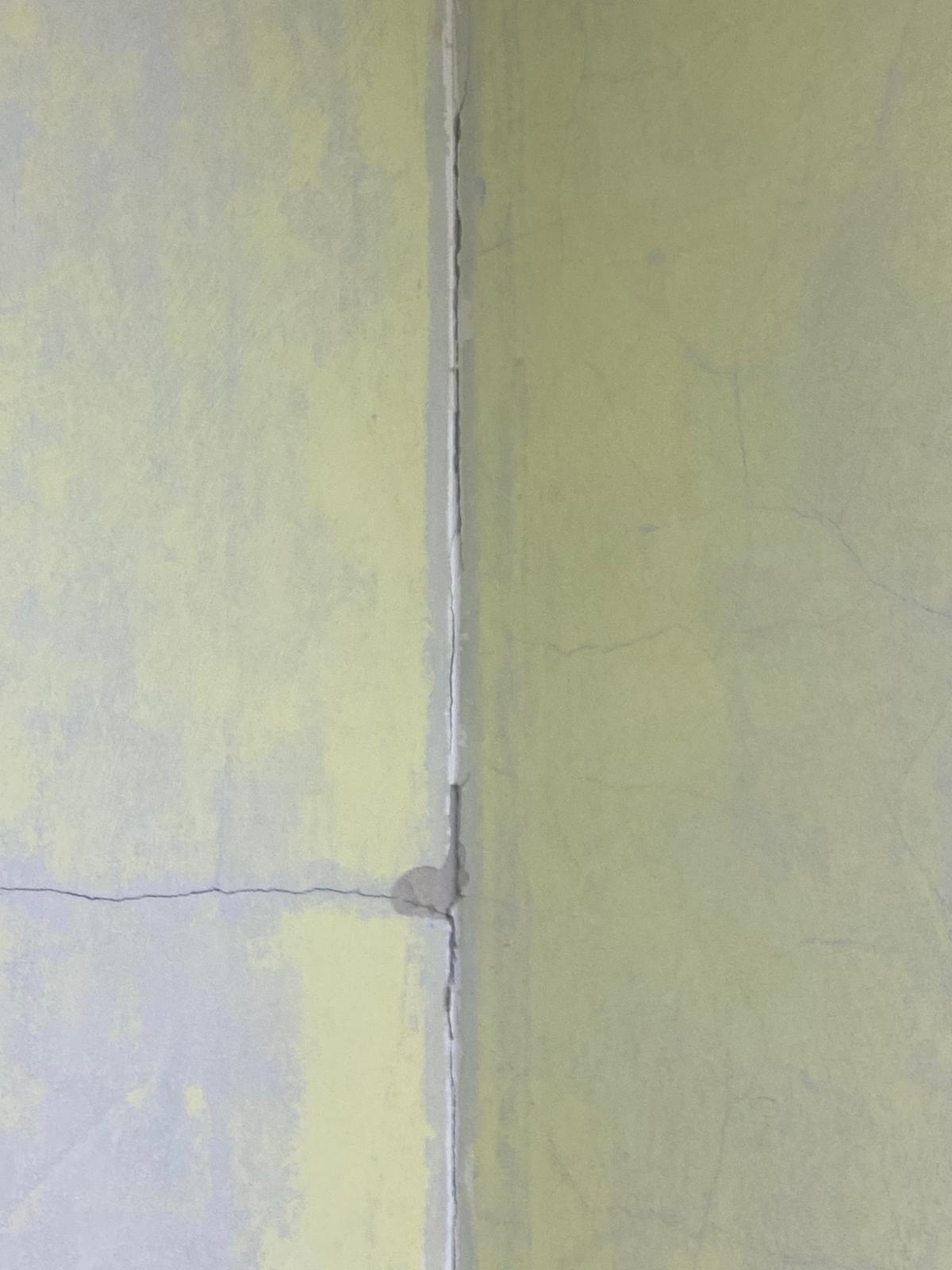

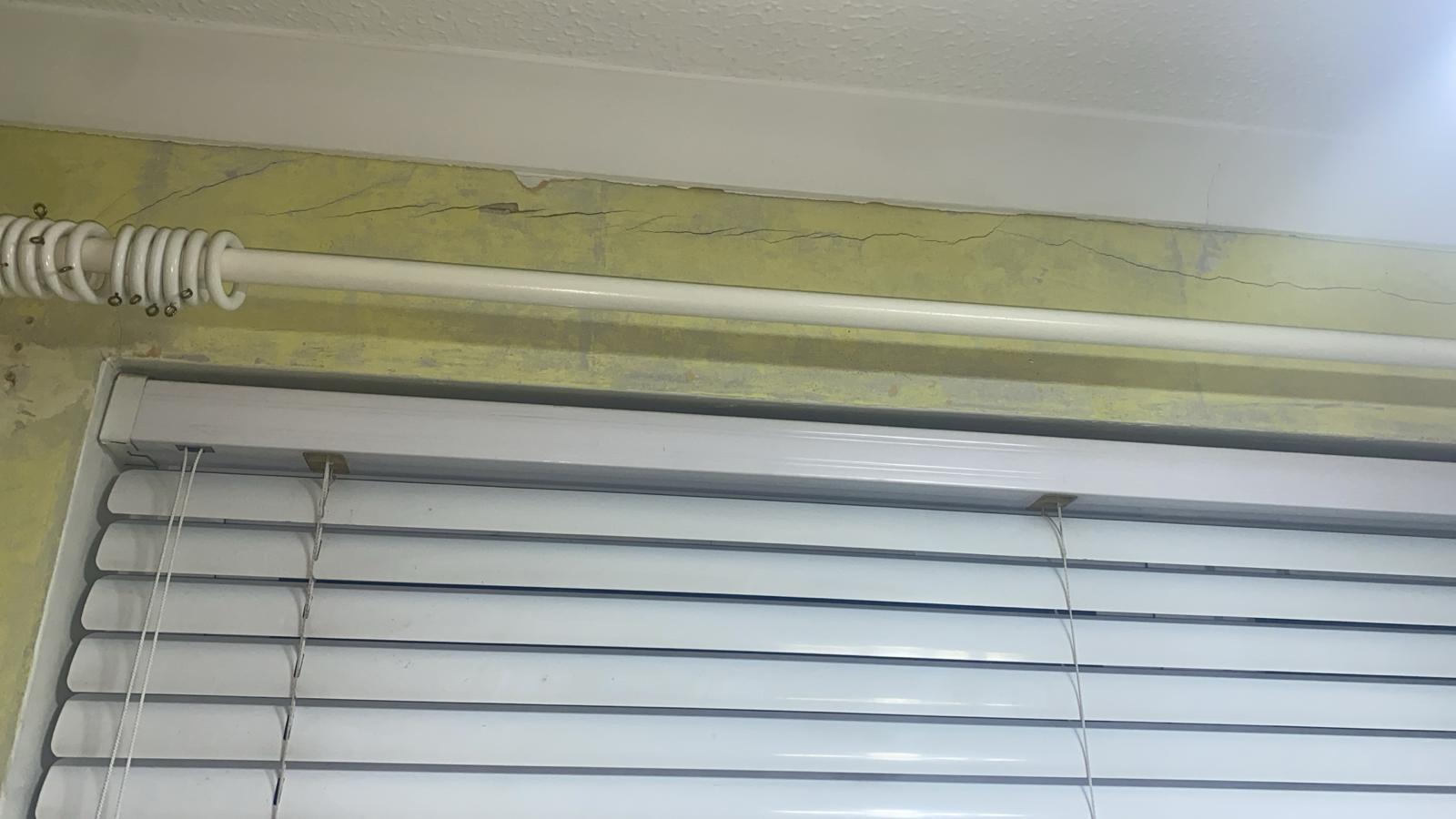

Hello,
Removed some wall paper to redecorate today, found hair line cracks on one side of wall , other wall has deep vertical crack ( this is an external wall)
Should I worry?
What trade person do I need to check / fix this?

Concrete blocks with sand and cement then plaster?
1950s to 1960s built house?
Seen plenty of cracks like that.
Though to cavity cracks I filled with bolt resin.
Then I used ready mixed bags of mortar, fill the deep cracks.
Toupret powder fill over.
As for spider web cracks. Plaster skim walls with embedded plastering mesh. I bought that in 100m long rolls that are 1m wide.
Slightly thinned coat white matt allows you to see overall state of walls
Fill as above
Cross line walls
Bobs your uncle
