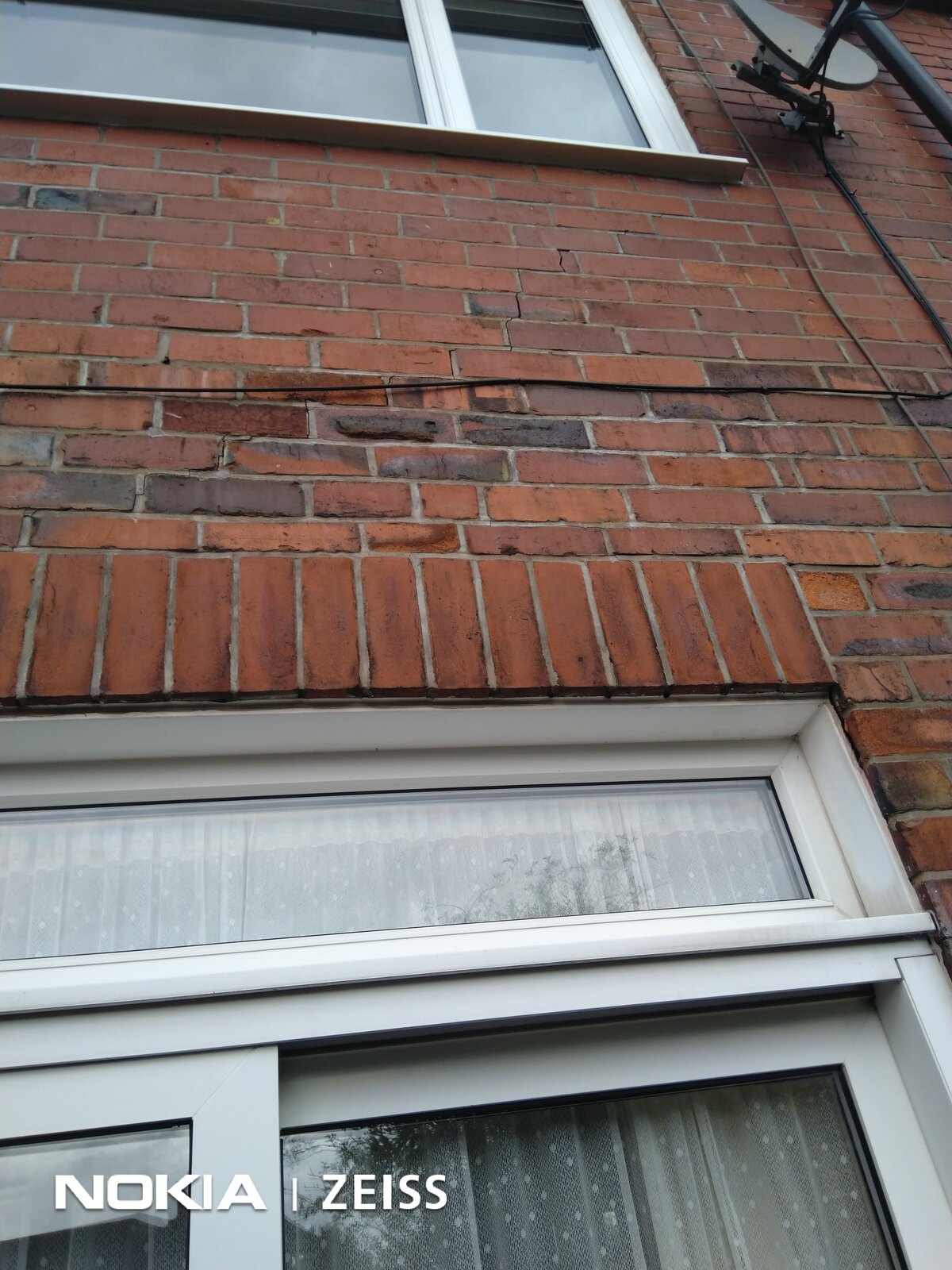

I have recently noticed some cracks above a patio door and need some advice about what I should do as I am very worried. I'm not sure how long they have been there. The house is late1940's and previous owner had patio doors put in. I have lived in the house for about 23years. I am concerned about what is causing this cracking and fear the dreaded word subsidence. Or maybe a lintel problem? Any thoughts appreciated. Thanks

Is there a proper steel over the patio door?
I'm not sure what you mean. What is a steel? Is that some kind of lintel.? I'm afraid I have to admit that I am an old widow woman and know nothing about building/constuction.
Probably more to do with the opening than subsidence, was there an opening there before the patio door where installed?
I'm guessing there was but not easy to tell from that picture and being 25yrs old.
I think it's safe to assume that there was a window there before the patio door. The other half of the semi detached still has a window. It's at the same height and same width, going off the soldier bricks. Could it be that there's no lintel, or a damaged/exhausted one?
I've seen this on a lot of ex council houses built in the 50's, originally with steel critall windows and doors which at the time were considered structural so no lintels were used.
One by one they were replaced with upvc by people not knowing that additional support was required. The house isn't going to fall down but it definitely needs attention. Get a few builders in for quotes.

Thanks for the reply. I am going to get builders in to quote. Judging from the replies I have already had I am relieved that nobody thinks it's subsidence.
