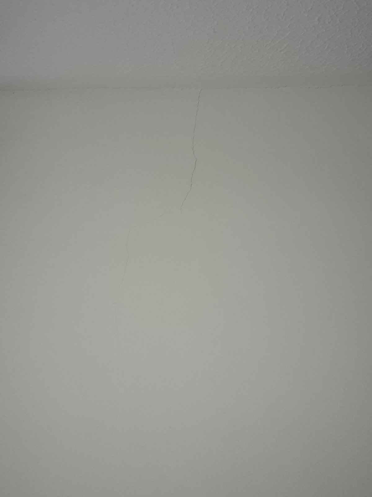

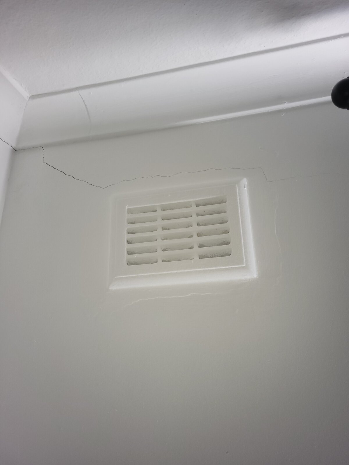

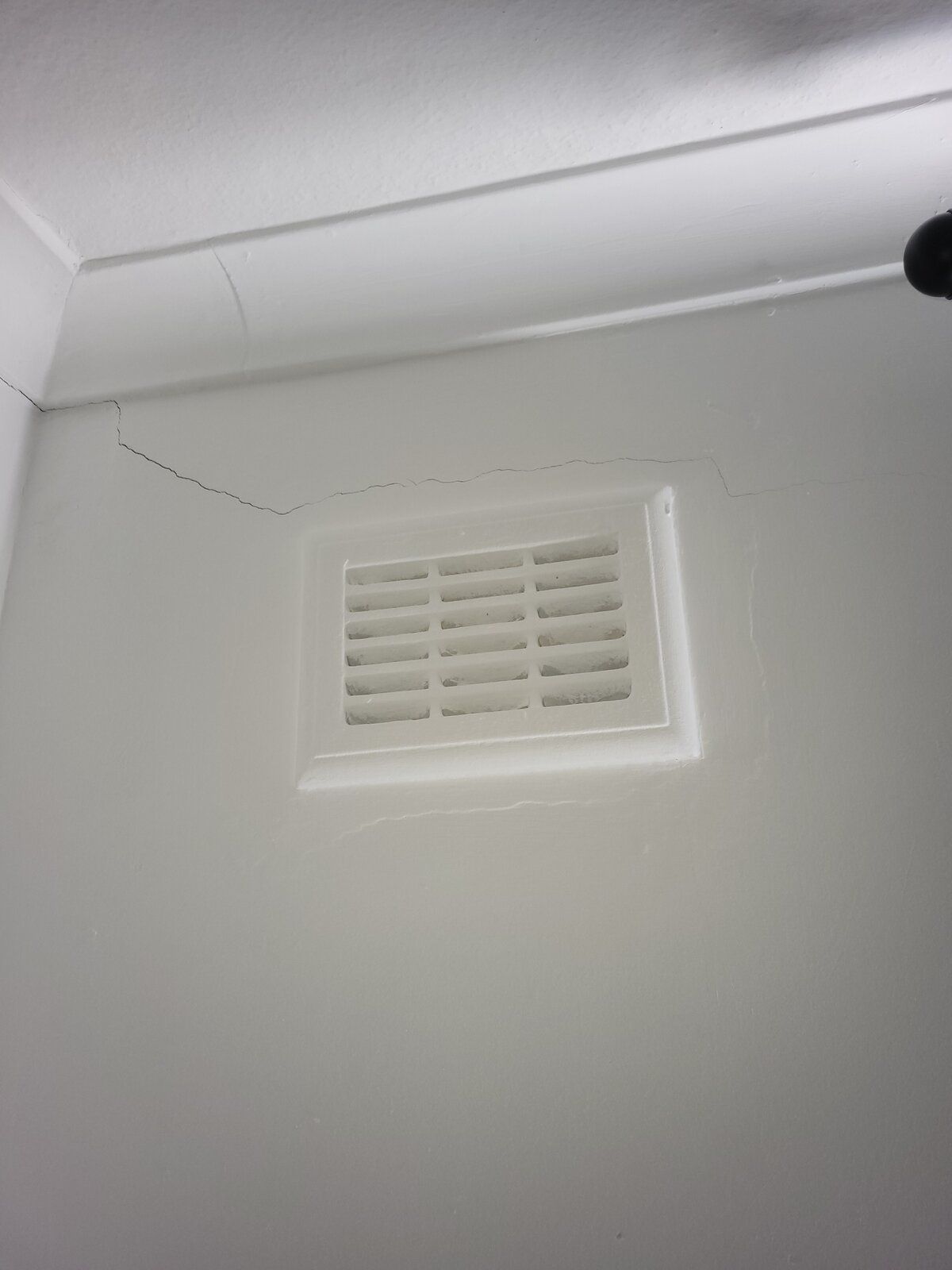

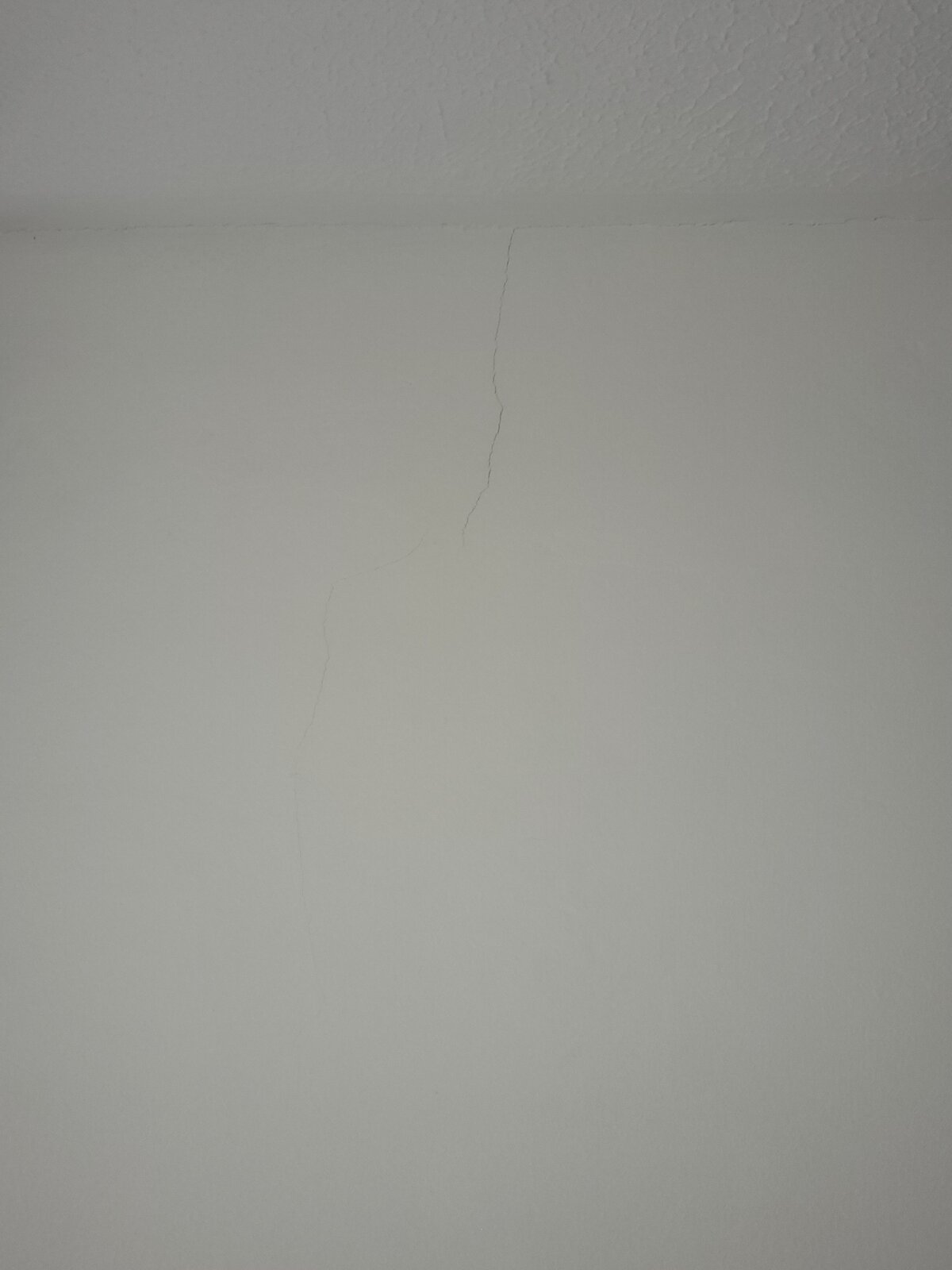

Hi all
Recently moved into a new house and wondering what people's thoughts were on these cracks on walls? They are at the upper level just below the roof.
The house was fully painted 2 weeks ago and either they appeared since or were there before and the paint didn't cover them. Or the paint did and then they reappeared?
Seems like it's brick wall on both pics.
The picture without the vent you can feel it's just a unlevel Plastering but the vent picture feels a bit more level in some places but a little bumpy over the line in others?
Hope nothing to be worried about.
Not indicative of structural cracking.
If you paid for the painting, then you would expect cracks to be filled. You can see if there is paint in the cracks to determine if they were there before the painting.
Common for cracks in the corner of the property.
I guess that's the corner?.
The air vent isn't helping.
Maybe look to remove the vent and fill.
I don't think it's anything to worry about
