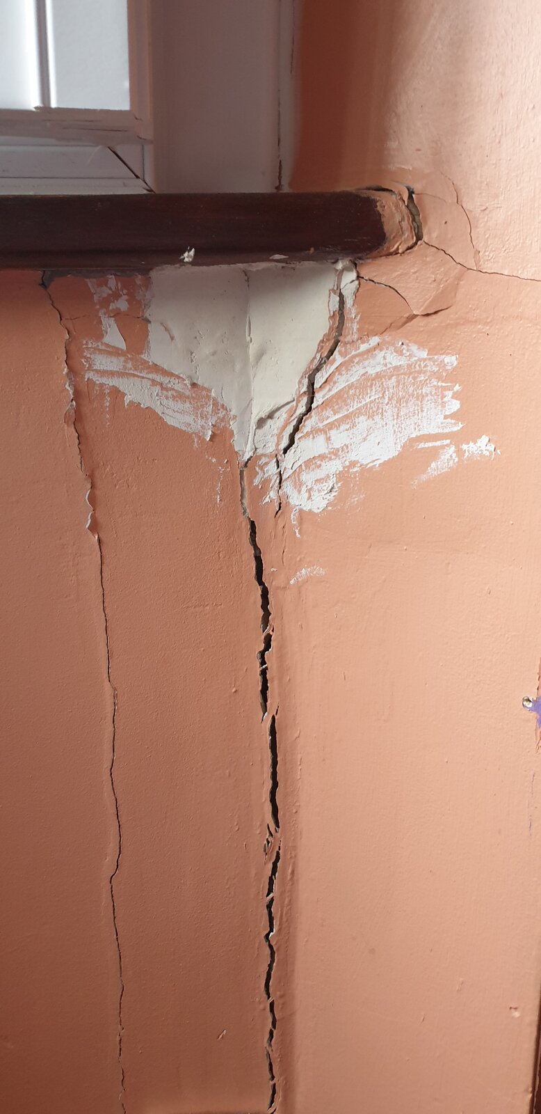

I had some new double glazing installed all around our 3 bed house. And shortly after the installation very small cracks had appeared in the plaster under both sides of my upstairs bay window. This bay window sits over an identical bay window below it.
I didn't pay it too much attention as I thought it might be more superficial than serious as it was only a hairline crack and I figured I would be able to use a simple filler to have it looking good again.
Over the last month or so we've had a few hot days and I've noticed the crack has expanded little by little.
A few days ago we had a few very hot days, and the cracks are what you see in the photos now.
I can actually see daylight behind the bigger cracks, so it seems the cracks have gone through all the way to the outside. And this was confirmed when I noticed hairline cracks in my outside render. Now this worried me so I used a very small amount of polyfilla on the out side crack just to stop the ingress of water should it rain. I didn't want any bigger problems!

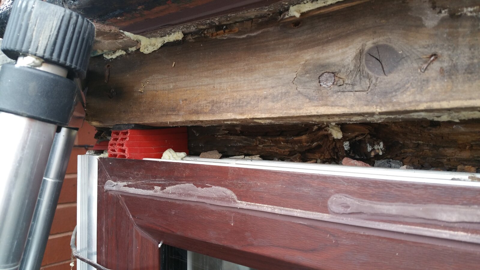

Basically your upstairs bay has dropped, pvc bay windows are not structural, they cannot support the bricks above nevermind the upstairs bay, any reputable company would fit bay jacks to the downstairs bay in each corner post, these are like little acro's you use to support a house wall when removing bricks or fitting a lintel, first you need to check if bay jacks were fitted if not then you have big problems

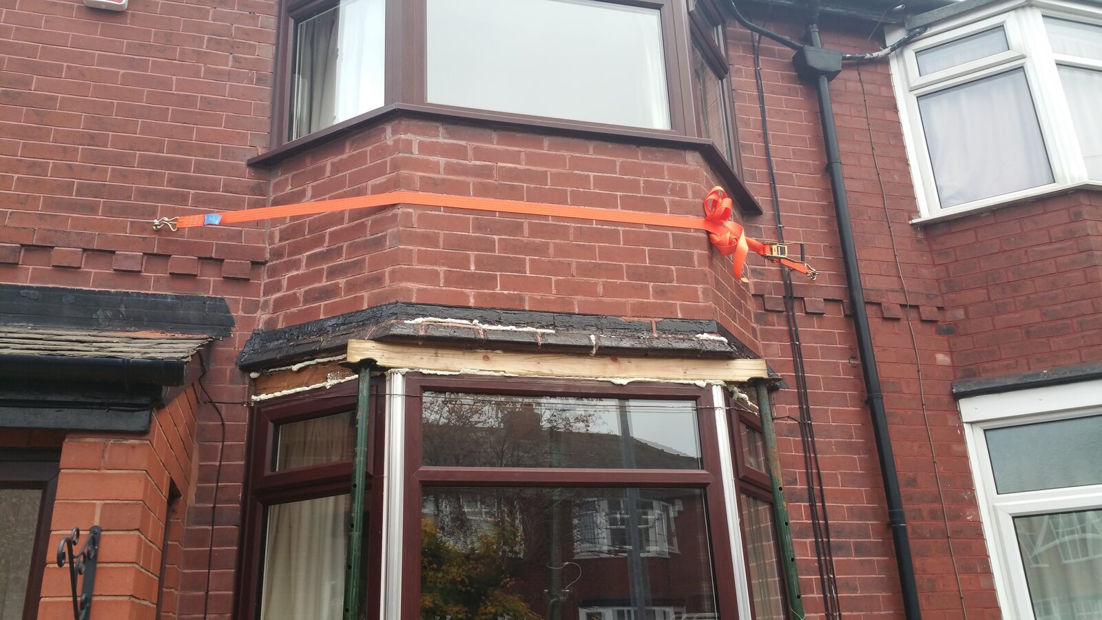

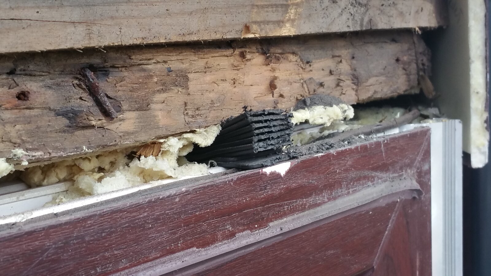

Here's a bay window I was called to to inspect for an insurance company, I found the brick work falling away from the house so had to quickly cobble together a fix until proper works could be arranged, the gap between the top of the frame and the rotten lintel is shocking, see how the weight of the bricks has compressed the packers, the brick work should not be touching the frame anywhere apart from the corner posts between each segment and the posts should be jacked up to take the weight off the window, you have clearly got a gap above the downstairs bay that the brickwork is sinking in to, eventually it could potentially fall away from the house
