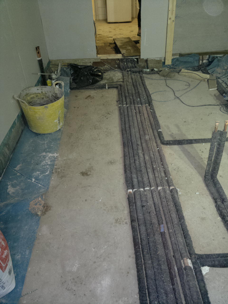

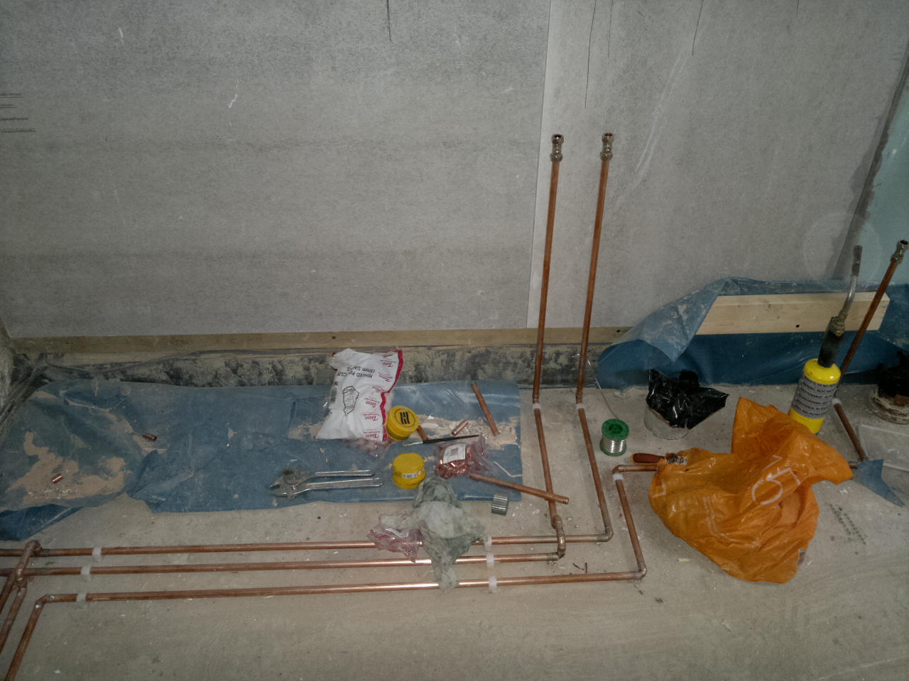

I have UFH in a 65/75mm screed, this sits ontop of 75mm PIR.
Running through the 75mm PIR (in cut channels) are 22mm copper pipes - which I need to gain access to.
I don't want to create a nightmare, am hoping nimble use of an angle grinder will alllow me to slice up the screed into thin slices so i can chip it away ... anyone have any experiences of such remedial works under UFH.
I understand the plastic can be repaired if accidentally cut, using a 'repair coupler' and self amalgamating rubber tape. The pipe is: JG Layflat polybutylene pipe.
