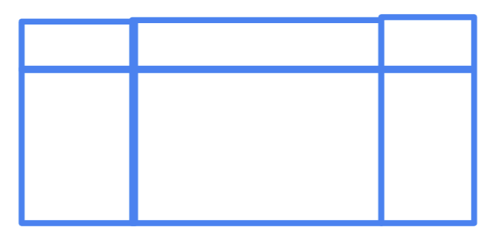

We have some large windows, I don't know what you call them but basically like this:
They are south facing and let a lot of heat in during the summer. We are having them replaced and looking for good options to keep the heat out.
They are a bit large for outside shutters, unless anyone knows of any clever solutions. Integral blinds seem like the next best thing. Are they any good?
When I lived in the Netherlands we had sun awnings on all our windows (often called patio awnings in the UK) - they are very common in the Benelux. They look a bit like a modern version of the old shop awnings and are very effective, not to mention being available in wider sizes - up to 5 metres (the biggest I had to replace was that size). Maybe worth a quick Google?

The best options reflect the solar energy, before it even gets inside.
If you can live with some slight reduction in light levels, specify your new windows with a solar coating.
Brise Soleil also work brilliantly, they made a huge difference when installed on one of our south facing buildings at work.

Thanks, I was thinking the same thing. It's best to reflect the energy before it enters the house.
Integrated blinds are half way to doing that. I was thinking of getting some UV cut film to protect some stuff inside anyway, but an external coating should be even better.
