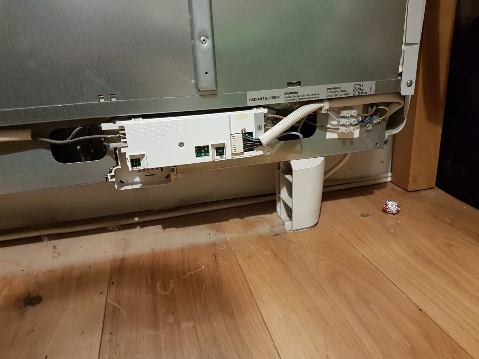

Opened the heater up. Would the thermostat be housed in this unit?
Could it be the switch it's wired into? I have a multimeter, what would I be testing, other than power coming to the switch?

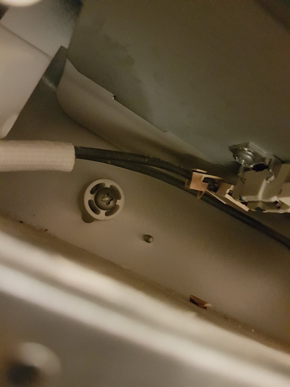

Top left of the heater, looks like one of the connectors has browned a bit, burn marks?20191230_075206.jpg
Connector is very brittle and started to break apart when I touched it. The wiring appears to be intact though.
