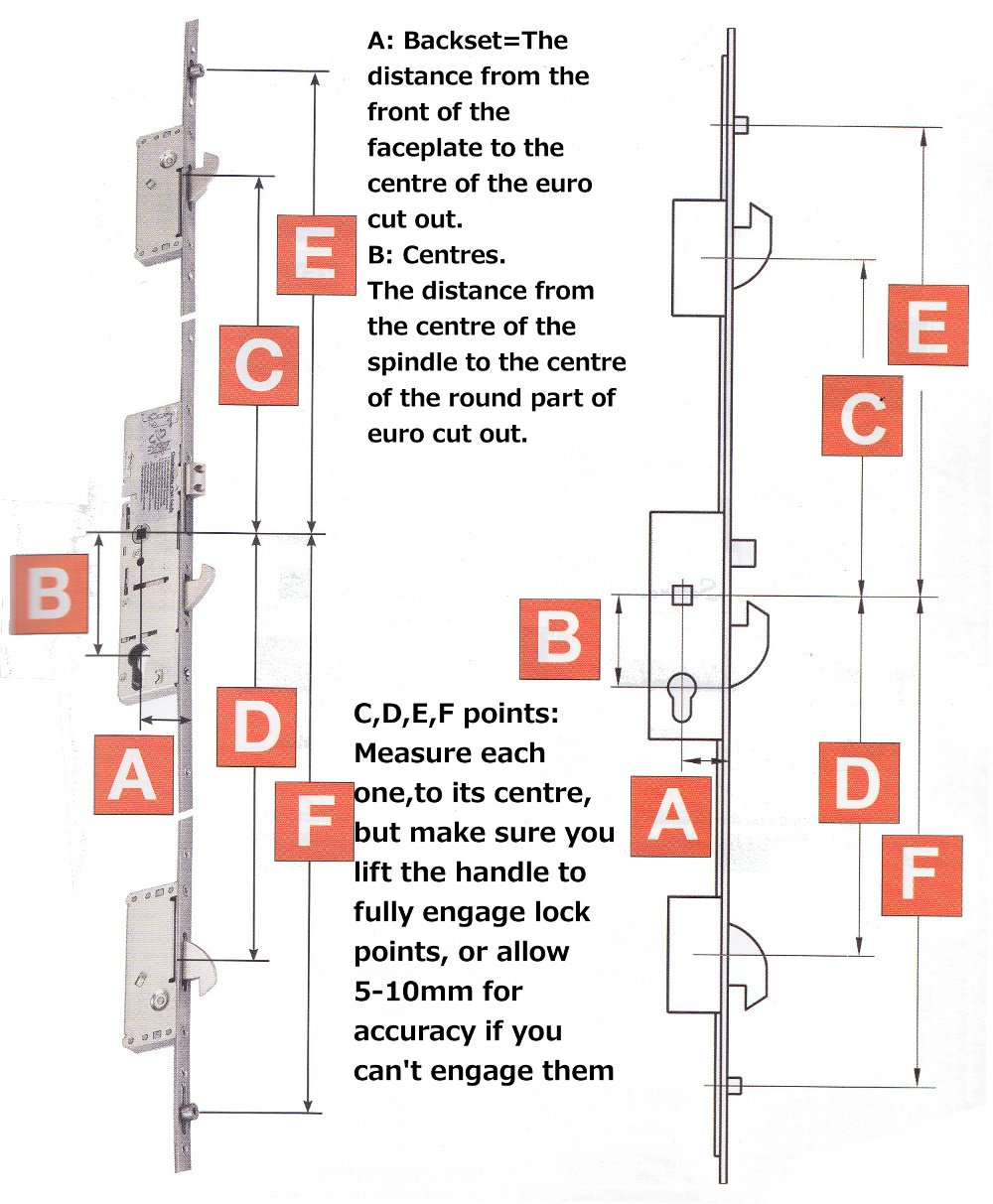

No, a 5 point of contact dead lock. Not a latch. A good locksmith will be able to open most locks but if these are locked properly and not just on the latch you won't open it through the letterbox.
Cool, thanks. Neighbour must've not locked it properly then because that looks pretty much like the lock she has. They also are a pain to line up and fit? Because she had trouble too with the key not turning and jamming where the door moved. Composite door, wooden door frame.

Any door with an inside handle or knob that can be turned to open the door, with no key, can be opened through the letterbox or a broken glass. There are various simple, home made tools to do it. The old yale-type nightlatches were particularly easy, but had other vulnerabilities as well. More modern BS3621 locks can be deadlocked, though this is not often done when the house is occupied.
If you can, it's a good idea to have the letterbox in the wall near the door, on the hinge side, and with a cage to make this less easy than it will be with a handy access hatch in the door itself.
