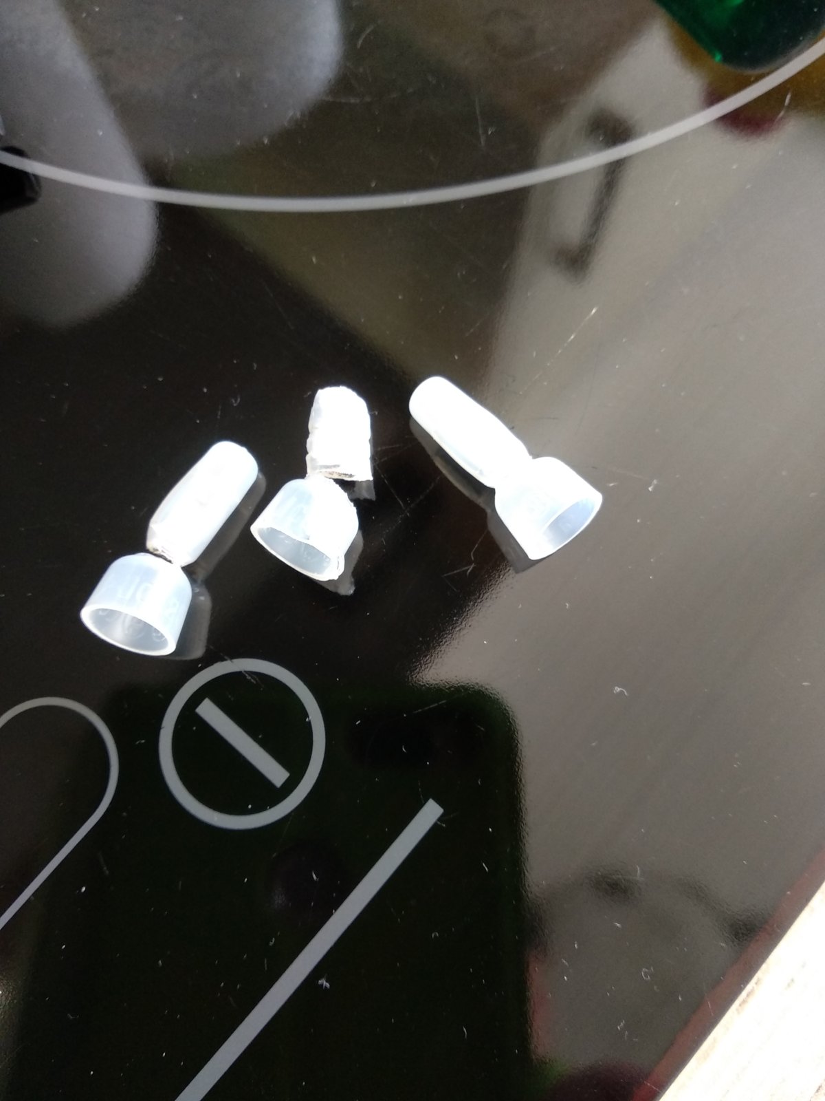

I am replacing kinked iron cable.
Crimps joining power lead inside iron look like this.
Anyone suggest where to get these or alternative?
Yeah solder inside something that gets really hot seems like a great idea. I wonder why the manufacturers who know how to design their products didn’t do that.
Well stop wondering and learn about mass production techniques and cost saving.
Consider that tungsten light bulbs have their connections soldered to the base contacts.
Irons run at a temperature below the melting point of solder.

I think you'll find they don't use lead any more!
They don't, but I think you'll find that the common lead-free has about the same melting point as 60/40 Sn/Pb - which was the first quote I came across in haste. However, if we're being fussy, I'll look it up ........
... The most commonly used lead-free alloy, Sn96.5 Ag3.0 Cu0.5, commonly referred to as SAC 305, has a melting point of 422°F (217°C) to 428°F (220°C).
... so, a bit higher that 60/40 Sn/Pb, but still 'uncomfortable' in the context of an iron!
