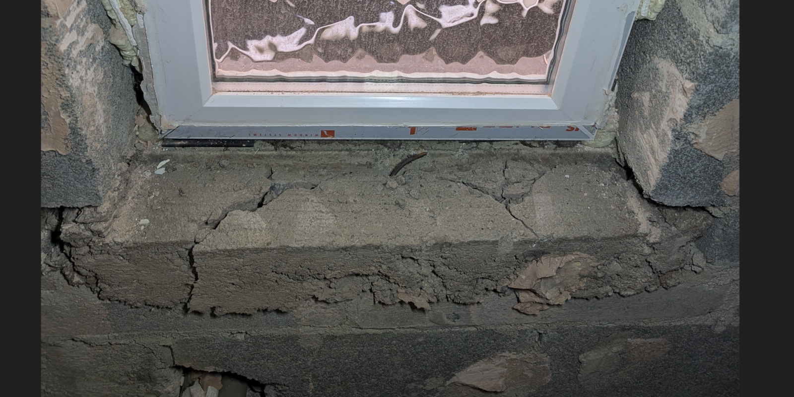

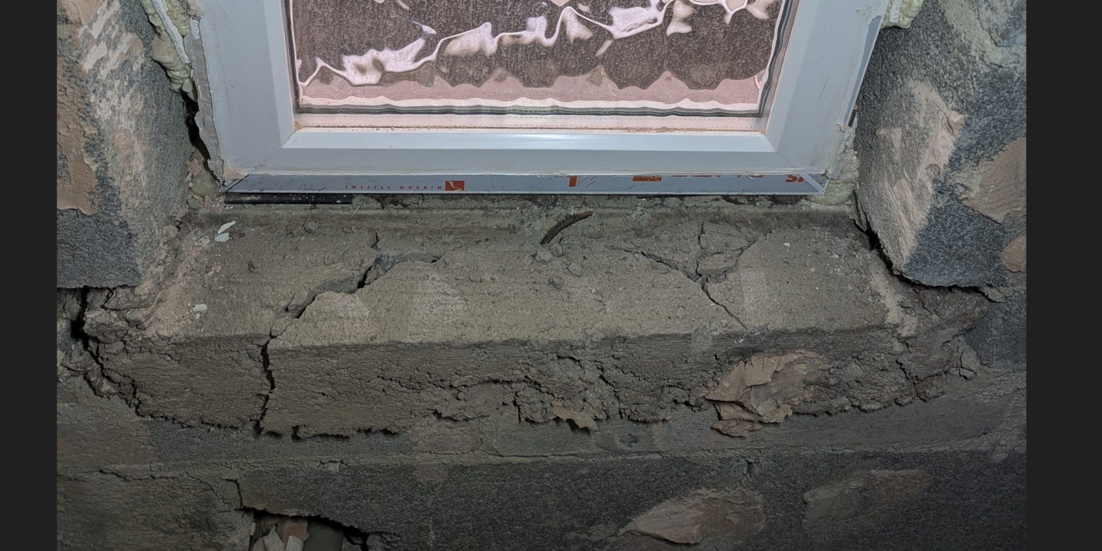

I'm gutting the understairs WC and I removed the internal wood sill to find a build up of concrete underneath that's crumbling and will pull away with zero effort.
Not sure how to deal with it, should I just remove it and build it up with fresh concrete? It's roughly 720mm x 120mm x 100mm, would that need rebar?
Should I lay a couple of blocks instead? (I don't know why that wasn't done in the first place...)
I plan to dot & dab the wall, could I do the build up with that instead?
Thanks in advance!

I'd knock off that loose masonry.
Cut thermalite blocks with hand saw to fit.
Cement on
OP,
Your using blocks idea is the way to go but first clear out all perished material, & then consider what the finished surface level will be using eg. tile, window board etc. & work up to that as a benchmark.
As you're building up from nothing, it's a good opportunity to get some insulation in, e.g. a few layers of tile backer board or PIR sheet. Then the room will stay warmer and you won't get condensation on it, as often happens with bathroom window sills.

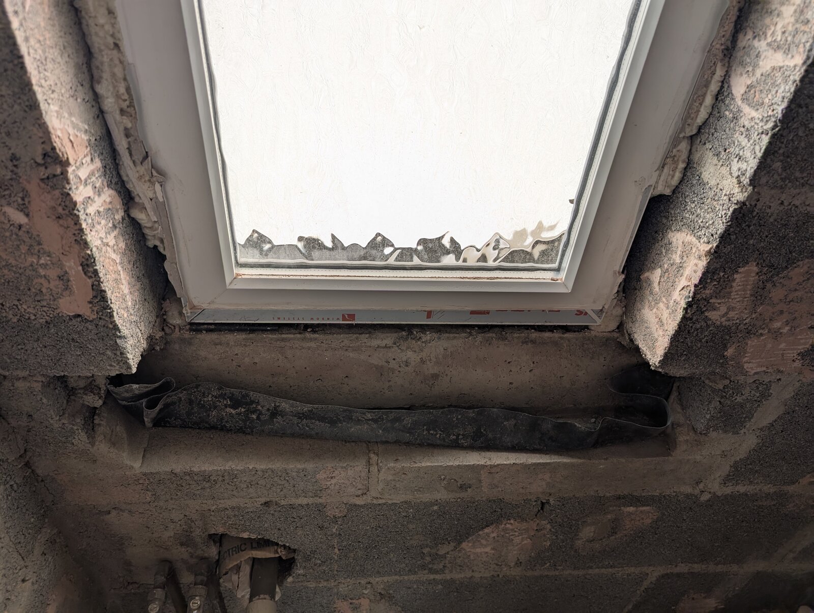

Thanks again for all the responses. Noted about the PIR.
I've removed the material that is there. I see that the concrete sill the window is sitting on in not actually flat. The void is about 100mm deep at the top but only about 65mm at the bottom.
I guess that makes things a little awkward? Probably why they filled it with concrete in the first place.
