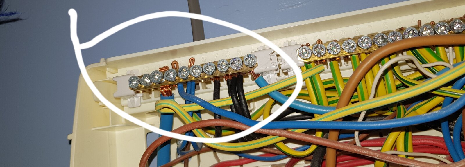

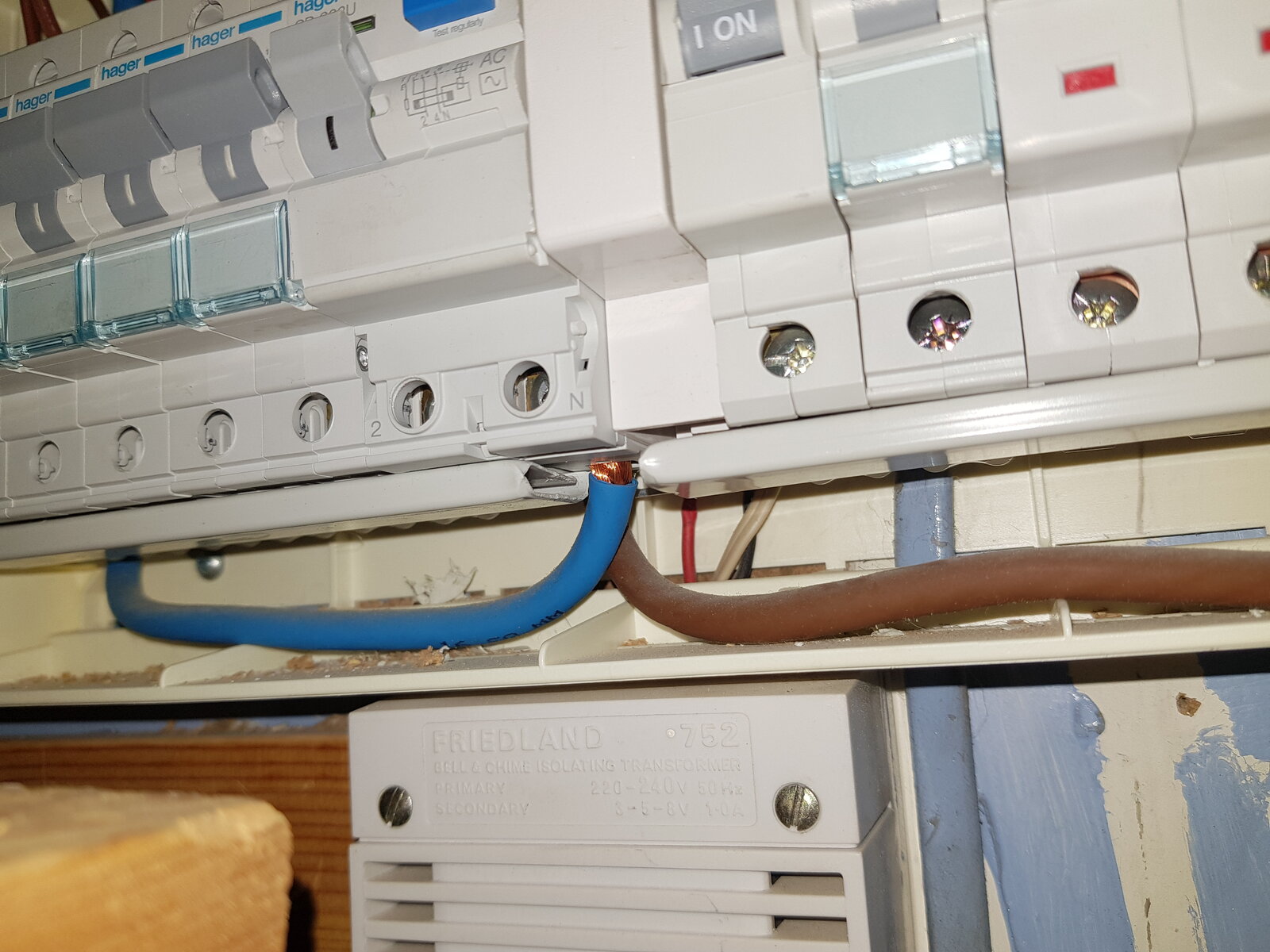

Hi. I recently moved into my house and had the CU open today. It is a split with one side protected by RCD, and the other half not (although this side has RCBOs). Noticed on the RCD circuit side, that there isnt a copper bar from RCD to each individual circuit on the load side. There is a separate neutral bar for RCD circuits though. Circuits on RCD side also trip when I press the Test button on RCD, so I assume everything is fine? Just always used to seeing the copper bar so was just looking for guidance. Cheers
Photos attached

Looking at your pictures it looks to me like there is a bar from the RCD to the RCD side breakers, but you can't see the copper because there is a plastic cover over it.

Am i the only one confused, the post title mentions the Neutral bar?, the plastic covered bar is the Live bar, there should be a 2nd Neutral bar at the top where each of the Rcbo Neutral leads connect into.
The Neutral bar in your picture is connected to the Neutral output of the RCD by the fat blue wire and only for the MCB circuits.

The Live bars are often like this, but can vary like yours.
It could be that it is the function/significance of that 'fat blue wire' that is what the OP is missing.
It's also possible that he was expecting to see separate neutrals for each RCD, as for the RCBOs?

Yep, I'm being an idiot. Meant to say Live Bar. It was a long day yesterday :sleep: thanks for your replies, appreciated.
My little experience with domestic wiring I've only seen the big chunky copper bar linking the breakers together, but obviously this has a smaller one under the plastic bit in the photo.
