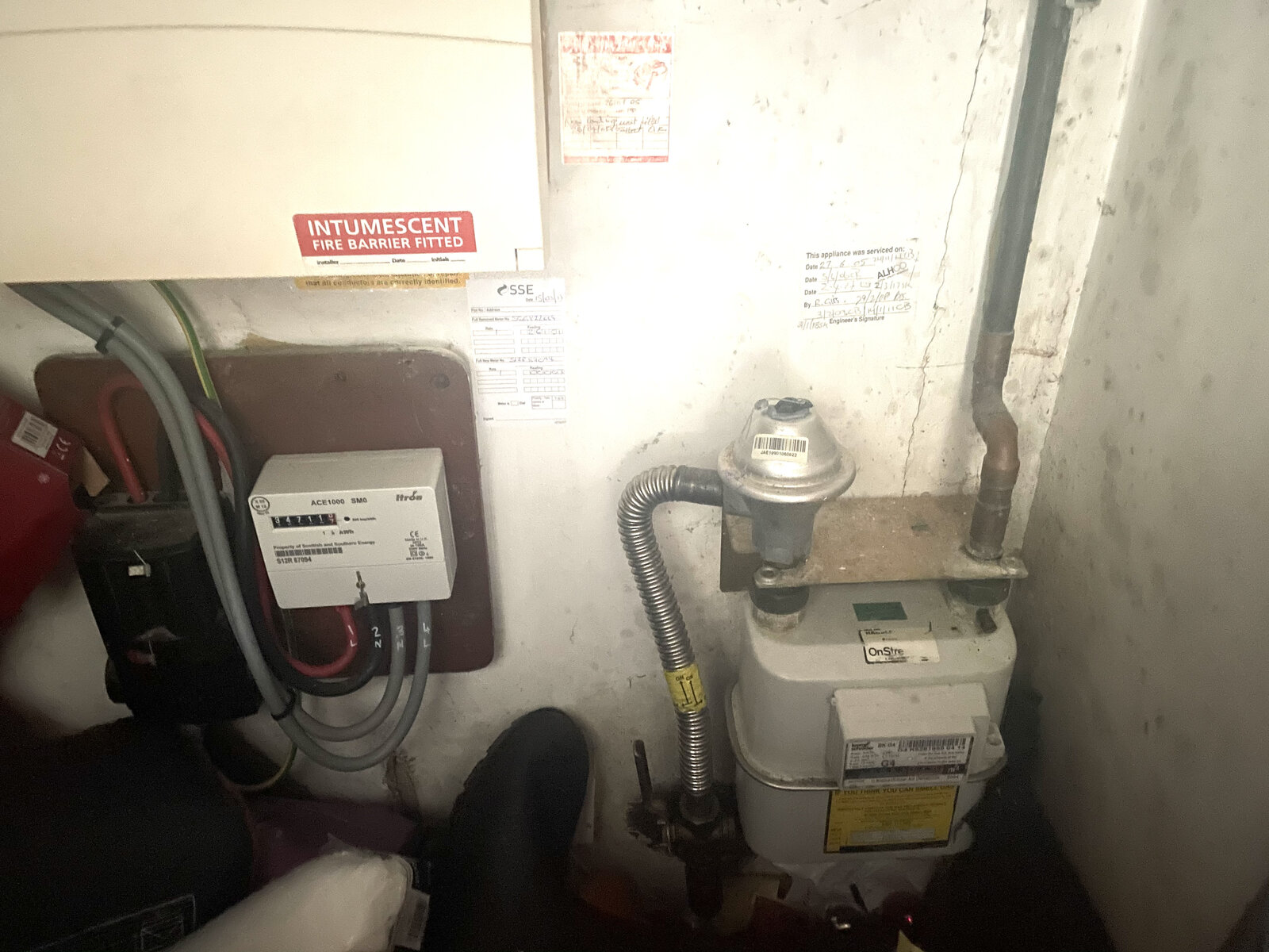

I have a cupboard under the stairs that has the gas and electricity meters, the trip switch board and the gas cut off valve. I was hoping to turn this into a sensory den for my autistic son. Can I do this or would it be too dangerous with the gas valve etc?

I would suggest that is potentially a very dangerous idea, unless the items you mention are segregated and made inaccessible to small fingers.

Any boxing in would need to allow some ventilation of the meter area. Apart from emergencies, access would be needed for reading the meters too. Careful thought would have to be given to panel securing methods which allowed you or service personnel easy meter access but which would prevent access by your son.

No, the electrical items can be just as dangerous if not more so, aside from the risk of them turning MCB's off at a crucial moment.
