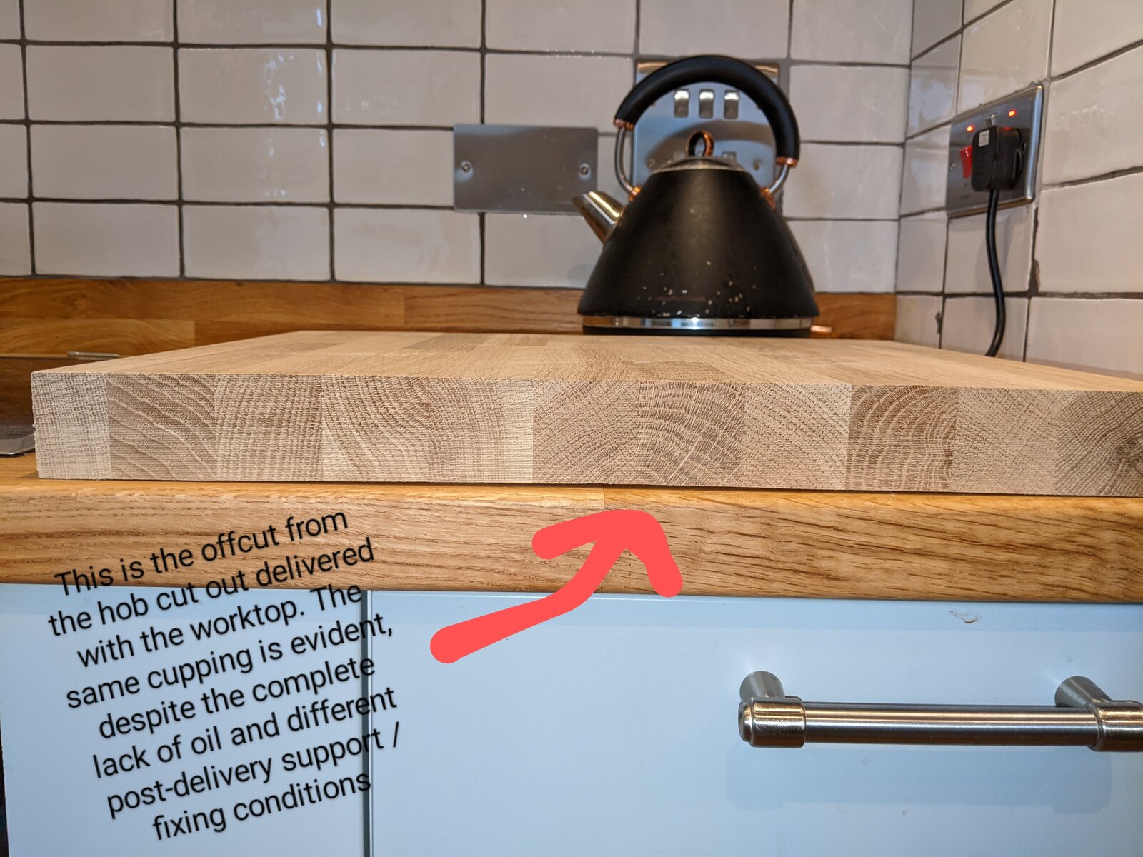

Stored for a week on with its long edge on the floor but held vertical rather than 'leaning' (that's why I didn't think it would bend either way), stored in the kitchen kept at same temperature and dryness as any normal kitchen. Noticed the cupping after oiling it about a week after installing but thinking it was always cupped since the cut out has the same shape despite no oil and not stored the same as the worktop on receipt.

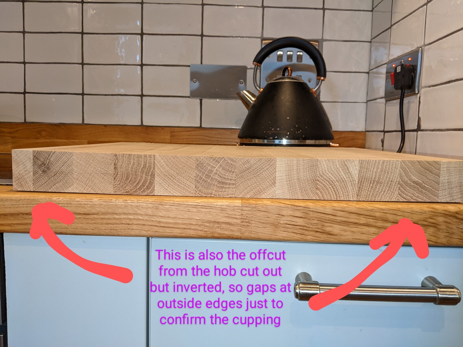

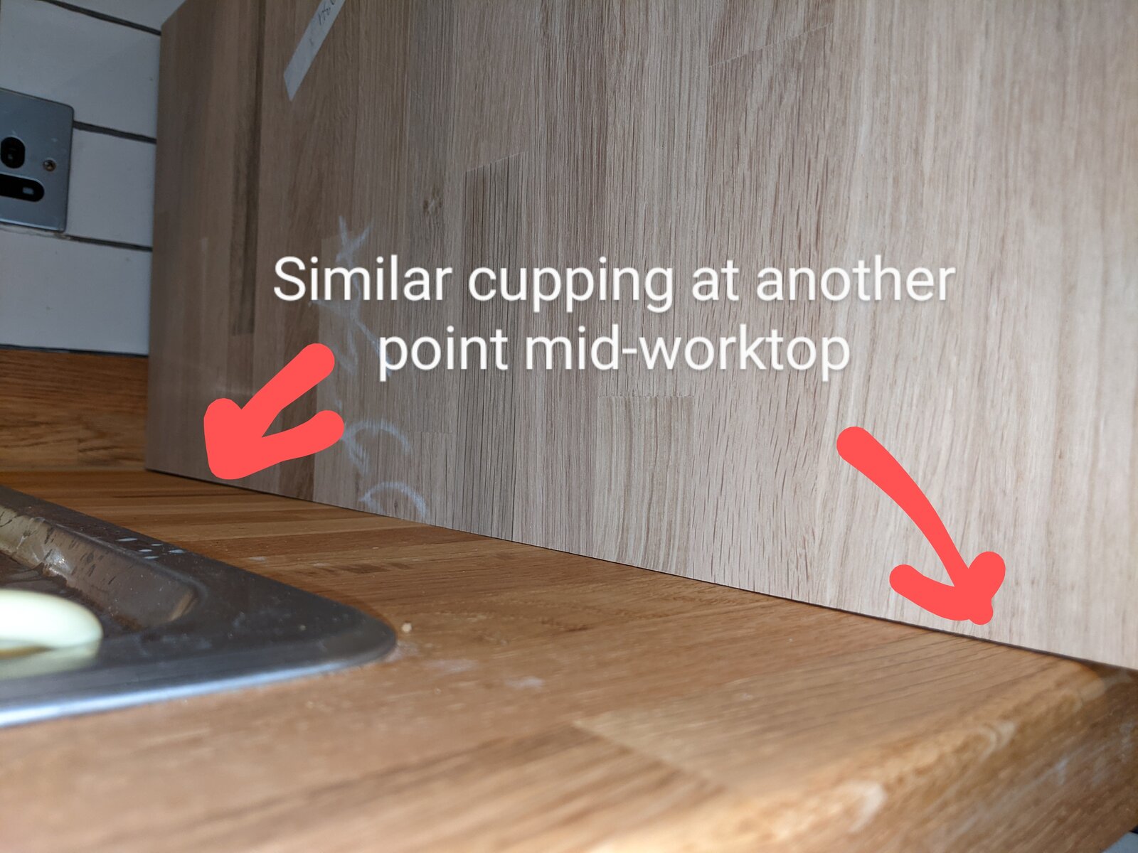

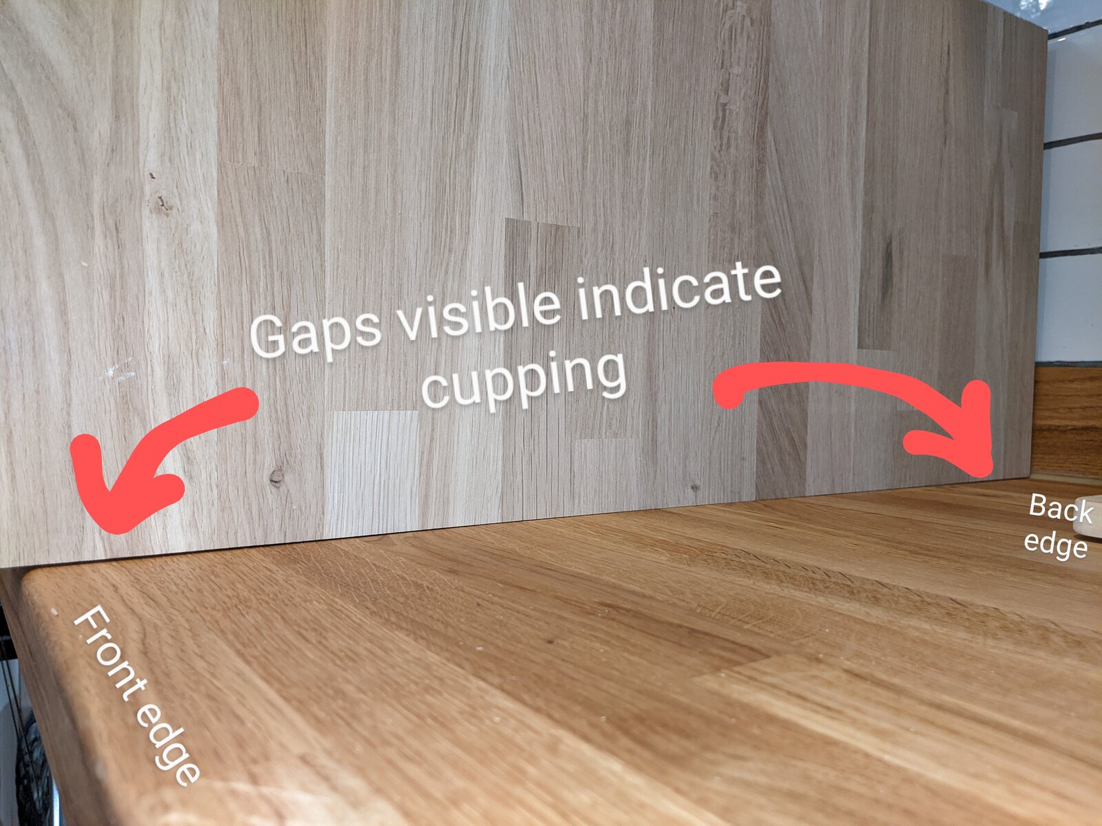

We are talking about 2-3mm difference in level from the middle of the worktop to the front and back edges... Is that within typical tolerances? Only my AEG hob doesn't seem to have any ability to conform to a slightly curved surface / any fixings to pull it down tighter onto the top.
See attached pics

Well, fortunately it isn't as terrible as all that. TBH I think the suppliers coiuld have done a bit better, but now it is in maybe the best thing would be to deal with it in situ. I think that can be taken out with a combination of trying plane, jack plane and belt sander by a competent joiner. I've dealt with worse. How is it fixed to the units? Buttons or some other way?
It's screwed to some existing IKEA cabinets which have slotted holes (slotted perpendicular to length of worktop which is what supplier recommended) and just supports it at the front and back edges so should in theory have the freedom to uncup in situ.
It may settle down in use, but i somehow doubt it. The slotted holes are to allow the wood do move in service (natural wood expands and contracts - chipboard/MFC don't so you need to take this into account). At least it isn't the installation adding to your problems
