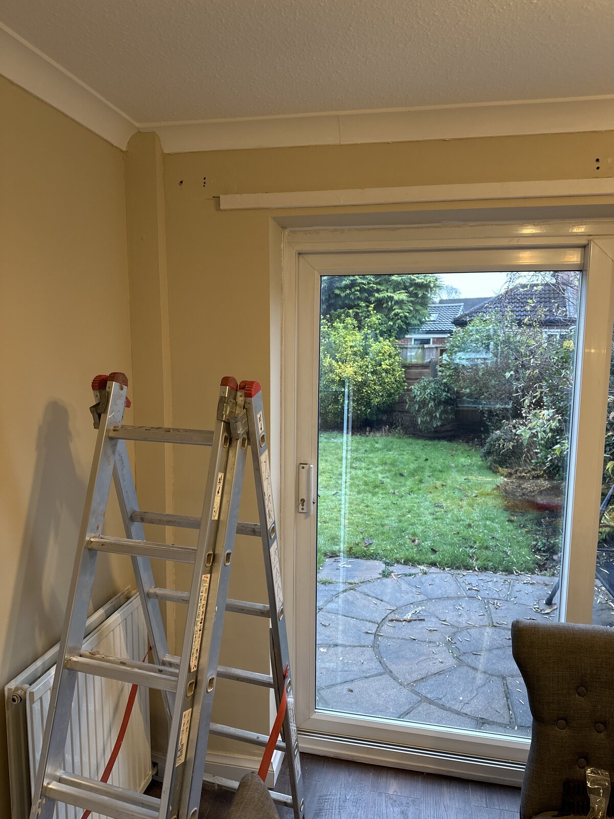

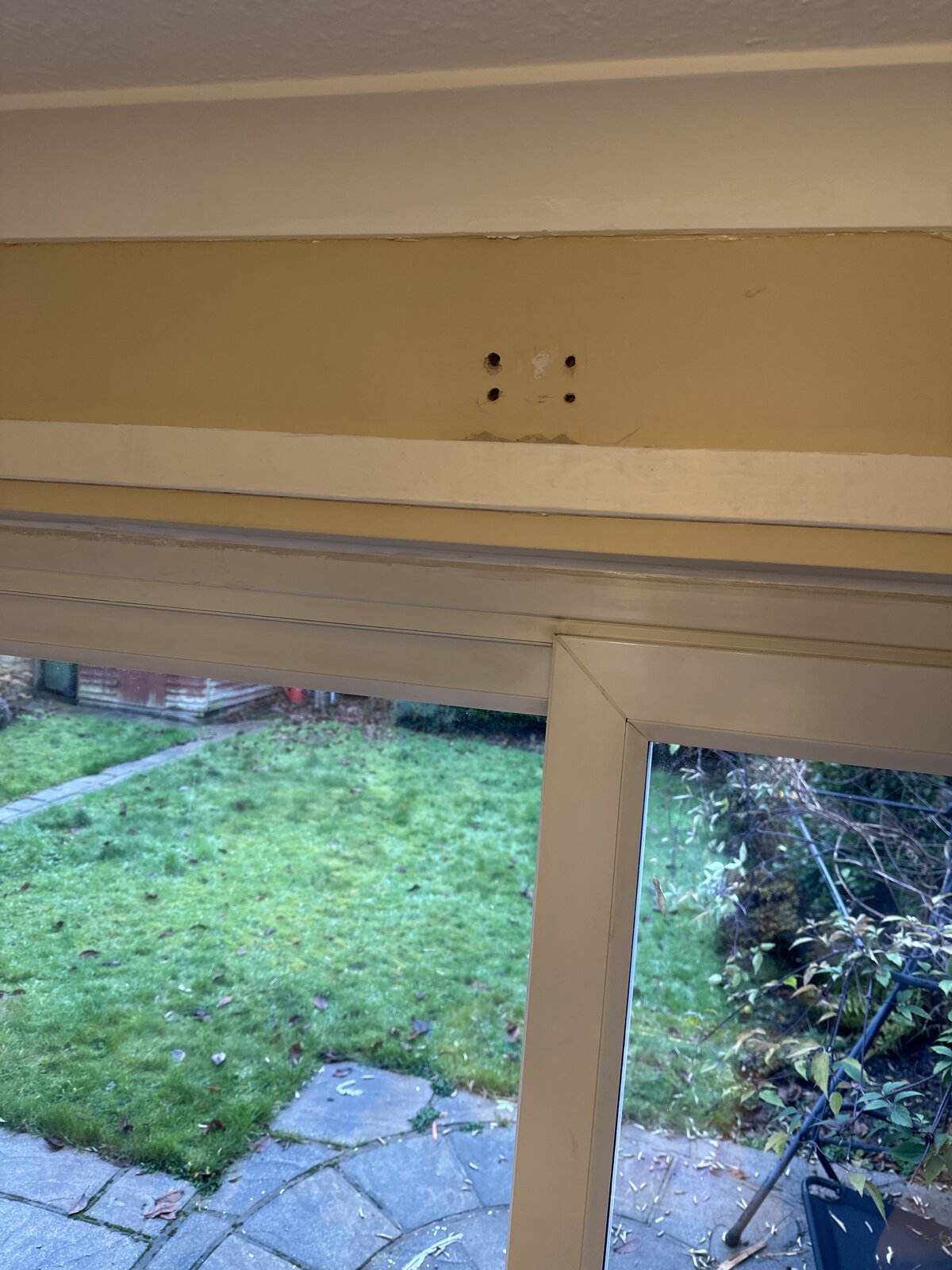

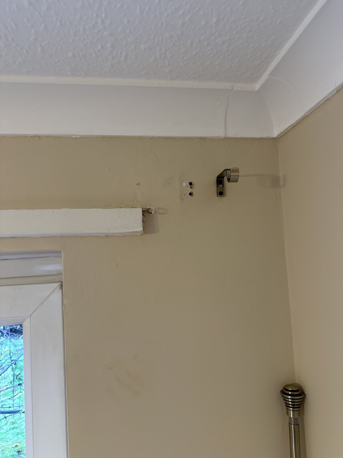

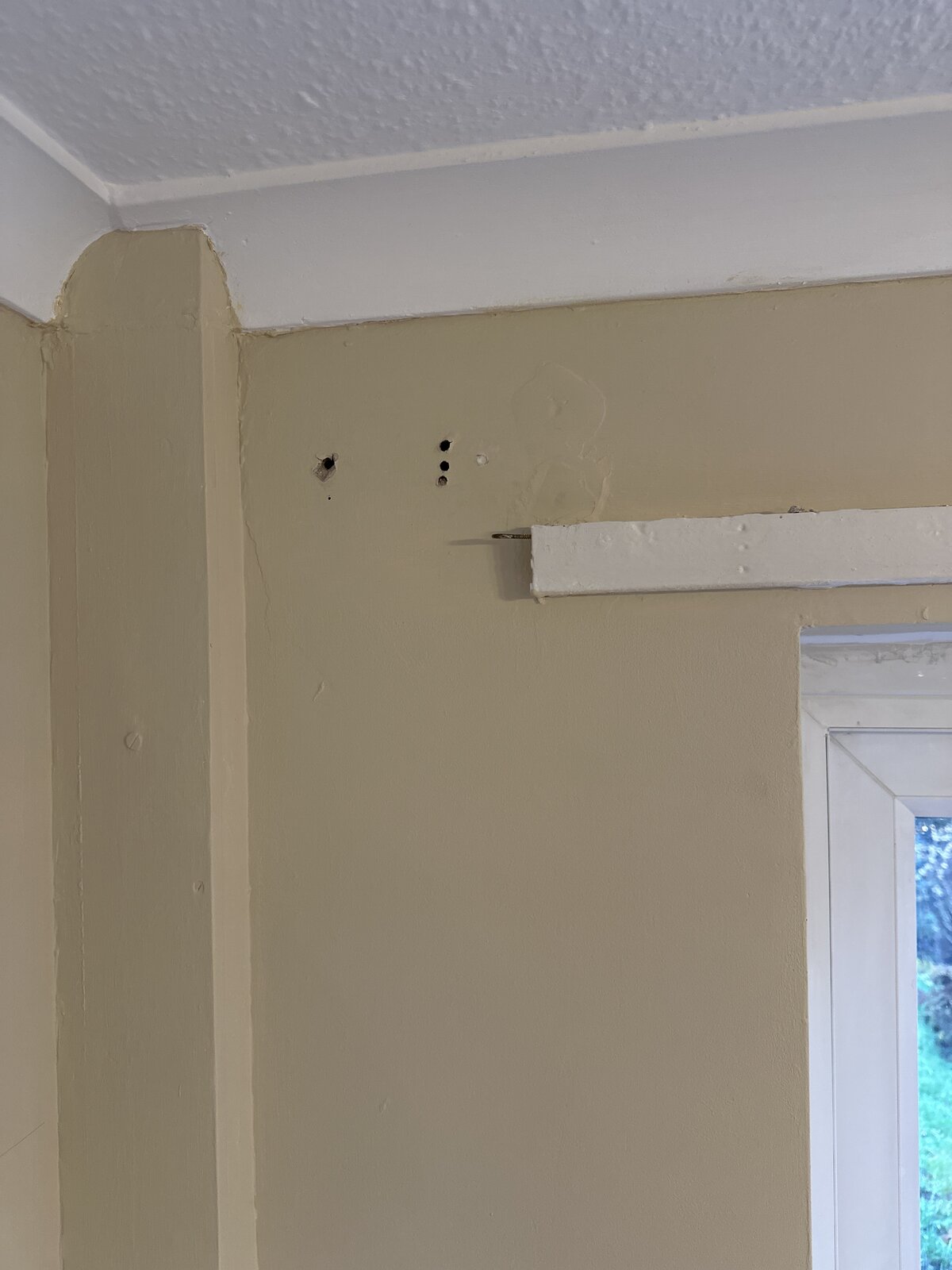

Hi, I’ve been attempting to hang a curtain rail up for nice blackout curtains that are triple layered. However I cannot seem to drill any further than 1-2cm into the wall above sliding patio doors.
Idk whether I need a stronger drill bit, or whether to not drill above as there are radiator pipes runnning along the side of the wall.
What would you recommend to do for this problem?
I thought of adhesive hooks but the curtains will likely be too heavy for them.
I would guess that the radiator pipes are in the boxed section to the left.
If you have a concrete lintel, you will need a SDS drill. You may however have a catnic lintel.
If it is concrete you will probably see it from the outside. If you can only see bricks, it may mean that you have a catnic. The later will require you to use self drill screws
