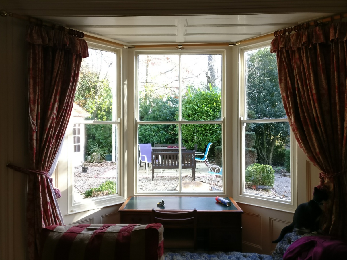

I don't know if there's a proper name for a "pull-cord system" but I assume it's clear what I mean... a rail the curtain hangs from, you have two cords to open/close the curtains :)
My childhood home had these with heavy curtains and my overriding memory is they were always getting stiff or breaking. Are they better these days? My ceilings are 9'6" so drawing back the curtains is a right faff with a regular rail, you end up just drawing back the middle and the top stays closed.
We have a couple of big Victorian bays. The middle being a 2-over-2 sash with a 1-over-1 on each side. Currently they do have a floating curved rail - see photo - but it's a bit wobbly.
Is it feasible I could have nice thick curtains on a curved pull-cord that actually work reliably?
you can get them.
Probably the best is to have them bent by the retailer, rather than a DIY bend.
Presumably they are ok, but weight and bend will affect the drag.
As in, you specify a template and they make them to fit? Are there any good makes to recommend - I no nothing about this!?
I found one online but they wanted to charge I think £60 extra per bend, on top of whatever it costs to begin with. Compared to 5* rated DIY bend products on Amazon for £30 or something.
The cheap ones seem worryingly cheap (but maybe it's simply not that complicated), the high end ones overly expensive. Not knowing about this I'm a bit lost where to start. I guess I could buy a cheap one and have a play, throw it away if it's crap.
TBH I have no idea what curtains even cost!
I have used the cheaper Swish plastic tracks in the past with heavy curtains and they have been ok.
Just remember to spray some silicone into the track to reduce friction.

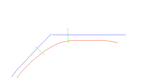

If you find that the curve necessitates the nylon track holding fittings to sit further away from the architrave, I use longer screws and cut small sections of 22m copper pipe to act as packing pieces, it enables me to get a more gentle curve.

Thanks for your reply... I don't suppose you could get a photo possibly (or a crappy diagram)? I'm struggling to visualise what you mean.

Well, you asked for a crappy diagram... Sorry, just having a quick lunch time pint and fired up adobe fireworks.
The green lines are supposed to be fittings that are further away from the architrave than the rest of the track, hence the need to pack them out.

Oh, actually I think that is good enough! I was picturing the pipes being vertical rather than horizontal.
