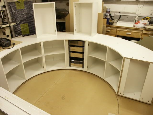

Made the carcases myself here and here they fit a "turret" on the corner of a house, the pics show the hardboard floor template where all the radii were struck from.
Worktops, table top and shelves are Corian. Doors are push to open except the dishwasher, you can just see a discreete handle to the right of the oven
