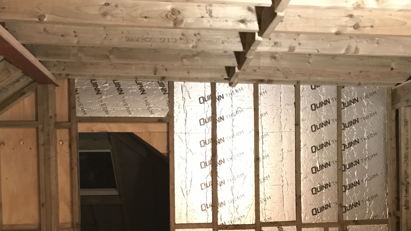

Could I set a table saw to cut a 3x2 diagonally along its length?
Like this:
It's to level the underside of a (not quite) flat roof. Or is there a better way?
Thanks.
This is the roof, I want to level it so that the RSJ is lost into the roof space.
Or if I put a full 3x2 all the way along do you think it would look odd with a slight slope once it's all finished?

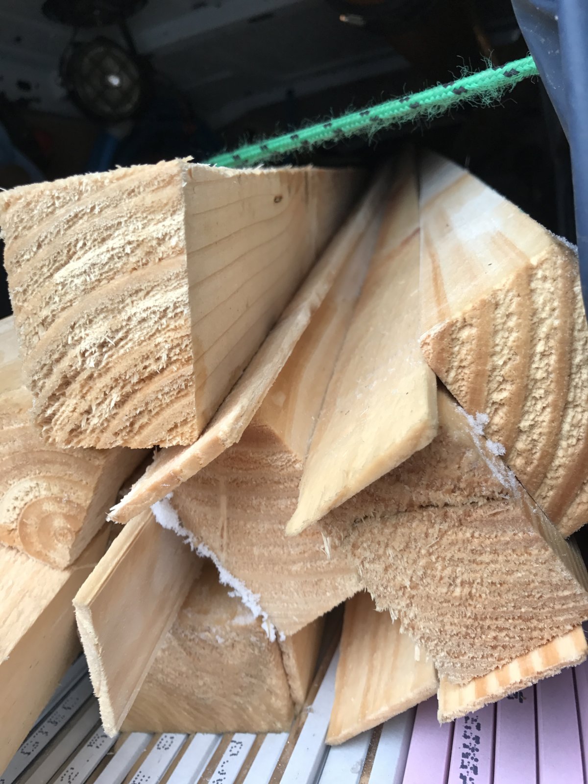

I've just phoned Howarth Timber and they will cut me 3x2 into a firing strip for free, just pay for the wood.
Every days a school day, thanks (y)
as an aside if you use 4x2 you can accurately make say 75mmx900xabout 53mm at the other end then rip the off cut on a strait cut to the correct size as 3x2 will tend to be anywhere between 63 and 76mm

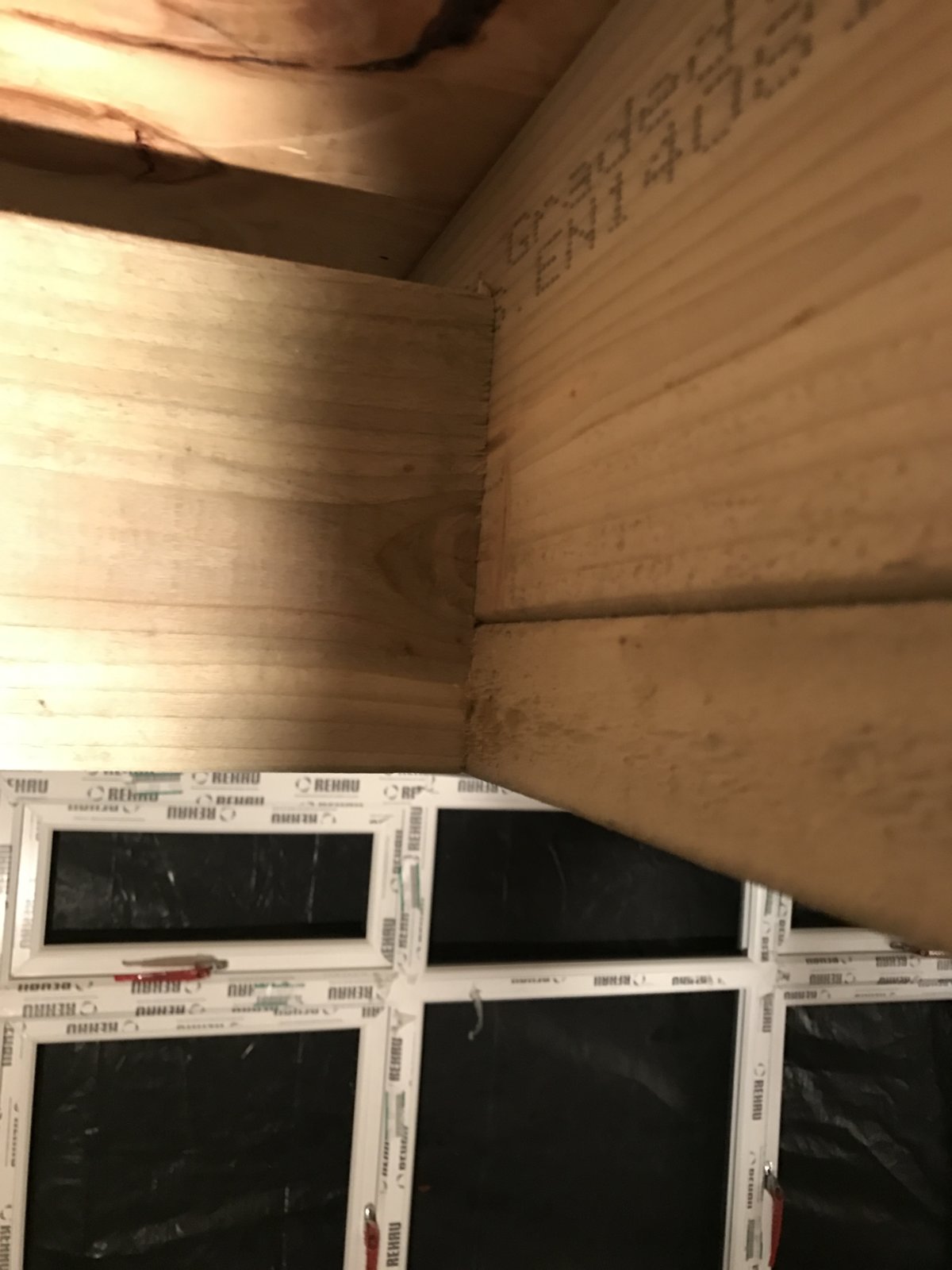

I got the furrings today, notched out a bit for the RSJ, pre drilled some holes then put 105 screws on the wrong side :LOL::LOL:
Idiot!!!!
I tried to cut my own firring strips for my flat roof. Needed 13 of them 5m long. Ripping wood with a circular saw is not a good idea. After the stopping laughing at my first pair - looked like a wave, my circular saw burned out. Went down the wood yard and they cut them for me. Then down screwfix for a new circular saw.
Only time I’ve done these freehand is on my dad’s garage conversion... it was a Sunday and the timber merchants closed... otherwise always get them to do it and just go pick it up... much less agg :D
And glad to see “firing strips” finally became “furring strips” :LOL:
