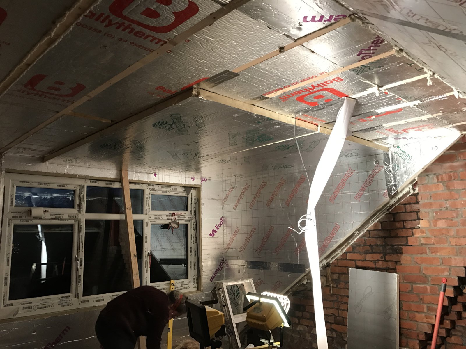

I measured mine along the rafters, some were 5mm +/-, then I put a good sized timber offcut onto them and used that as a guide for the saw. I only had one that didn't hold itself up, I just wedged in an offcut the foamed the edge. Just make sure they stay flush with the undersides of the rafters.
You will soon get the hang of it.
You can see a bit of everything here, foam, tape, rafters...
