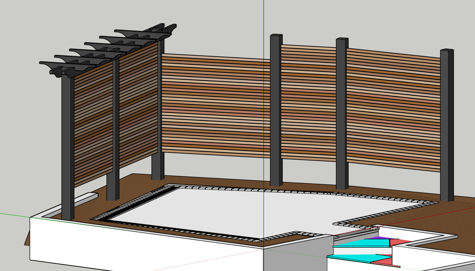

Hi!
I'm having some cedar battens delivered tomorrow and will be starting to make the panels shortly. I have an Evolution 255DB+ compound mitre saw which has worked well for me so far. I currently have multipurpose blade that came with the saw on it. Do you think I should buy a fine wood cutting blade like this? https://shop.evolutionpowertools.com/collections/evolution-blades/products/255mm-fine-wood-blade-60t
Seems fairly pricey. I'm setting up a stop block which should aid the cutting process.
Any guidance/comments welcome.
Many thanks,
E
Making up screens that will hopefully look like this...
Start off with an experimental cut or two, see how it fairs ....

I would get a Freud blade
Dunno why you're looking for Evolution blades or on the Evolution website though, silly prices on there.
No me neither. It was because I was looking at which blade came with the saw. I've seen some much more reasonably priced wood blades now on other sites
If you add a timber fence and timber base it will virtually prevent any break out on the bottom and rear - set the depth stop so the blade doesn’t got right through the base.
Be careful to get a blade with the correct bore.
250mm blades will also be fine.
Western Red Cedar is very soft so just cut through gently
