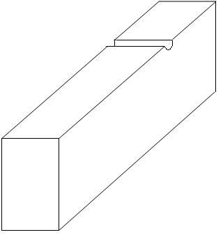

Hi All,
I'm looking for a bit of advice on the best way to go about cutting a groove in some timber, similar to that shown in the sketch below (exact profile is not relevant - its just a path to run cable through). The timber represents the joists in the frame I have built to lay decking boards down onto. I will be running cable (with the appropriate protection) in order to install decking lights. I settled on a groove in the upper edge of the timber, rather than drilling through holes, as it means that replacing the cabling will be much easier as I can just lift it up - no feeding through holes. It also means it will be easier to treat the exposed wood, as I have been doing with the end grains where I have cut the wood.
Obviously a router would be a good option but I dont own one and want to buy one at present. After some searching I have come across these wood rasps made by bosch, has anyone used these before - will they give a cleanish cut quickly - or will I be grinding at the wood for hours? (I will be using them in a mains power drill)
Thanks for the help/advice!
Why not use the traditional method of two saw cuts and pop out the waste with a wood chisel?

That is definitely reasonable method, although I dismissed it initially as I've got 20+ grooves to cut so was looking for a quicker solution. Also a V-cut will have to be much deeper in order to accommodate the cross section of the cabling.
Is's not a v cut, traditional cutting of joists is two vertical saw cuts the required distance apart then use a wood chisel to cut out the waste.

At the moment the frame is built (so under the joists would be a difficulty) but the boards arent down, my idea is that buy laying the wires across the top of the joists its building in as much ease of serviceability as possible (on the off chance I have to repair/modify the wiring).

The saw cuts and chisel does seem the best option I have currently as it sounds like the rasps are pretty ineffective unfortunately. Are there any other options for quick methods that dont need to be particularly neat?

I tried both methods in the end and settled on using the rasps. They work quite quickly, taking a similar time to the saw and chisel method. They gave a very clean surface meaning it was easier to treat the exposed area and it I was also able to blend smooth edges to route the cables over. All in all they are good little tools.
