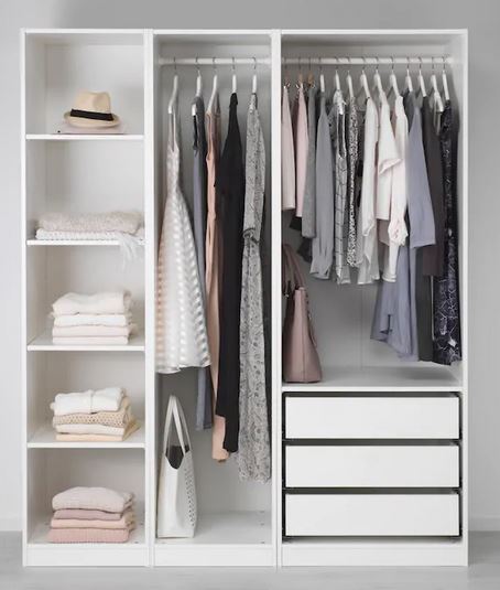

hello we have an ikea pax wardrobe which is too tall for thec
ceiling.
I am thinking it may be worth trying to cut a couple of inches off the doors and carcass.
Is a circular saw the best tool for the job?
many thanks.
I used a circular saw on an IKEA laminate wardrobe that needed a reduction in width, rather than height. A straight edge clamped to the panel will help achieve the desired line of cut.
You will need to reduce the door(s) as well.
You will also have to reduce the back panel which will need more care as it is thinner material, whichever tool you use.

Does it not have a plinth you could reduce in height ?
Not much plinth on a Pax, Foxhole:
I reckon I could cut one down using a circular saw, fine tooth blade and the rip fence (up to about 60mm off) providing it was the flush door, non-sliding door type. I'd make the cuts off the top andn refinish with some iron-on melamine edging tape. For a beginner clamping a straight edge (two G- or F-cramps and something like a length of straight skirting, a 4ft spirit level, etc) might be easier to use than the rip fence of the saw

hi ours has sliding doors. would you tackle this differently?
obviously the doors would need cutting too.
Looks to be more than enough plinth on that .With sliding doors you don’t need any plinth .

If you are able to reduce the sliding door height you will need to work out a way of re attaching the bottom sliding gear. But it might not look right.
