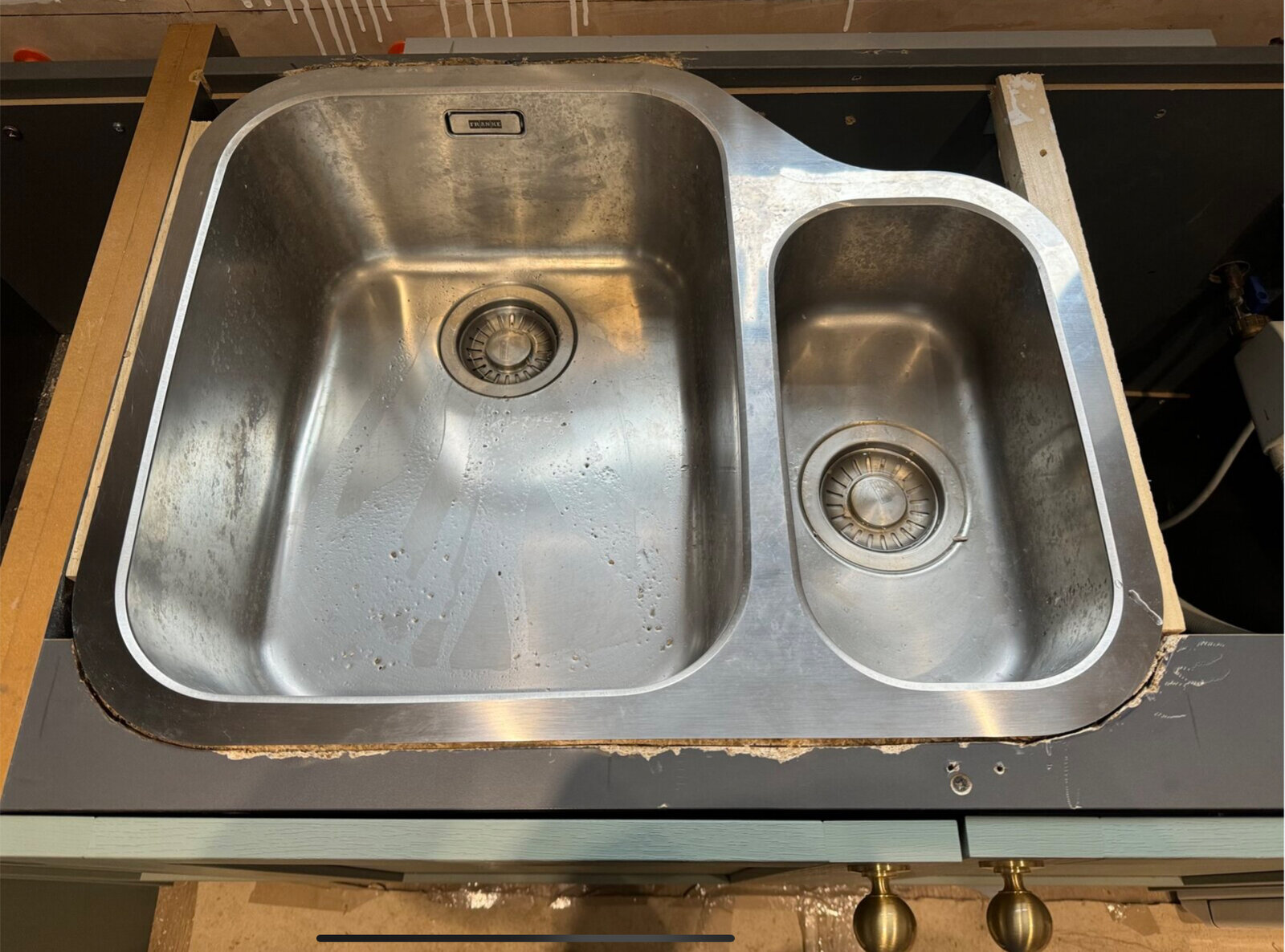

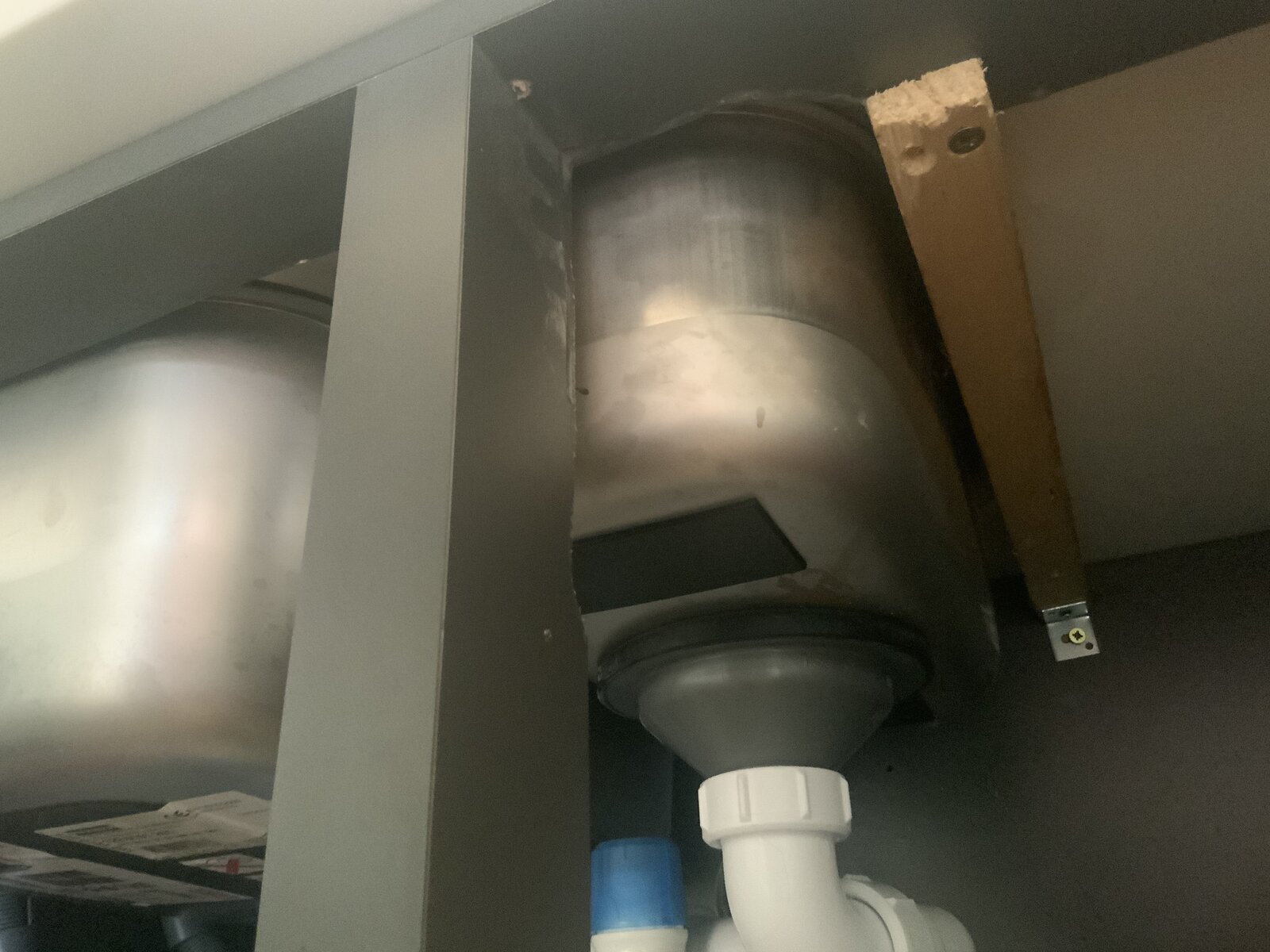

Not Wren and not a corner unit but I had to remove the central rail, some of the back and cut a chunk out of the upright to fit a 1.5 bowl inset sink into my Magnet base unit. I added a small strengthener to hold it together. Had to do some serious butchering to my other base unit to fit my induction hob too. Sometimes you just have to. As long as it holds together and you can’t see it afterwards that’s all you can do.
View attachment 352344View attachment 352345
Thanks for the pics Mottie, looks like that's the kind of thing I'll need to do. Will have a stab this weekend. Wish me luck!
