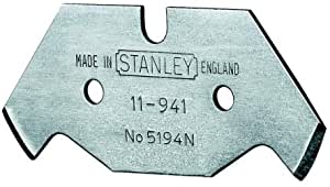

If you want to remove excess material you can just get laminate scoring blades for use with a Stanley knife (ref 5194 or 11-941):
These do need to be used with a steel straight edge and the old basic Stanley 99 or 199 knife - the type without blade retraction is the best bet with them. The alternative would be a carbide laminate scorer, something like a Bon or a Gundlach:

Scoring tools need to be guided are not for freehand use. Laminate requires a fair bit of pressre to score it and is often very skiddy to score
