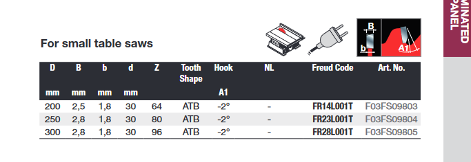

Hello everyone! I have a tricky question and hopefully you will be able to help. I am trying to cut Laminated DSP boards without chipping, i use mitre saw with Freud F03FS09805 300mm x 30mm x T96 Laminated Saw Blade. To make sure i got no chipping at all, i used masking tape on both sides of Dsp where the cut will be. The final results i have is ,I still have small chips on the bottom side of the board. Is there any advice you could give me guys to achieve clean perfect cut without chipping? As i believe i have done everything to my knowledge. I will appreciate any answers.

The OP is also referring to a saw blade (Freud F03FS09805) which is specifically made for use on small table saws as this snip from their catalogue clearly shows:
Freud actually does describe it as a "Laminated Panel Table Saw Blade", so the OP has fitted the wrong type of blade to his saw (he states that he is using a mitre saw). A mitre saw requires a blade with a less aggressive cut than a table saw (i.e. a lower rake angle), maybe something like a Freud F03FS09761 (-5° rake) to ensure minimal chipping?
