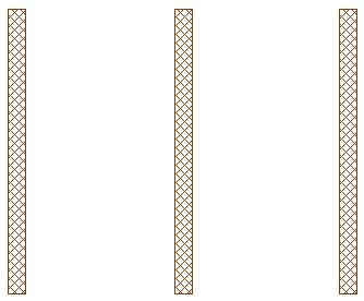

Could I cut 340mm out of the length of 1 joist, the second in from the external wall (parallel to the wall) to make a mini loft hatch opening. It's not near the existing loft hatch and won't use the 'same' joist as the loft hatch.

So rather than like this;
It would look something like this (the big circle represents the shower head;
The cut out would be about 150mm from a side-to-side mahousive timber that all the joists are fixed to, and would actually be in the eaves part so no traffic weight from above. The length from the other end of the cut joist to the edge of the eaves would be about 1200mm.

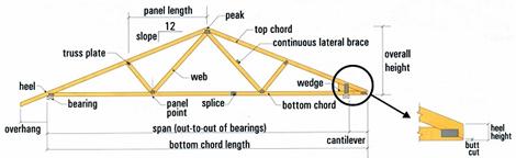

So long as your ceiling joists are not the bottom member of a roof truss I think it is fine to do what you sketched. Personally I always use screws when working on existing attached to plasterboard as risk of damage to plasterboard (or lath and plaster) is reduced.

He means you can not simply cut it if the roof is made of trusses rather than a cut roof with purlins and rafters.
Your sketch kind of looks like it could be both confusingly??
If your house is more than 30 years old its probably a cut roof but if your unsure post some photo's for confirmation.
A cut roof will have large purlins which would be big timbers like 8''x3'' mid way up the rafters. A truss roof will not

From your replies you don't have roof trusses so you are good to go.
Most modern housing use a truss for the roof and the bottom chord is used like a ceiling joist. You would not just cut through it. So in case you had them I had to mention it.
