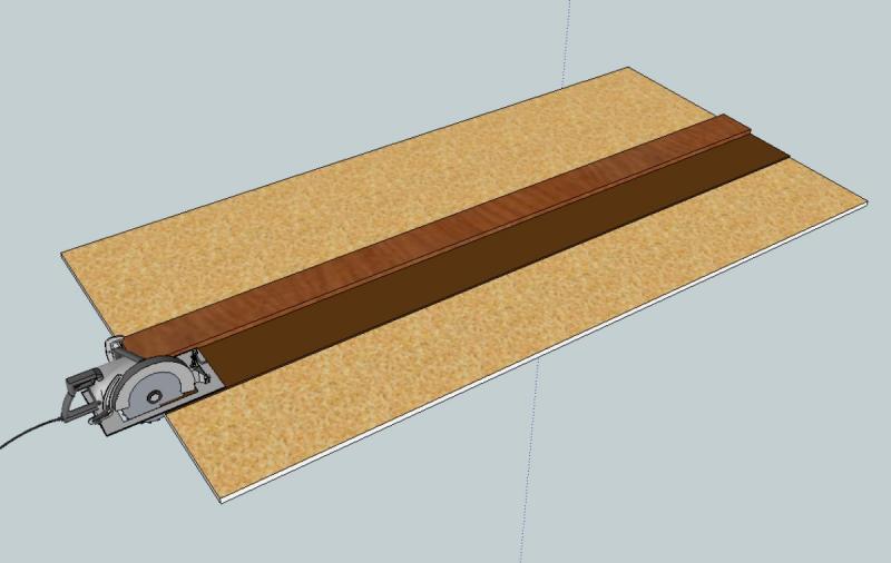

The issue is size, i.e. width and thickness. For relatively small boards, say 8 x 2in (200 x 50) or 12 x 1in (300 x 25) a sliding mitre saw would probably be best. For wider stuff, say 600 x 18mm or full sheets (2440 x 1220mm) of MDF board you'd need to think in terms of a portable circular saw, a reasonably fine blade and a (home made) saw guide:
Above: Home-made saw guide being used to make a straight cut. Could also be used to make cross cuts, angle cuts, etc

How would you go about making the saw guide?
So a portable circular saw can do pretty much most angles?
James
Piece of 6mm hardwood plywood, approximately 150 to 200mm wide x the maximum length you intend to cut + 300mm. The width needs to be the width of your saw base + 44mm (width of the fence/batten) + 15mm. One edge must be sawn dead straight by a timber yard (or be the edge of a mill board - i.e. as it came from the plywood mill as they always have straight edges). You'll need a piece of 2 x 1in planed softwood (probably 44 x 22 finished size) same length as the ply. Combi square set to 10mm. Mark 10mm inset down the straight edge of the plywood with a pencil and the combi square. Screw through the plywood every 150mm or so into the softwood checking as you go that the edge of the softwood is on the line. Make your first saw cut with the edge of the saw running against the softwood batten - this trims any excess off the saw guide. The trimmed edge can then be set against your setting out marks on workpieces to make cuts. That extra 10mm at the back means that if/when the edge gets work the softwood batten can be moved 5mm, refixed and a new good edge trimmed. This can be done 2 or 3 times before you need to replace the plywood )so probably a few hundred cuts with care). You will also beed to have some form of sacrificial table for the cutting (e.g. old door on trestles, open table made up from 2 x2 CLS on trestles, etc)

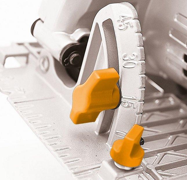

It had 45 degree bevel cut capacity which is fine however when looking at the product video it shows the angles from 0, 15, 30 and 45. Which again is fine however as I am wanting to do a 22.5 degree cut how would I do this? Is there something I am missing or do I need to get something additional?

If you take a look at the bevel gauge:
As you say it has angle settings at 0 - 15 - 30 - 45°, but it also has intermediate marks every 5 degrees (so between 30° and 45° the two marks would represenr 35° and 40° respectively). So for 22.5° you'd need to set the pointer half way between the 20° and 25° marks and tyhen make a couple of test cuts before checking the angle (and possibly adjusting it). It might help to have a decent sized protractor and a sliding bevel to help do this. Onve you have the right angle you'll need to make all the bevel cuts in one session so that you don't lose the setting. For final assembly you might need to make adjustmentrs with a sharp plane to get the fit just so

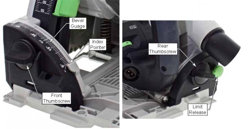

Using the protractor and a sliding bevel will get you nearer than the scale, but you'll still have to adjust it manually to get anywhere near the fit you require. It's normal to make-up octagonal boxes in halves then to have to make slight adjustments with a hand plane to get the final fit. My own site portable saw is a £400 Festool which has a bevel gauge calibrated in 1 degree steps and has a front and rear quadrant (more accurate) with front and rear angle locking (see below):
and even there I have to adjust things after making a couple of test cuts, however it's a lot more accurate out of the box (a feature you always pay dearly for). The only machine I know which is going to be truly accurate is a medium to heavy-duty tilt arbor table saw - but one of those would cost you well over £1000 secondhand and will require careful setting-up to give you repeatable results straight off the scale. What you require all depends on the size of the items you are making, the level of accuracy you are after and what you are prepared to pay. That's why I asked about the scale of the items you are cutting at the beginning of this thread. If your items have a height of 200mm or less you'd get far better accuracy from a sliding compound mitre saw, although I do think you'd need to look into light trade saws (e.g. 216mm blade) to get repeatability - and that puts you into about £300 or more outlay. If your bevel cuts are 500mm the question has to be haow much are you prepared to pay?
