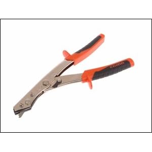

I just wanted to find out what tools you can use to cut small shapes and holes into metal with. I'm not sure what type of metal it is I want to cut but I want to be able to cut precise shapes into a small piece of metal. I don't want anything that's going to cost me the house, just something that will do the job. If there isn't anything cheap, are there any methods? I tried searching the internet but didn't find anything that I was familiar with. Thanks

Edma Monodex Nibbler Shears might do it, if its thin

Sorry for not being very specific, I can't actually be too specific because I'm sort of exploring and trying out a few things. It is probably steel what I want to cut, I'm not positive, but it is around 1mm thick, It looks like it anyway. I'm not using the shapes for anything, I'm planning to just make shapes in the metal just for an interlocking mechanism, the holes/shapes in the metal have to be pretty small and have to be pretty accurate, I wasn't sure if there was cheap enough equipment with that description. It's a small project I'm working on and so is the object I'm working on which however strange It may seem, is a stapler. It's no point asking me what I want to do with it because I haven't the slightest clue apart from wanting to be able to lock 2 pieces of small metal together... Hope this helps, thanks
Sounds like a job for a selection of drill bits, a piercing saw and some needle files.
