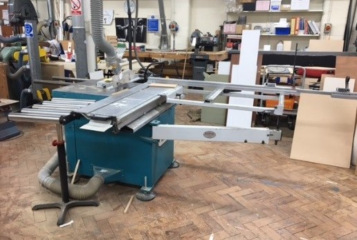

none of that seems to address using mitre fences, and with your 16" rule I take it you would rule out such basic operations. Do you also rule out sleds?
Yes. Mitre fences on table saws are often woefully inadequate, even on most medium to heavy duty stuff like Wadkins or Startrites - a radial arm saw (many of which which can take a dado set) or a sliding compound mitre saw (many of which permit trench cutting) are both more accurate, safer and easier to use than a table saw with either a mitre fence or a sled (consider trying to cut a bevel or mitre on the end of an 12ft length of skirting as an illustration of this point) - and take a lot less space as well. In terms of sheet materials like plywood even a DIY plunge saw will run rings around most table saws in speed of use safety and again take less space. The only table saw which will be more accurate is the larger sliding carraige type saw used for sizing sheet materials but even hslf size saws like the Wadkin SP130 (see below) have a large footprint
IMHO for most purposes, therefore, there are better alternatives to the sled or mitre fence on a table saw. I feel this (almost) obsession with table saws as a primary need comes from the USA where it is driven by amateur woodworkers and salesmen. In reality a joiner would probably buy machines in something like the following order when setting up a shop:

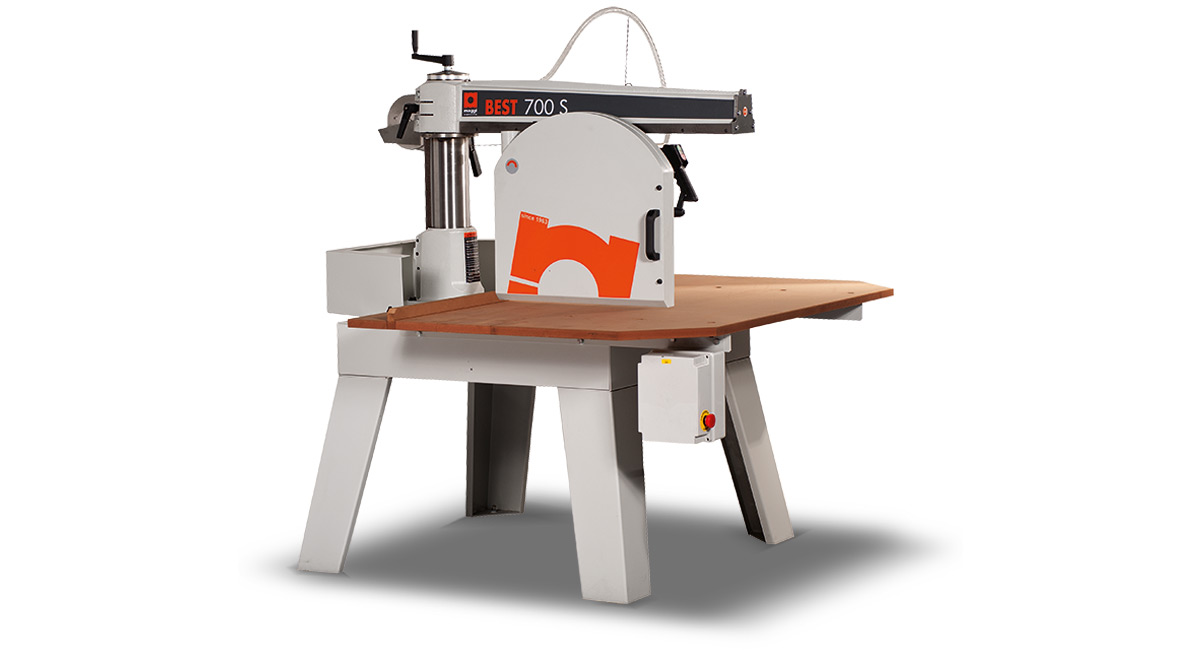

My Dad used to have a RAS and too be honest it scared the crap out of me! Way too much exposed spinning blade imo!
In that case the guard on the saw was old/non-compliant. DW radial arm saws as long ago as the late 1970s came with guards which covered the blade sufficiently - so did Wadkin machines. The current guarding regs came into force for us in 1992(?) which makes me wonder how old your dad's machine is. Even so, there are some significant differences between a dado head on a RAS and on a table saw - for starters on a RAS the work is automatically pulled towards the rear fence by the direction of cut of the saw (same as on a sliding compound mitre saw), secondly most users would have their right hand firm on the saw's handle, well away from the blade, thirdly the left hand should be positioned well to the left of the blade (and if the blade guide is set up correctly with a modern guard it is physically impossible to have contact between hand and blade) and finally when using a RAS to make a crosscut it is all but impossible to become unbalanced when making a cut, unlike on a table saw. This is what a modern, compliant RAS looks like, as delivered (note the size of the guard):
Even with a 3/4'' wide dado in a table saw you're really not seeing a lot of the blade as it'll barely be poking out the table top. With a RAS its just always all there to see regardless of how wide it is,
Your estimation of correct use of a radial arm saw obviously comes from seeing your dad using one incorrectly and with illegal/incomplete guards (based on your previous comments). And as I said, propery set up the blades should not be visible on a table saw if the saw is properly configured, This is what the guard set up should look like for even a basic RAS:
Note the nose piece. The side guards are sprung and slide along the top of the material, the nose piece at the front is adjusted to within about 2 or 3mm of the surface of the material so you aren't going to get your fingers beneath that. Even my old dewalt DW125 from 40 years ago had a similar arrangement. And just to show that even old saws can be adapted to the current standards, here is an old Wadkin BRA14 with guards which meet the current standards:
