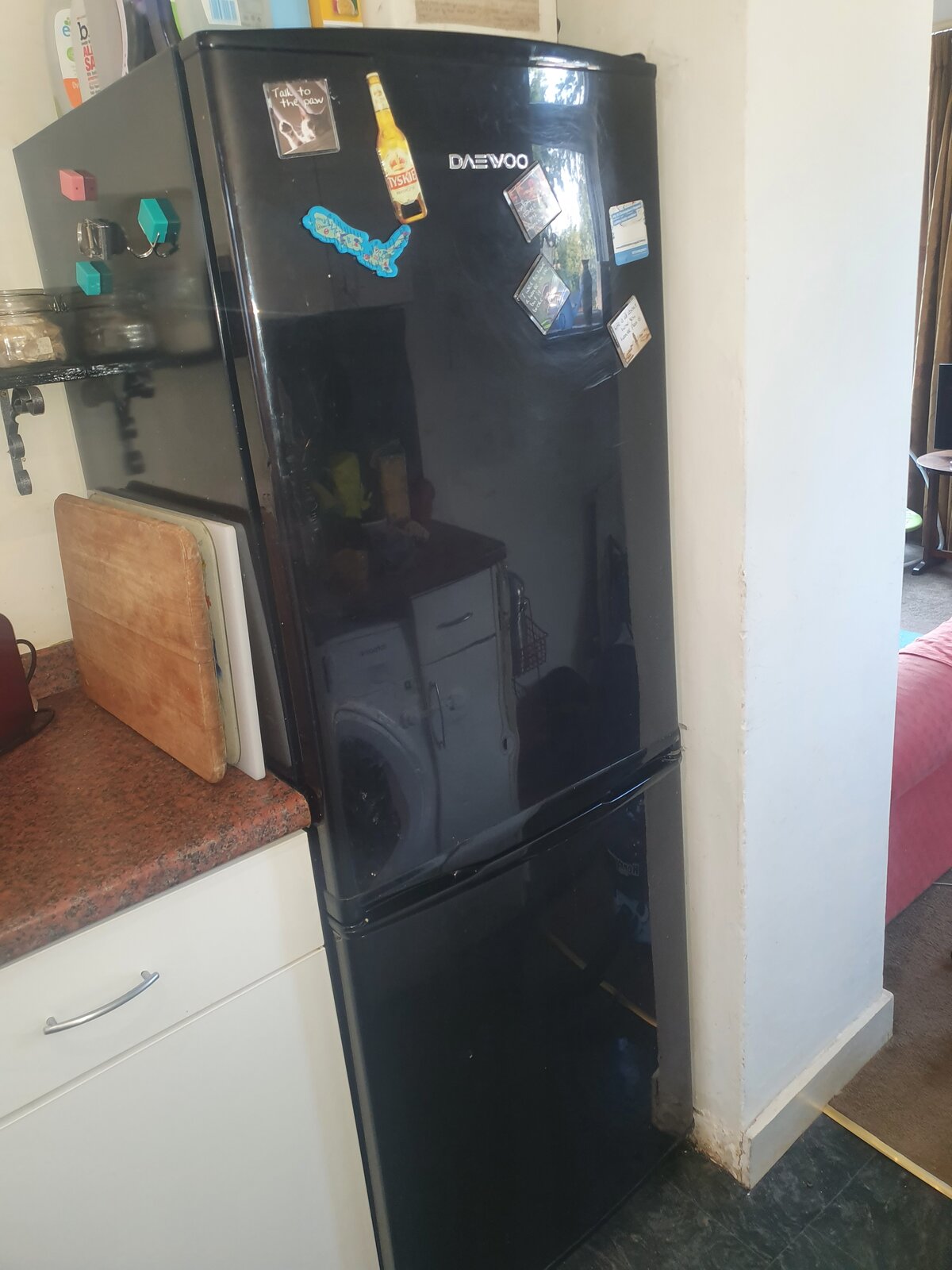

Our DAEWOO ERF-337MB Fridge Freezer is leaking a pool of water every day or few days. Collects on the floor right hand corner of the fridge. Obviously escaping through the freezer door.

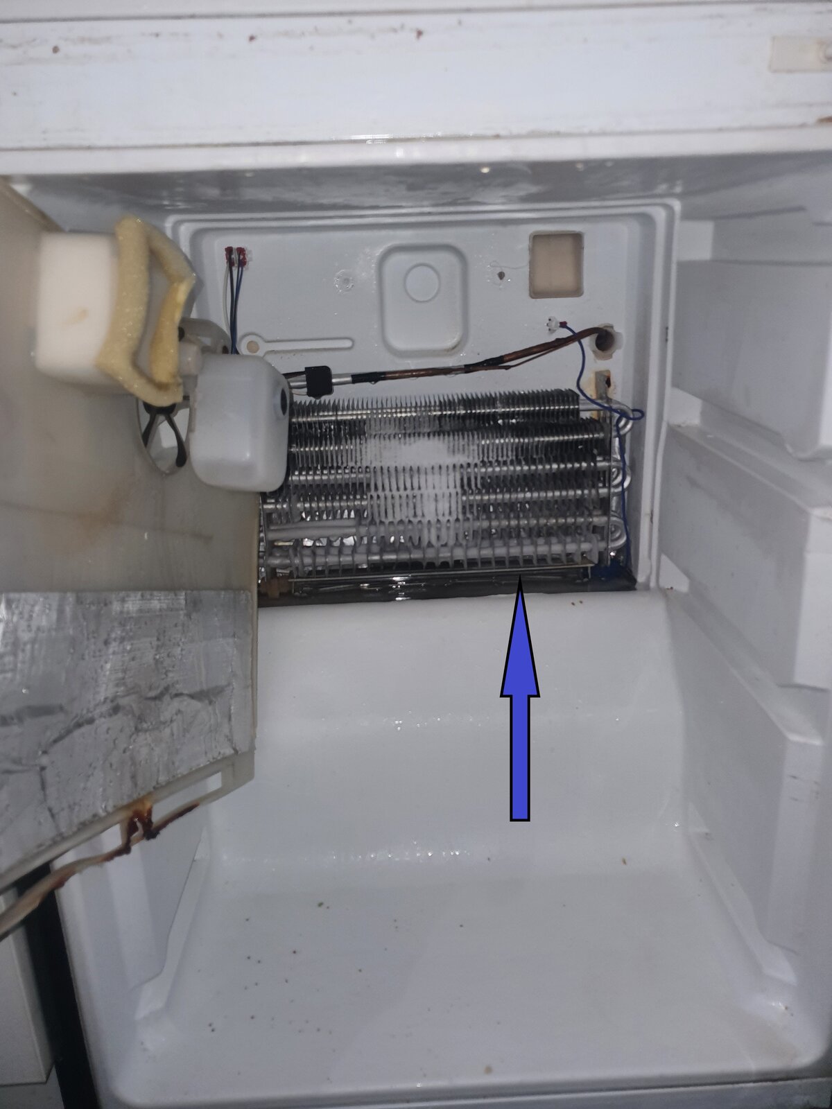

The condensate tray at the back is bone dry, and what seems to be the outlet pipe had a bit of material clogged in it which I removed but not sure if that solved it.

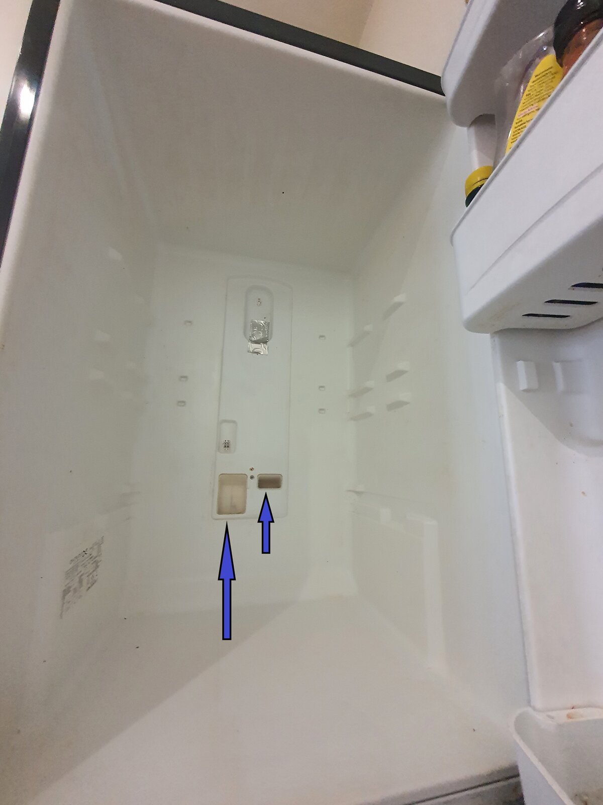

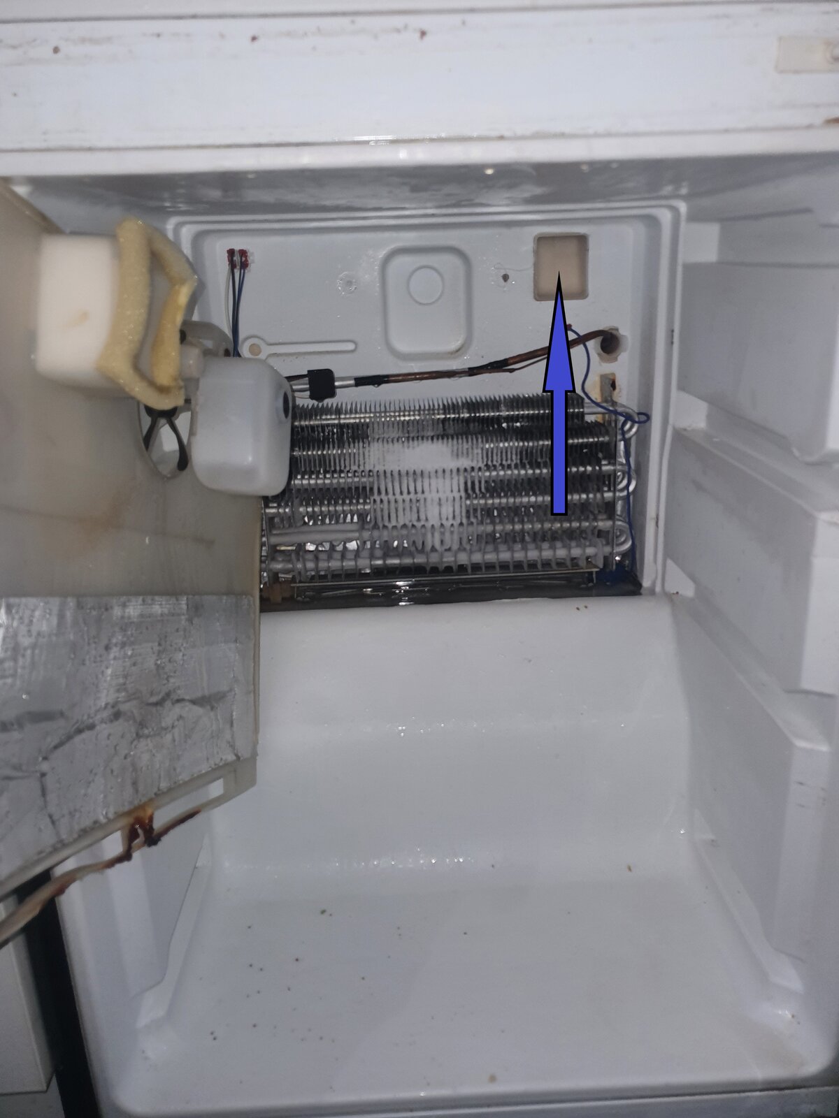

I removed the panel covering the lightbulb, and as shown in image 2, there are two holes. The hole to the right goes straight down to the freezer below and exits through the hole top right in image 3.
The one on the left also seems to connect to the freezer as i see the water coming out underneath the radiator, as shown in image 4
So if those holes are indeed the drain, and it's blocked, I guess water could be backing up, and then going out through the freezer, otherwise I have no idea where the drain is.
I tried rodding the left hole, but it's a huge channel (the width of the opening), not a pipe, and didn't seem to have any effect
