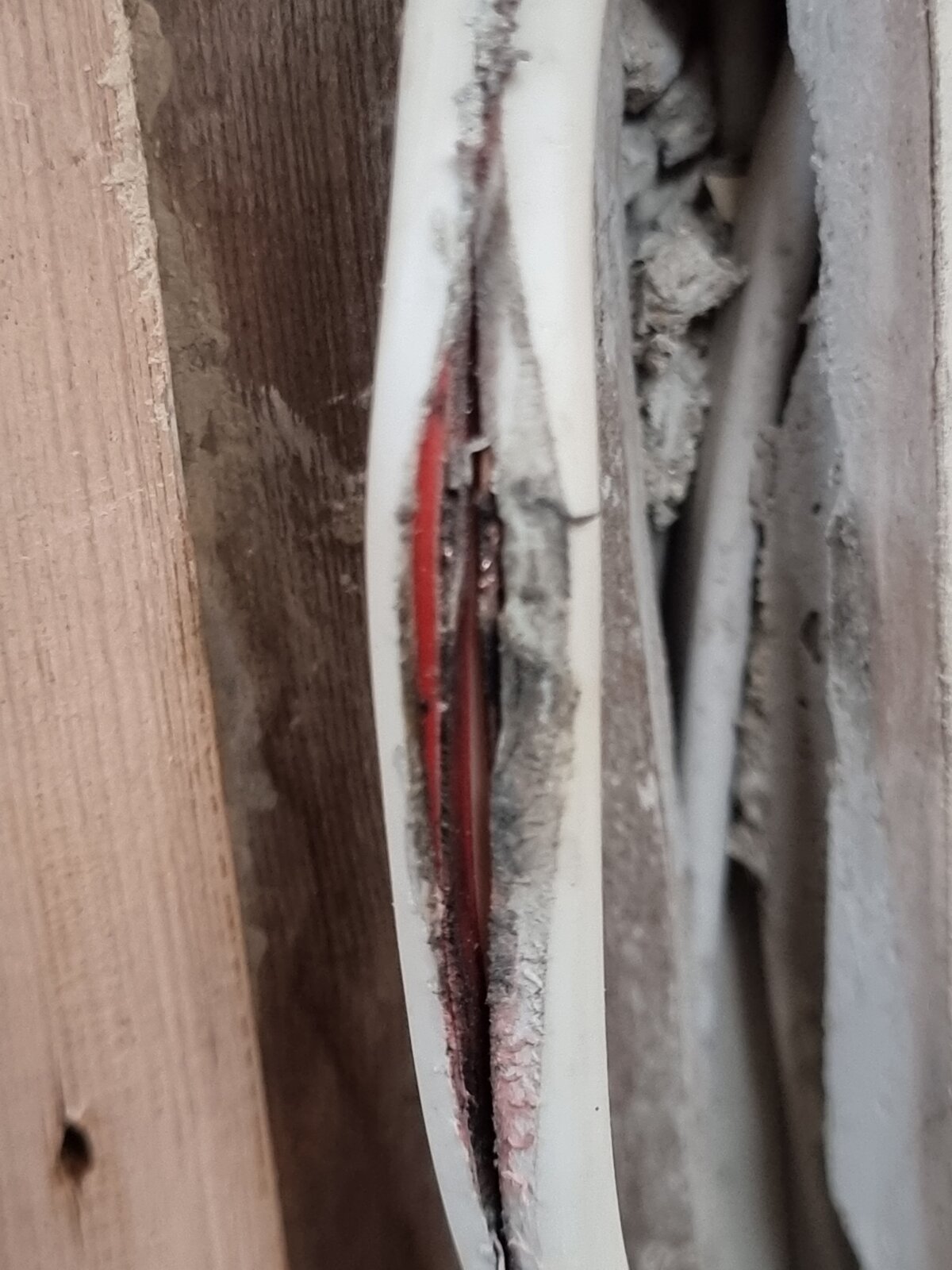

So I managed to pull the wire out a bit, it has enough flex. Please see photo attached.
You can see the red wires sheathing has split slightly and there is a slight graze to the copper earth, which you can see shining through in the pic.
The cable looks whole so I didn't want to do a cut and join but don't know if it's safe to do a good old electric tape job.

No.
That requires a professional electrician to repair.
You can't fix this yourself.

It's damaged far too much to think about just wrapping tape around it.
It LOOKS like it's tucked in the gap between the door frame and wall, where the architrave would go?
Correct?
If so, it's very wrong to have it there - one reason being prone to damage from screws from hinges, and latches and all that stuff.
As there is a gap, you do have room to do a repair.
You could use crimps and heat shrink.
You will also need a short length of the same type of cable, as you will have to cut out the damaged section.
You need a decent crimping tool, not those cheap auto crimping tools.
Of course, all this would have to be classed as temporary repair as those cables are in a dangerous place, and need replacing and re-routing somewhere safe.

The damage in the photo is NOT 'a small cut'.
It's been sliced open over a significant length, the inner insulation has been damaged, at least one of the copper conductors has been damaged, and there is arc damage as evidenced by the blackened mess on the inner insulation and outer sheath.
The fact that something tripped means at least 2 of the wires made contact.
The absolute best case is several inches of that cable being removed, and a new section being spliced in.
More likely is removing and replacing a much longer section, or disconnecting that cable entirely and installing a new supply to the shower pump from elsewhere.

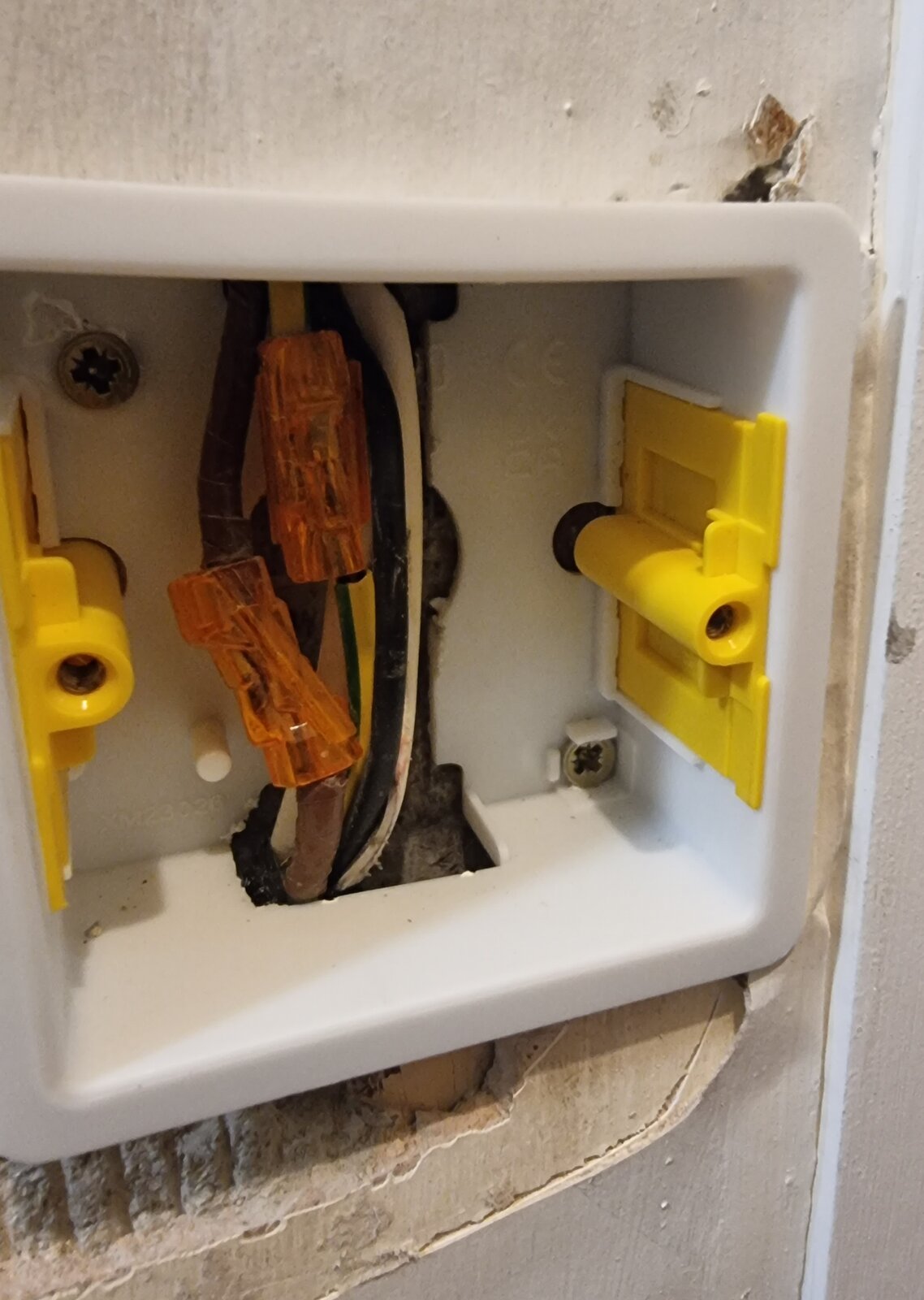

Thanks for the replies. So after a nightmare of trying to find a leccy who will actually do it (5 in total declined as they are so busy) I managed to find someone who said rewiring is not necessary.
He basically put an accessible flush box with a blanking plate on top and joined the wires. Whilst he was in his van I took a picture of the cables and he has joined it with some orange connectors. I did ask him about these and he said they are as good as crimping and it's in a accessible box now so it is fine. Is this a acceptable repair?
Looks good to me. I assume that a blanking plate will go on top?
That is a good thing as it will alert future trades people of the presence of cables!
