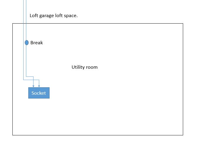

Hi.
My 3in1 detector failed to warm me about a ring main cable in the wall. When I put the screw in the raw plug the point of the screw pierced the cable and tripped the RCD.
The cable runs up the wall and into the loft space which I have access too. So running a new cable from the socket and joining it in the loft space is not too much of an issue.
What is an acceptable method of joining the cable? My house was built in 2000 in red and black and is currently up to the regs of that era, so I dont want to bodge it and void that status. Plus I want it safe. I understand that a ring main has a breaker of 32amp based on the ring using two cables. But any single point of the ring main must support 20 amps. So the joining method must be rated for 20amps or above. Is this correct?
Secondly. Am I allowed to do this or is it a job for a sparky? I'm a pretty confident DIY person.

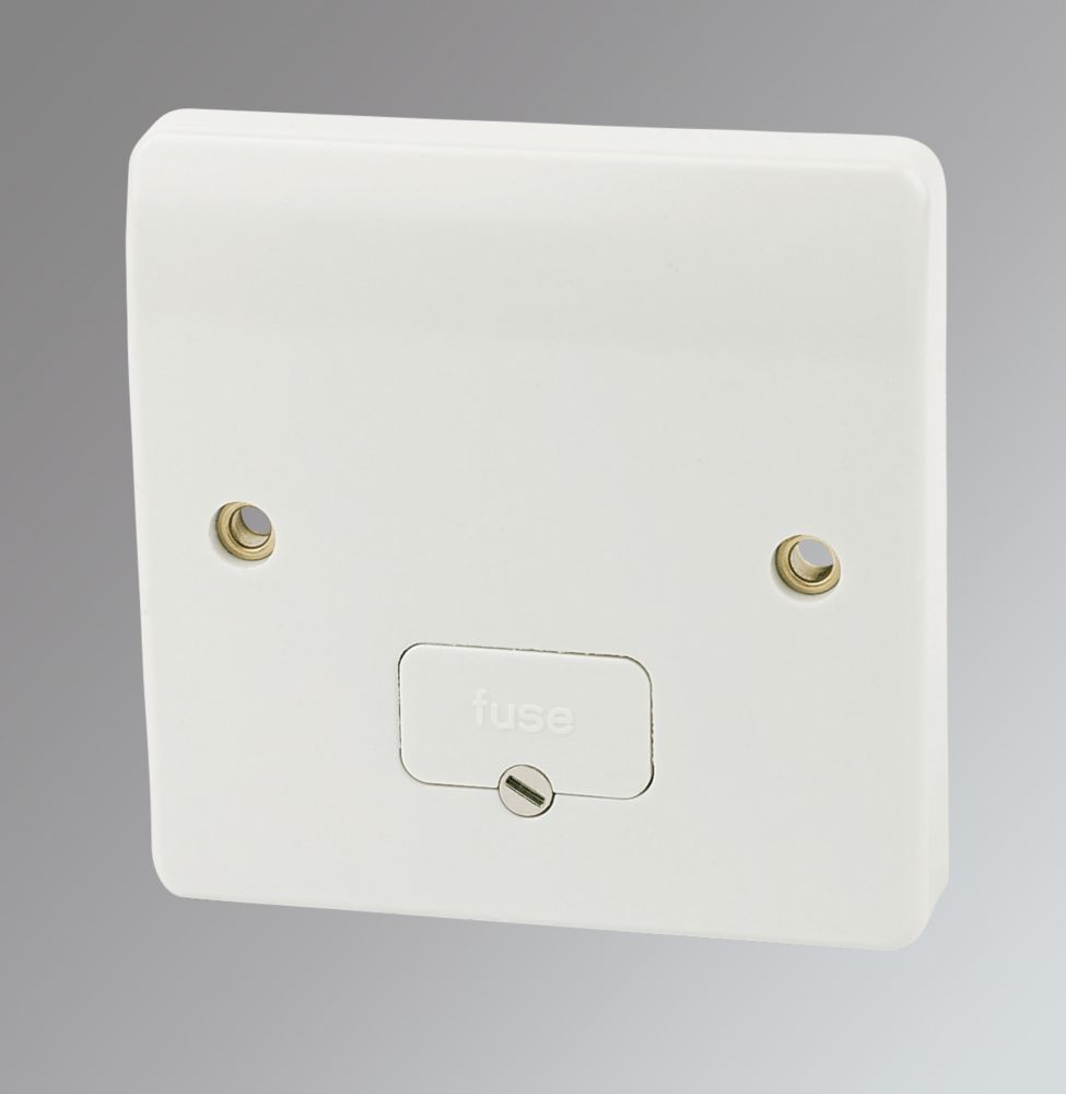

1) Are you sure it is a ring? you can get both fused and unfused spurs from a ring, and it is not normal to run the ring through the loft.
2) Methods of repair already covered so I will not repeat.
3) Testing for a ring can be done from any socket which is part of the ring, you do not "Need" to go into the consumer unit (CU).
4) Using a proper earth loop impedance tester a good electrician can actually have a good idea if the ring is intact assuming the test results are available. If a ring has already been tested and we know the earth loop is say 1.15Ω and neutral loop is 0.93Ω for example from the central socket of the ring which would need to be identified, then we could repeat the test on the same socket and we would know if the ring was intact as there would be a wildly different reading if broken. However the normal test for a ring involves moving wires for the test, to get the loop reading, so in practice you just will not have the data to be able to do a live test. So it needs the experience of the electrician who can look at the house and say what would be the likely reading if the system is good. Although the electrician may be able to be 95% sure it is OK or not, he would likely not want to take the 5% chance of being wrong, so he would test dead. One of the places I worked we had designated test sockets for the ring, and we would test the loop impedance and prospective short circuit current every two months so we would know if there was damage. But this is unusual.
But we must start at number 1) are you sure it is a ring? What does it feed in the loft? if it only feeds one socket, how many cables go into the socket, and also is there any fused connection unit

I'm very confident it is a ring main cable. There are two cables running down the wall to the socket below (slightly to right of the two wires, which is the reason I believed the tester I used) which has two wires connected to it. I've attached a diagram. I've removed some plaster to accesses the damage, the reason I know there is two wires. To to be honest, it looks like the screw head has only nicked the insulation and shorted two wires together but still, damage is damage.
